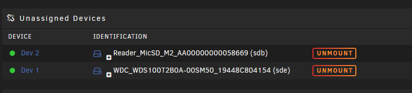

Install the Unassigned Devices plugin.  This will see devices attached to the server that are not in the array as and unassigned device,  NTFS is supported by Unassigned Devices.
See the above linked thread for a description of Unassigned Devices and its uses.
I have two external USB NTFS drives that I attach to the server from time to time to make backups.  You could also just put them in the server as SATA drives not assigned to the array and they will be seen as Unassigned Devices.  Dev 1 in my screenshot below is a 1TB SSD that I am using as an unassigned device.
OK guys moving forward slowly - found the "unassigned devices" plug-in and now I can see the drives in ntfs form and can mount and see the files.
