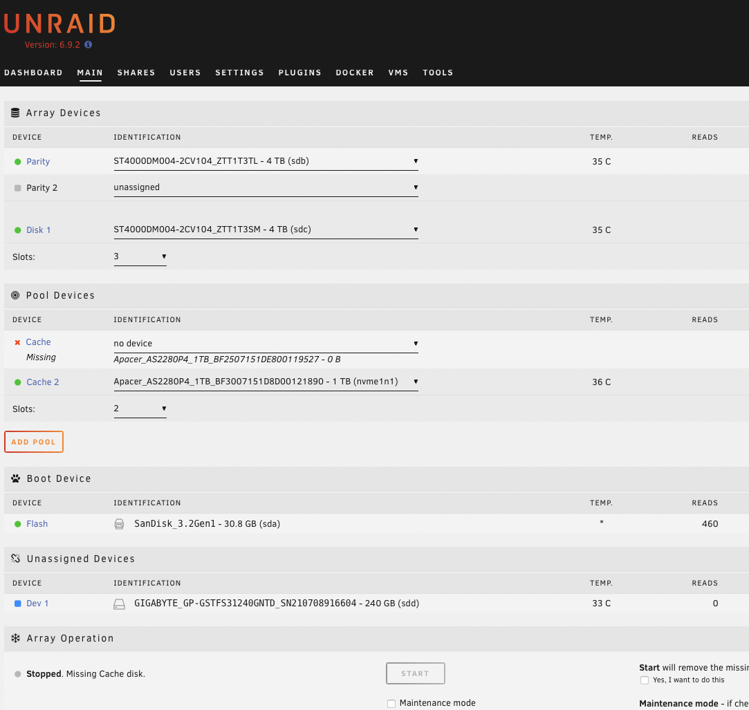

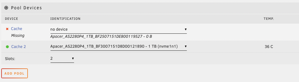

The problem that I currently have, is that one of the NVMe drives is suddenly missing from the cache 🤯
After a reboot I see both drives there again, few minutes later, again missing.

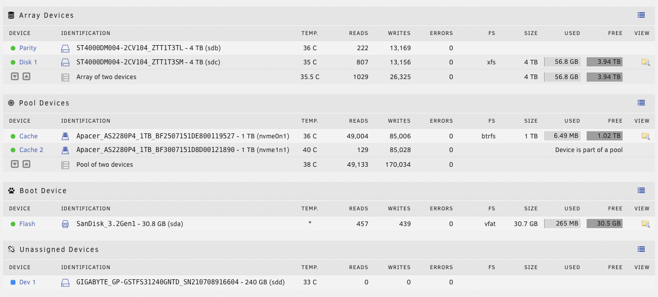

Overview of Main tab:

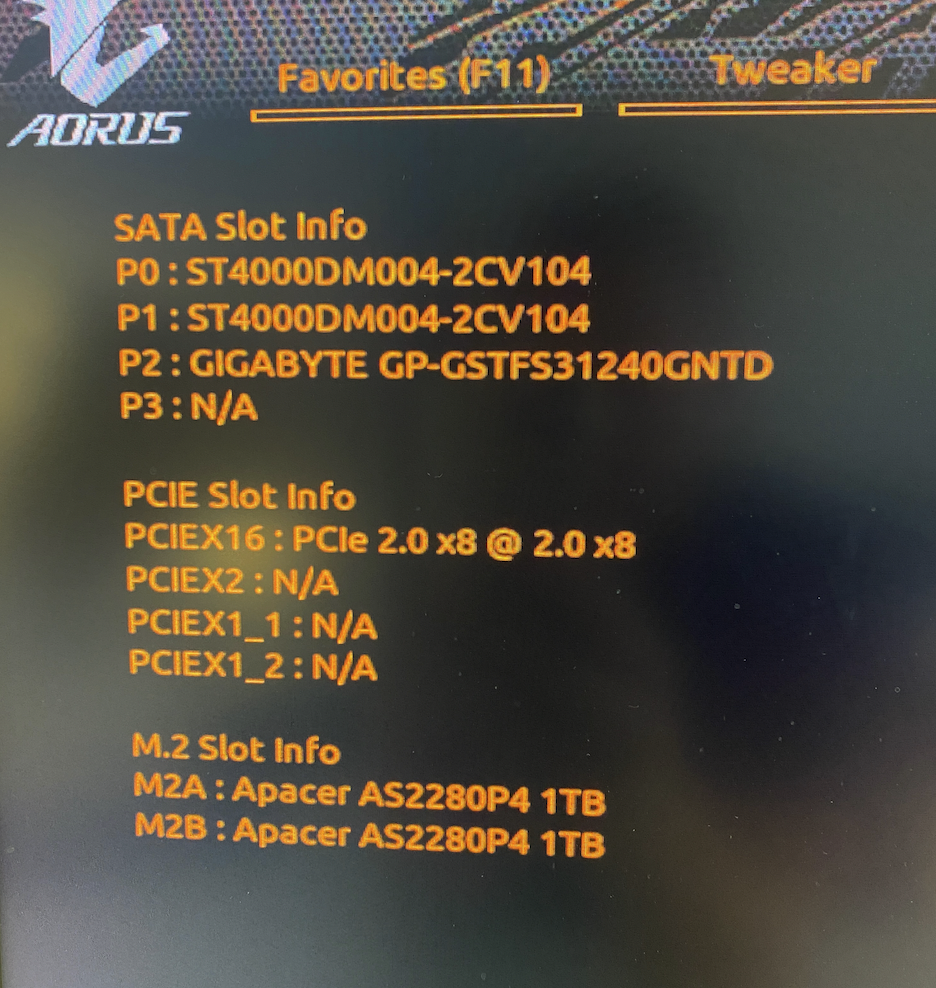

BIOS detected both drives:
