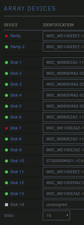

I got a an unraid server with 13 disks and 2 parity drives ranging from 8-14TB. A few days ago I couln't open a few files so I checked the web interface and to my horror unraid reported two disks with errors. One data disk and the first parity drive. I shut down the server and now I want to start the trouble shooting and need your help.
Before I shut it down I saw that both drives had an error count of about 2K. I don't suspect a drive failure since both drives failed at the same time. You can't see it but these mails came all in the same minute:

 * Disk 7 is connected to the H310 on the A Port along with three other drives. The B port doesn't have any drives. A SMART short self test completed without errors. Here are the downloaded SMART results: Disk 7 SMART.txt
 * Parity 1 is connected to the H200 on the A Port along with two other drives. The B port also has three drives connected. A SMART short self test completed without errors. Here are the downloaded SMART results: Parity 1 SMART.txt
This should never happen, you should have system notifications enable to be notified immediately when there's a problem, or it might be too late.
Next time before doing this grab the diags or the syslog will be lost after powering back on.
Start the array, grab the diagnostics and post the here.
Hopefully there is no next time time ;) but I will be wiser than.
I grabbed the syslog in maintainance mode, I hope thats okay.
Edited by Henning
It's not, and please post the complete diags: Tools -> Diagnostics
