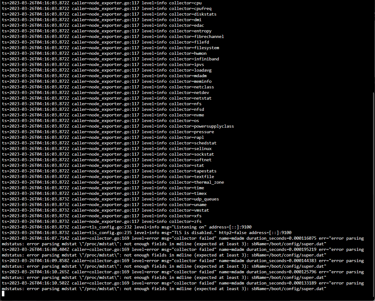

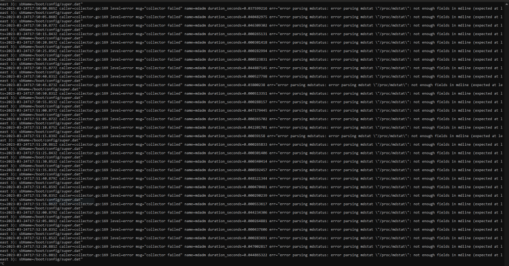

Bug report. Prometheus Node Exporter throws an error every single time it's polled by Prometheus.
EDIT: As of version 2023.02.26 -- first time using this plugin, unsure when bug first appeared
Text is;
ts=2023-03-24T17:51:45.859Z caller=collector.go:169 level=error msg="collector failed" name=mdadm duration_seconds=0.000470481 err="error parsing mdstatus: error parsing mdstat \"/proc/mdstat\": not enough fields in mdline (expected at least 3): sbName=/boot/config/super.dat"
Edited by codefaux

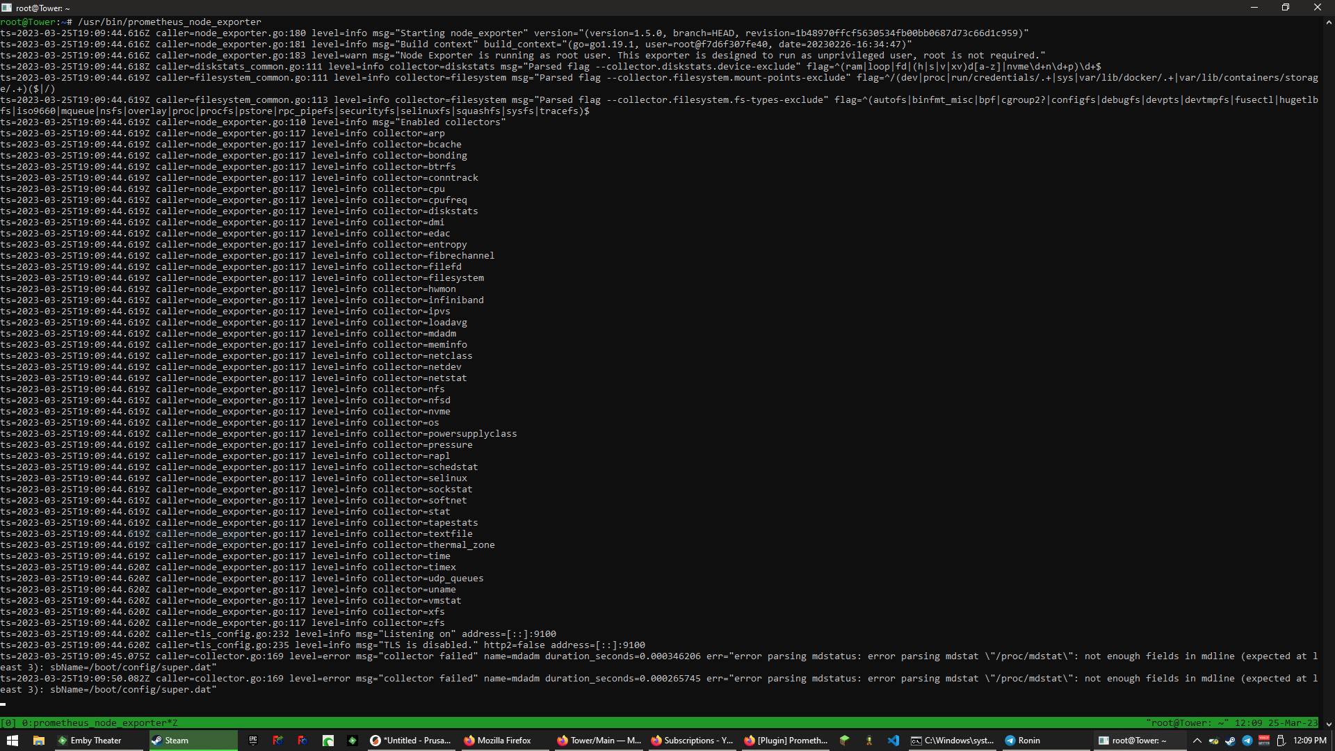

Literally just run the binary from the ssh terminal. I hadn't written its config file yet so I noted how it was executed, killed it, wrote the config file, and executed it by hand in a terminal.
Why are you doing that by hand? What settings did you change? I installed the plugin and have no issue whatsoever and can connect to it just fine.
The plugin is only meant to be installed and that's it. You can however run it with custom parameters but I think in your case something is wrong if you changed some settings, that's my best guess.

Yes, it's actually exactly the same on my system but TBH, I've never noticed it because I've always ran it as a service:
6 hours ago, codefaux said:
I'll file a bug upstream with the actual node collector's maintainer, as it's now clear to me that the actual collector is mishandling the output of /proc/mdstat on my system and it has nothing to do with the small wrapper plugin you wrote.
I've found already another report here on the forums but that's related to the Docker container:
But please keep in mind that Unraid doesn't use the default md driver and instead it uses it's custom md driver for the Array.
I think the issue is caused by that which is also mentioned in the bug report from the Docker container.
Anyways, thank you for the report, I will look into that when I got a bit more spare time.
For now you can, of course if you want to, disable the mdadm metrics entirely.
Simply edit your "/boot/config/plugins/prometheus_node_exporter/settings.cfg" file so that it looks like this:
start_parameters=--no-collector.mdadm
Of course you have to restart your server because, as you've mentioned earlier, there is not restart function implemented in the plugin because this is more a niche use case to pass arguments to the plugin itself, however if you want to start it in the background as usual simply do that:
echo "/usr/bin/prometheus_node_exporter --no-collector.mdadm" | at now
of course you first have to kill the background exporter process first with something like that:
kill $(pidof prometheus_node_exporter)
or if you want to test the command first without starting it in the background:
Hope that helps for now! :)

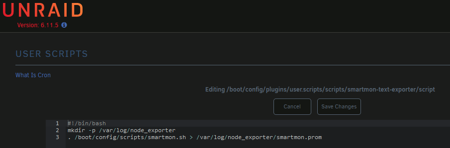

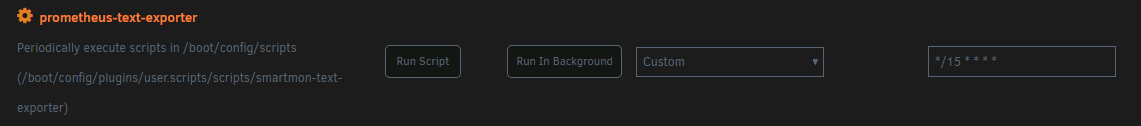

Hey here's another suggestion for an easy addition full of feature delivery.
There exists a handful of community scripts to ammend data provided by node_exporter. Most of them seem to be intended to pipe to a text file and read via node_exporter's textfile collector.
The metrics go into a file wherever, then to the exporter as a launch parameter, you add `--collector.textfile.directory=/var/lib/node_exporter` for example, and all of the readable files within /var/lib will be exported as metrics if they're in the correct format.
For example, smartmon.sh writes smartmon statistics such as temperature and unallocated blocks. nvme_metrics.sh might be of interest, btrfs_stats.py, maybe even directory-size.sh for some folks.
The most simple way I can think of is for your plugin to create a directory in the ram filesystem at /var/log and add `--collector.textfile.directory=/var/log/node_exporter` and suggest users execute the desired scripts, writing into /var/log/node_exporter in per-script files. I can see two ways of doing this.
- One, users copy script files to someplace like /boot/config/scripts (one-time write for the scripts, no flash wear) and execute them via the User Scripts plugin as such;
Scheduled similarly;
The /var/log filesystem will exist on any system, won't cause flash wear, is wiped on reboot.  The path should have plenty of space for a few kb (or even dozen MB) of metrics being rewritten every few minutes. If it doesn't, failure case is that logging fails on the system -- not ideal but it's mounted with 128MB by Unraid and should never be near full unless a user has a serious problem elsewhere. If it's filling, the absense of this plugin's proposed metrics won't prevent it or even delay it by much.
These metrics are designed to be overwritten, not appeneded, so they should never grow more than a few dozen MB in the most obscene scenario. Plugins seem to run as root, so permissions shouldn't be a problem.
I'm also going to ping the user scripts developer to allow stdout to be piped to a file per-script, so users can simply paste the scripts into User Scripts and forward the stdout, instead of needing to save them to /boot/config/scripts manually and write a User Script to run it manually.
