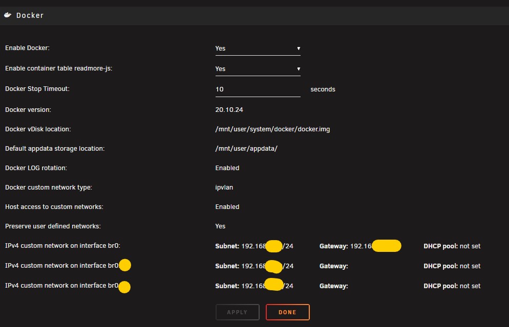

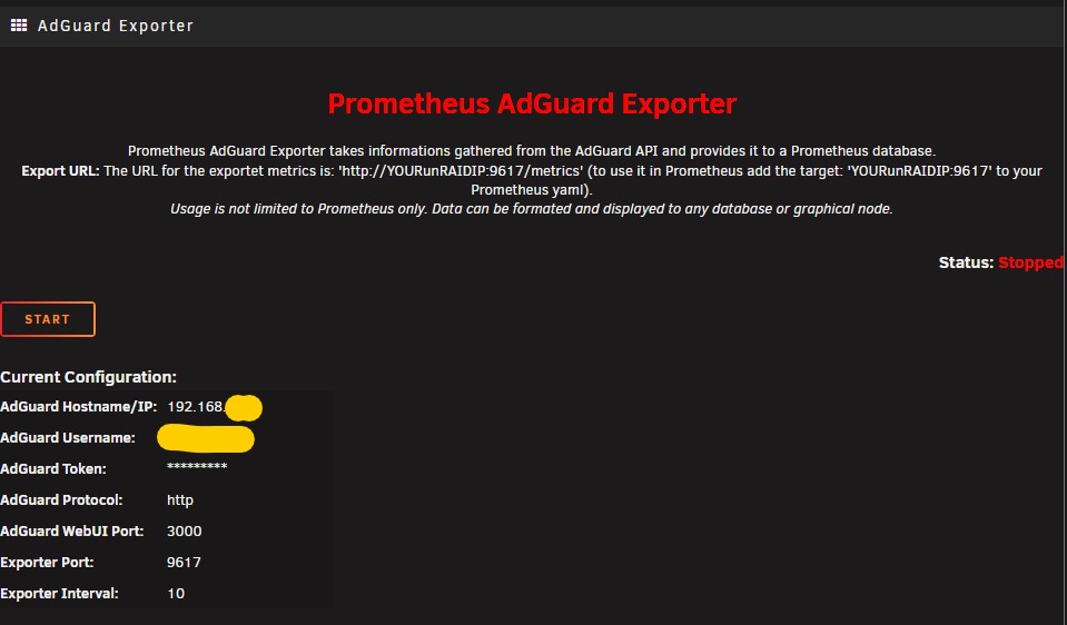

Yep. I already did.
Prometheus and Grafana are in a custom docker network.
Adguard is running in br0.
Here are the docker settings currently:
Here it is:
@ich777 I solved my problem. It seems that the plugin doesn't like special characters on the password. So I change the AdGuard password to alpha numeric and it is now running.

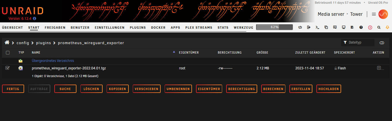

Hey , i installed prometheus wireguard exporter.
But in prometheus are no metrics?
Are there files missing?🤔
I have only the compressed file ^^
Thanks for help :)
What is wrong about those? Every plugin has such a file.
…and no there aren‘t missing files.
What is the second screenshot?
Is that from the exporter URL?

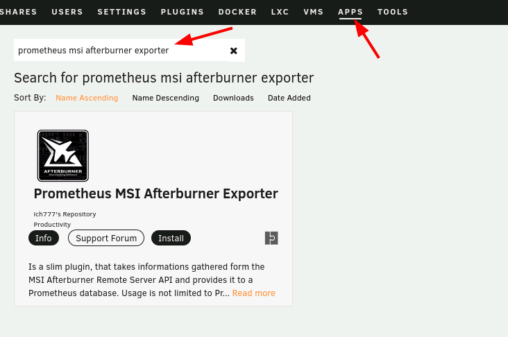

Hi, I want to download MSI Afterburner Exporter, but I dont know what is the "CA App" you are refering to. Could you help me with this? Thanks
On 11/4/2023 at 9:37 PM, LanceG0d said:
Yeah okay no problem thanks :)
It looks like the main binary is broken with newer versions from Wireguard which Unraid is using, I'll wait a bit if the maintainer responds in his GitHub repository over here, otherwise I have no other choice than deprecating the plugin or switch to another exporter.
ohh okay , so i will wait too :)
