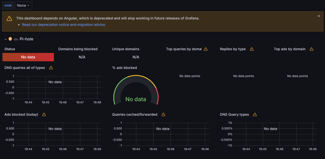

Hello ! The JSON file is outdated, on dashboard, it says : "This panel requires Angular (deprecated)"
Is there a updated files for ? Thank you for the job anyway !

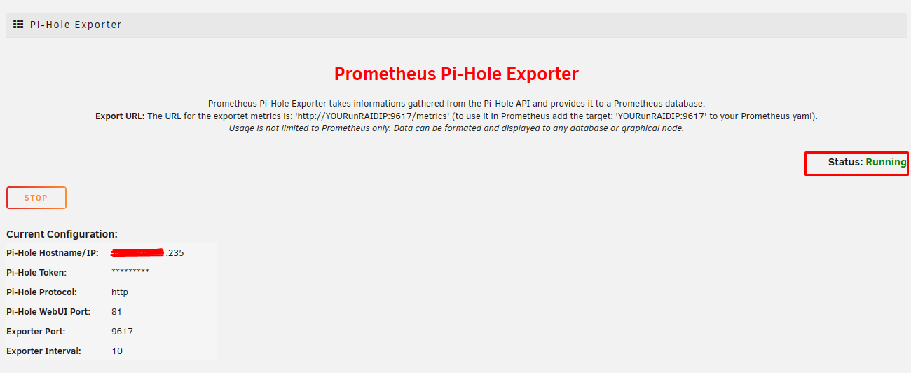

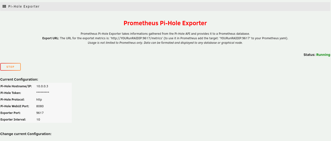

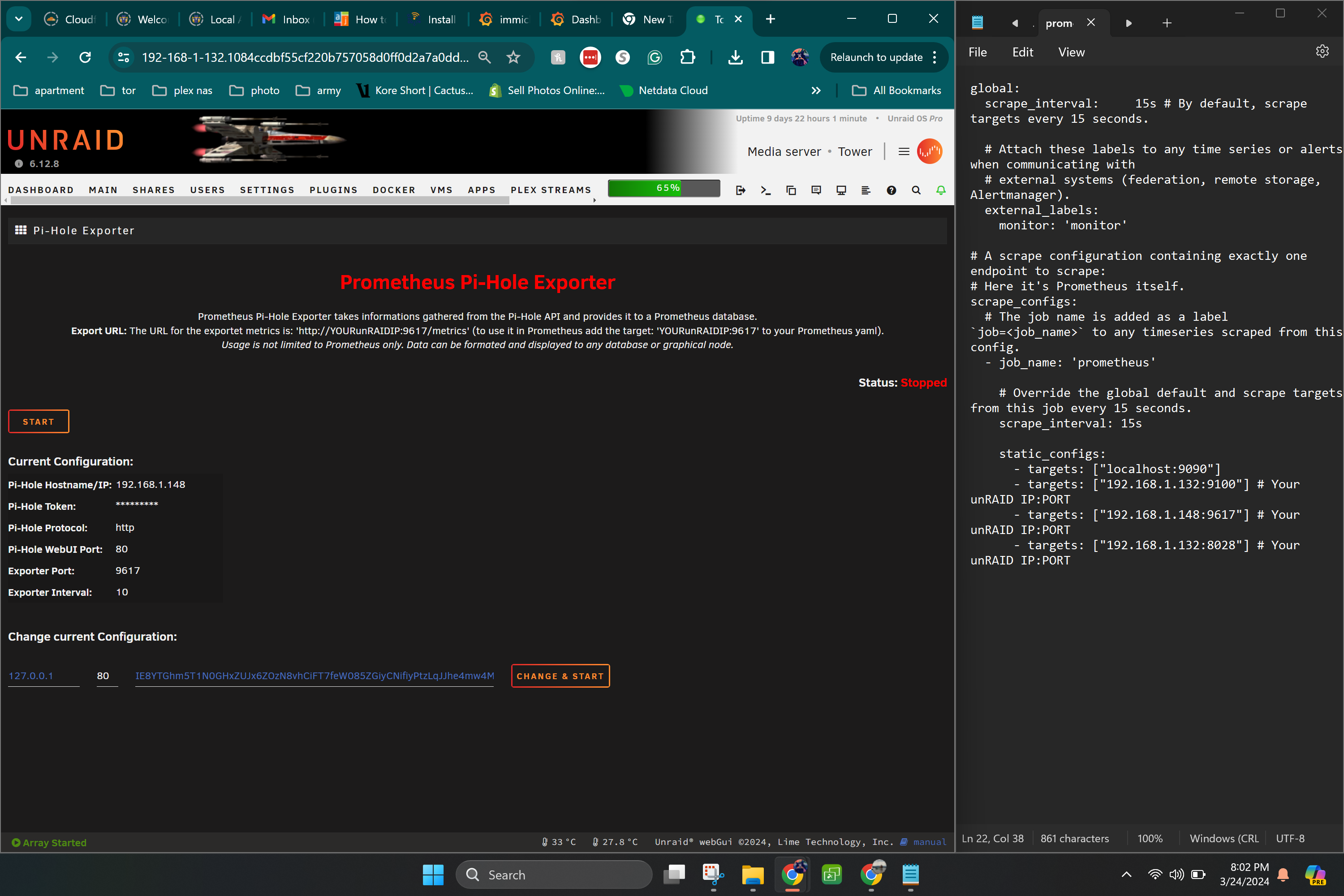

I can not get the Pi-hole Exporter to run. Its configured but it will not start. Pi hole was set to bridge, but i tried br0 and another custom network i have but nothing lets it connect not sure what i should do to proceed
Edited by T_Matz
added picture
Is PiHole running on Unraid itself?
I have now tried it and it is working fine over here:
I only can imagine that Unraid is not able to communicate with your PiHole.
Can you ping the IP address from PiHole from a Unraid Terminal?
 You are correct I cant ping Pihole. I thought everything was working correctly because it is blocking traffic but I cant ping it from any computer on the network.
Edit:
I was able to correct the issue with not being able to ping Pihole. I have the exporter up and running but it wont connect to prometheus now. I still get a connect:connection refused.
Edited by T_Matz
update
Please open the seite: http://YOURunRAIDIP:9617/metrics and see what you get back?

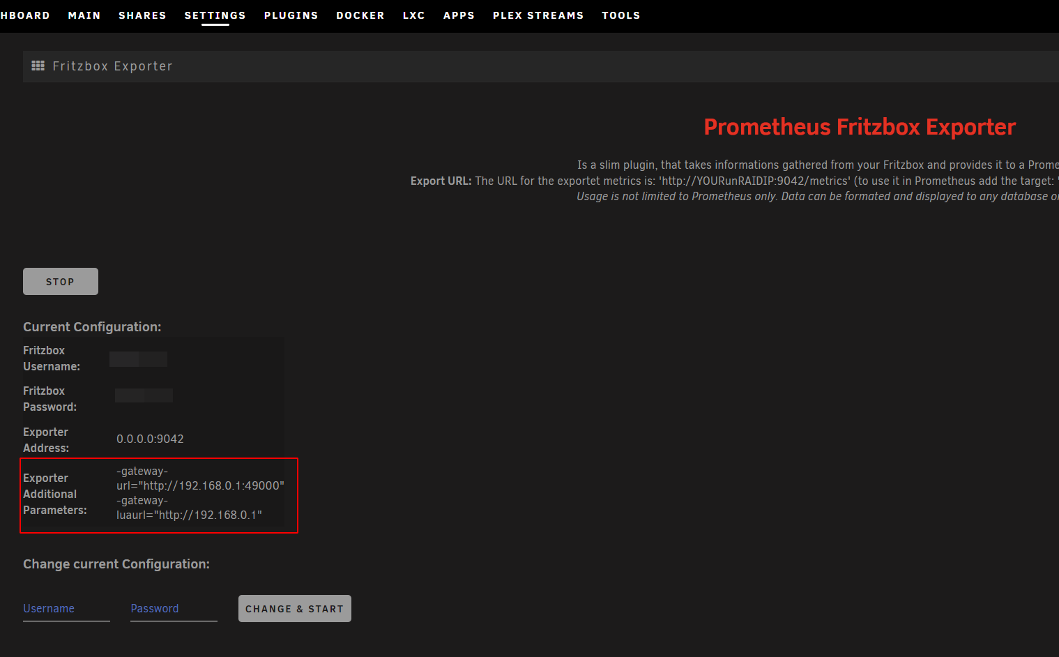

Great work.
Is there a way to choose the fritzbox IP?
The Fritzbox should be discovered automatically IIRC, sorry I don't have a Fritzbox, maybe @sonic6 or @alturismo can help here a bit.
i did use it a while ago ... and yes, but i used it manually to define my fritz devices ...
so thi splugin was basically just the install, i ran the plugin manually from terminal (script),
The exporter can directly be run from a shell. Set the environment vars or config file as described in the configuration section of this README and run python3 -m fritzbox_exporter [--config /path/to/config/file.yaml] from the code directory.
https://fritz-exporter.readthedocs.io/en/latest/running.html
you have to edit the config file on your flash drive: boot/config/plugins/prometheus_fritzbox_exporter/settings.cfg
fritz_username=FITZBOX-USER
fritz_password=FRITZBOX-USER-PW
fritz_additional= -gateway-url="http://YOUR-FRITZBOX-IP:49000" -gateway-luaurl="http://YOUR-FRITZBOX-IP"
exporter_address=0.0.0.0:9042
exporter_metrics_file=metrics.json
exporter_luametrics_file=metrics-lua.json
than it will looks like this:
192.168.0.1 is the IP of my fritzbox.
This worked like a charm thank you.

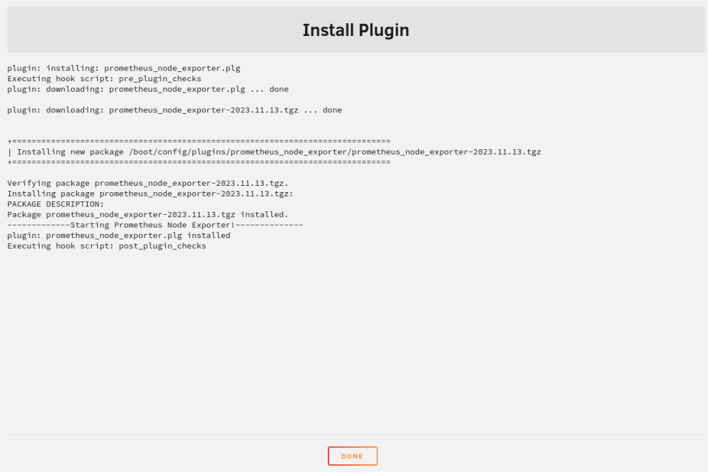

Using my Fritzbox as Internet Gateway with LTE backup only. Behind is a TP Link Omada ER605v2. So the discovery doesn't work because the Fritbox is on another subnet.
I see in prometheus
"Get "http://myIP:9100/metrics": dial tcp myIP:9100: connect: no route to host"
Bu I can open myIP:9100 and see all information:
# HELP go_gc_duration_seconds A summary of the pause duration of garbage collection cycles.
# TYPE go_gc_duration_seconds summary
go_gc_duration_seconds{quantile="0"} 2.7502e-05
go_gc_duration_seconds{quantile="0.25"} 3.3061e-05
go_gc_duration_seconds{quantile="0.5"} 3.9764e-05
go_gc_duration_seconds{quantile="0.75"} 4.5858e-05
go_gc_duration_seconds{quantile="1"} 6.8148e-05
go_gc_duration_seconds_sum 0.001682561
go_gc_duration_seconds_count 41
# HELP go_goroutines Number of goroutines that currently exist.
# TYPE go_goroutines gauge
go_goroutines 7
Is it some issue in Prometheus Node Exporter plugin ?
Do you have Host access enabled in your Docker settings?
Ah, thanks a lot. It is disabled.

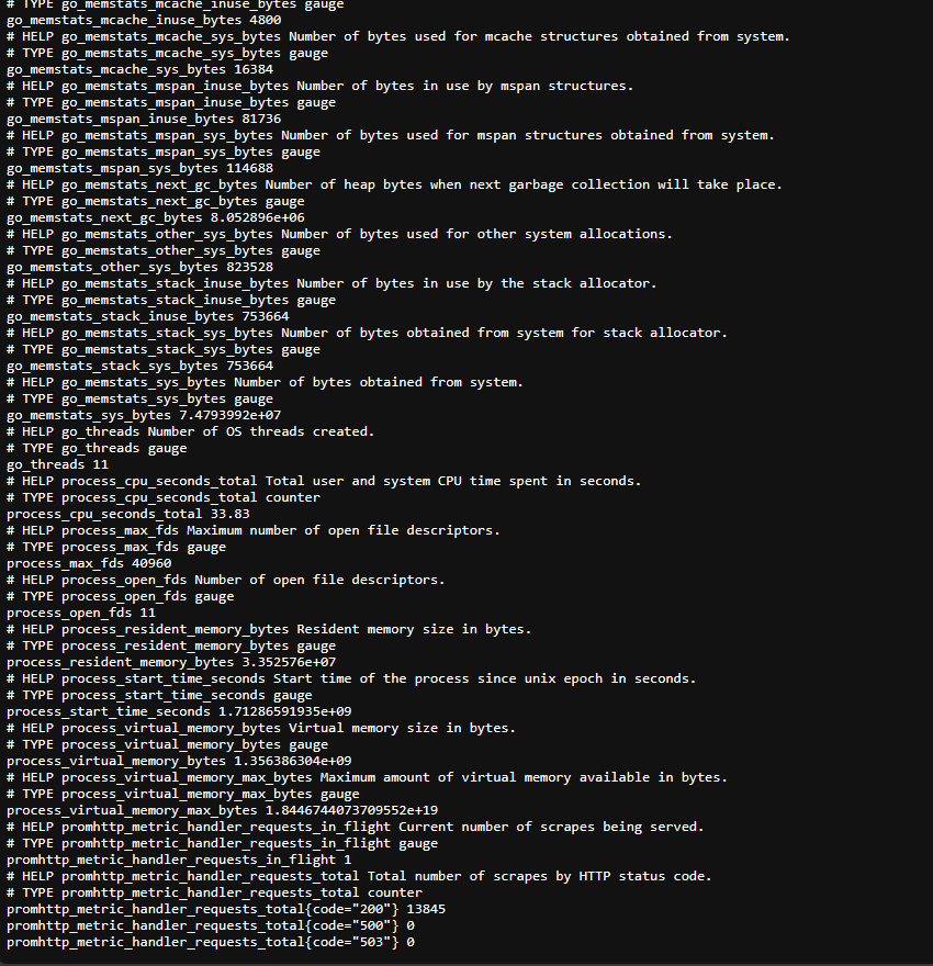

After following the steps to configure Grafana for Sexigraf, no data appears and I can't find the reason. Below I put my configuration.
I hope your help :)
12 minutes ago, MatuScien said:
I hope your help :)
Is host access enabled?
What does 192.168.111.200:9617/metrics give you back if you open it in a browser?
I'm surprised by the speed in replying!
I knew I needed to post some images... :P
The output is correct, can you try to restart the Docker service, it seems that Host Access is not working properly.
You can easily try that by opening up a container terminal (from Grafana or Prometheus) and try to ping Unraid.
