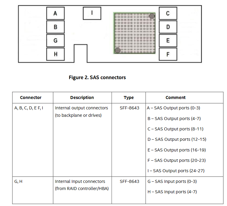

July 5, 20215 yr I recently purchased a LSI 9300-8i and an Intel RES3TV360. I have a total of 20 disks connected to the controller, 18 of which are in the array. I have one disk in the array connected via USB 3. I am rebuilding parity so I can then shuck the USB drive and rebuild the data on it connected to the 9300-8i. I am only getting about 50MB/s during my parity rebuild and I'm not sure why. I verified the controller is connected with pcie 3.0 speeds and all 8 lanes. I'm not sure if there is a way to check the link between the RES3TV360 and the 9300-8i. This is my first sas expander so I thought I would get someone with some more knowledge to chime in. Edit I just look in my logs and found a lot of these messages. Spoiler Jul 4 22:48:58 Maple1 kernel: mpt3sas_cm0: log_info(0x31110f00): originator(PL), code(0x11), sub_code(0x0f00) Jul 4 22:48:58 Maple1 kernel: mpt3sas_cm0: log_info(0x31110f00): originator(PL), code(0x11), sub_code(0x0f00) Jul 4 22:48:58 Maple1 kernel: mpt3sas_cm0: log_info(0x31110f00): originator(PL), code(0x11), sub_code(0x0f00) Jul 4 22:48:58 Maple1 kernel: mpt3sas_cm0: log_info(0x31110f00): originator(PL), code(0x11), sub_code(0x0f00) Jul 4 22:48:58 Maple1 kernel: mpt3sas_cm0: log_info(0x31110f00): originator(PL), code(0x11), sub_code(0x0f00) Jul 4 22:48:58 Maple1 kernel: mpt3sas_cm0: log_info(0x31110f00): originator(PL), code(0x11), sub_code(0x0f00) Jul 4 22:48:58 Maple1 kernel: mpt3sas_cm0: log_info(0x31110f00): originator(PL), code(0x11), sub_code(0x0f00) Jul 4 22:48:59 Maple1 kernel: sd 12:0:1:0: Power-on or device reset occurred Jul 4 22:48:59 Maple1 kernel: mpt3sas_cm0: log_info(0x31080000): originator(PL), code(0x08), sub_code(0x0000) Jul 4 22:48:59 Maple1 rc.diskinfo[11464]: SIGHUP received, forcing refresh of disks info. Jul 4 22:48:59 Maple1 kernel: mpt3sas_cm0: log_info(0x31080000): originator(PL), code(0x08), sub_code(0x0000) Jul 4 22:48:59 Maple1 kernel: mpt3sas_cm0: log_info(0x31080000): originator(PL), code(0x08), sub_code(0x0000) Jul 4 22:48:59 Maple1 kernel: mpt3sas_cm0: log_info(0x31080000): originator(PL), code(0x08), sub_code(0x0000) Jul 4 22:48:59 Maple1 kernel: mpt3sas_cm0: log_info(0x31080000): originator(PL), code(0x08), sub_code(0x0000) Jul 4 22:48:59 Maple1 kernel: mpt3sas_cm0: log_info(0x31080000): originator(PL), code(0x08), sub_code(0x0000) Jul 4 22:48:59 Maple1 kernel: mpt3sas_cm0: log_info(0x31080000): originator(PL), code(0x08), sub_code(0x0000) Jul 4 22:48:59 Maple1 kernel: mpt3sas_cm0: log_info(0x31080000): originator(PL), code(0x08), sub_code(0x0000) Jul 4 22:48:59 Maple1 kernel: mpt3sas_cm0: log_info(0x31080000): originator(PL), code(0x08), sub_code(0x0000) Jul 4 22:48:59 Maple1 kernel: mpt3sas_cm0: log_info(0x31080000): originator(PL), code(0x08), sub_code(0x0000) Jul 4 22:48:59 Maple1 kernel: mpt3sas_cm0: log_info(0x31080000): originator(PL), code(0x08), sub_code(0x0000) Jul 4 22:48:59 Maple1 kernel: mpt3sas_cm0: log_info(0x31080000): originator(PL), code(0x08), sub_code(0x0000) Jul 4 22:48:59 Maple1 kernel: mpt3sas_cm0: log_info(0x31080000): originator(PL), code(0x08), sub_code(0x0000) Jul 4 22:48:59 Maple1 kernel: mpt3sas_cm0: log_info(0x31080000): originator(PL), code(0x08), sub_code(0x0000) Jul 4 22:48:59 Maple1 kernel: mpt3sas_cm0: log_info(0x31080000): originator(PL), code(0x08), sub_code(0x0000) Jul 4 22:48:59 Maple1 kernel: mpt3sas_cm0: log_info(0x31080000): originator(PL), code(0x08), sub_code(0x0000) Jul 4 22:48:59 Maple1 kernel: mpt3sas_cm0: log_info(0x31080000): originator(PL), code(0x08), sub_code(0x0000) Jul 4 22:48:59 Maple1 kernel: mpt3sas_cm0: log_info(0x31080000): originator(PL), code(0x08), sub_code(0x0000) Jul 4 22:48:59 Maple1 kernel: mpt3sas_cm0: log_info(0x31080000): originator(PL), code(0x08), sub_code(0x0000) Jul 4 22:48:59 Maple1 kernel: mpt3sas_cm0: log_info(0x31080000): originator(PL), code(0x08), sub_code(0x0000) Jul 4 22:48:59 Maple1 kernel: mpt3sas_cm0: log_info(0x31080000): originator(PL), code(0x08), sub_code(0x0000) Jul 4 22:48:59 Maple1 kernel: mpt3sas_cm0: log_info(0x31080000): originator(PL), code(0x08), sub_code(0x0000) Jul 4 22:48:59 Maple1 kernel: mpt3sas_cm0: log_info(0x31080000): originator(PL), code(0x08), sub_code(0x0000) Jul 4 22:48:59 Maple1 kernel: mpt3sas_cm0: log_info(0x31080000): originator(PL), code(0x08), sub_code(0x0000) Jul 4 22:48:59 Maple1 kernel: mpt3sas_cm0: log_info(0x31080000): originator(PL), code(0x08), sub_code(0x0000) Jul 4 22:48:59 Maple1 kernel: mpt3sas_cm0: log_info(0x31080000): originator(PL), code(0x08), sub_code(0x0000) Jul 4 22:48:59 Maple1 kernel: mpt3sas_cm0: log_info(0x31080000): originator(PL), code(0x08), sub_code(0x0000) Jul 4 22:48:59 Maple1 kernel: mpt3sas_cm0: log_info(0x31080000): originator(PL), code(0x08), sub_code(0x0000) Jul 4 22:48:59 Maple1 kernel: mpt3sas_cm0: log_info(0x31080000): originator(PL), code(0x08), sub_code(0x0000) Jul 4 22:48:59 Maple1 kernel: mpt3sas_cm0: log_info(0x31080000): originator(PL), code(0x08), sub_code(0x0000) Jul 4 22:48:59 Maple1 kernel: mpt3sas_cm0: log_info(0x31080000): originator(PL), code(0x08), sub_code(0x0000) Jul 4 22:48:59 Maple1 kernel: mpt3sas_cm0: log_info(0x31080000): originator(PL), code(0x08), sub_code(0x0000) Jul 4 22:48:59 Maple1 kernel: mpt3sas_cm0: log_info(0x31080000): originator(PL), code(0x08), sub_code(0x0000) Jul 4 22:48:59 Maple1 kernel: mpt3sas_cm0: log_info(0x31080000): originator(PL), code(0x08), sub_code(0x0000) Jul 4 22:48:59 Maple1 kernel: mpt3sas_cm0: log_info(0x31080000): originator(PL), code(0x08), sub_code(0x0000) Jul 4 22:48:59 Maple1 kernel: mpt3sas_cm0: log_info(0x31080000): originator(PL), code(0x08), sub_code(0x0000) Jul 4 22:48:59 Maple1 kernel: mpt3sas_cm0: log_info(0x31080000): originator(PL), code(0x08), sub_code(0x0000) Jul 4 22:48:59 Maple1 kernel: mpt3sas_cm0: log_info(0x31080000): originator(PL), code(0x08), sub_code(0x0000) Jul 4 22:49:00 Maple1 kernel: mpt3sas_cm0: log_info(0x31110610): originator(PL), code(0x11), sub_code(0x0610) Jul 4 22:49:00 Maple1 kernel: mpt3sas_cm0: log_info(0x31110610): originator(PL), code(0x11), sub_code(0x0610) Jul 4 22:49:00 Maple1 kernel: mpt3sas_cm0: log_info(0x31110610): originator(PL), code(0x11), sub_code(0x0610) Jul 4 22:49:00 Maple1 kernel: sd 12:0:14:0: Power-on or device reset occurred Jul 4 22:49:00 Maple1 kernel: mpt3sas_cm0: log_info(0x31080000): originator(PL), code(0x08), sub_code(0x0000) Jul 4 22:49:00 Maple1 kernel: mpt3sas_cm0: log_info(0x31080000): originator(PL), code(0x08), sub_code(0x0000) Jul 4 22:49:00 Maple1 kernel: mpt3sas_cm0: log_info(0x31080000): originator(PL), code(0x08), sub_code(0x0000) Jul 4 22:49:00 Maple1 kernel: mpt3sas_cm0: log_info(0x31080000): originator(PL), code(0x08), sub_code(0x0000) Jul 4 22:49:00 Maple1 kernel: mpt3sas_cm0: log_info(0x31080000): originator(PL), code(0x08), sub_code(0x0000) Jul 4 22:49:00 Maple1 kernel: mpt3sas_cm0: log_info(0x31080000): originator(PL), code(0x08), sub_code(0x0000) Jul 4 22:49:00 Maple1 kernel: mpt3sas_cm0: log_info(0x31080000): originator(PL), code(0x08), sub_code(0x0000) Jul 4 22:49:00 Maple1 kernel: mpt3sas_cm0: log_info(0x31080000): originator(PL), code(0x08), sub_code(0x0000) Jul 4 22:49:00 Maple1 kernel: mpt3sas_cm0: log_info(0x31080000): originator(PL), code(0x08), sub_code(0x0000) Jul 4 22:49:00 Maple1 kernel: mpt3sas_cm0: log_info(0x31080000): originator(PL), code(0x08), sub_code(0x0000) Jul 4 22:49:00 Maple1 kernel: mpt3sas_cm0: log_info(0x31080000): originator(PL), code(0x08), sub_code(0x0000) Jul 4 22:49:00 Maple1 kernel: mpt3sas_cm0: log_info(0x31080000): originator(PL), code(0x08), sub_code(0x0000) Jul 4 22:49:00 Maple1 kernel: mpt3sas_cm0: log_info(0x31080000): originator(PL), code(0x08), sub_code(0x0000) Jul 4 22:49:00 Maple1 kernel: mpt3sas_cm0: log_info(0x31080000): originator(PL), code(0x08), sub_code(0x0000) Jul 4 22:49:01 Maple1 kernel: mpt3sas_cm0: log_info(0x31080000): originator(PL), code(0x08), sub_code(0x0000) Jul 4 22:49:01 Maple1 kernel: mpt3sas_cm0: log_info(0x31080000): originator(PL), code(0x08), sub_code(0x0000) Jul 4 22:49:01 Maple1 kernel: mpt3sas_cm0: log_info(0x31080000): originator(PL), code(0x08), sub_code(0x0000) Jul 4 22:49:01 Maple1 kernel: mpt3sas_cm0: log_info(0x31080000): originator(PL), code(0x08), sub_code(0x0000) Jul 4 22:49:01 Maple1 kernel: mpt3sas_cm0: log_info(0x31080000): originator(PL), code(0x08), sub_code(0x0000) Jul 4 22:49:01 Maple1 kernel: mpt3sas_cm0: log_info(0x31080000): originator(PL), code(0x08), sub_code(0x0000) Jul 4 22:49:01 Maple1 kernel: mpt3sas_cm0: log_info(0x31080000): originator(PL), code(0x08), sub_code(0x0000) Jul 4 22:49:01 Maple1 kernel: mpt3sas_cm0: log_info(0x31080000): originator(PL), code(0x08), sub_code(0x0000) Jul 4 22:49:01 Maple1 kernel: mpt3sas_cm0: log_info(0x31080000): originator(PL), code(0x08), sub_code(0x0000) Jul 4 22:49:01 Maple1 kernel: mpt3sas_cm0: log_info(0x31080000): originator(PL), code(0x08), sub_code(0x0000) Jul 4 22:49:01 Maple1 kernel: mpt3sas_cm0: log_info(0x31080000): originator(PL), code(0x08), sub_code(0x0000) Jul 4 22:49:01 Maple1 kernel: mpt3sas_cm0: log_info(0x31080000): originator(PL), code(0x08), sub_code(0x0000) Jul 4 22:49:01 Maple1 kernel: mpt3sas_cm0: log_info(0x31080000): originator(PL), code(0x08), sub_code(0x0000) Jul 4 22:49:01 Maple1 kernel: mpt3sas_cm0: log_info(0x31080000): originator(PL), code(0x08), sub_code(0x0000) Jul 4 22:49:01 Maple1 kernel: mpt3sas_cm0: log_info(0x31080000): originator(PL), code(0x08), sub_code(0x0000) Jul 4 22:49:01 Maple1 kernel: mpt3sas_cm0: log_info(0x31080000): originator(PL), code(0x08), sub_code(0x0000) Jul 4 22:49:02 Maple1 kernel: mpt3sas_cm0: log_info(0x31080000): originator(PL), code(0x08), sub_code(0x0000) Jul 4 22:49:02 Maple1 kernel: mpt3sas_cm0: log_info(0x31080000): originator(PL), code(0x08), sub_code(0x0000) Jul 4 22:49:02 Maple1 kernel: mpt3sas_cm0: log_info(0x31080000): originator(PL), code(0x08), sub_code(0x0000) Jul 4 22:49:02 Maple1 kernel: mpt3sas_cm0: log_info(0x31080000): originator(PL), code(0x08), sub_code(0x0000) Jul 4 22:49:02 Maple1 kernel: mpt3sas_cm0: log_info(0x31080000): originator(PL), code(0x08), sub_code(0x0000) Jul 4 22:49:02 Maple1 kernel: mpt3sas_cm0: log_info(0x31080000): originator(PL), code(0x08), sub_code(0x0000) Jul 4 22:49:02 Maple1 kernel: mpt3sas_cm0: log_info(0x31080000): originator(PL), code(0x08), sub_code(0x0000) Jul 4 22:49:02 Maple1 kernel: mpt3sas_cm0: log_info(0x31080000): originator(PL), code(0x08), sub_code(0x0000) Jul 4 22:49:02 Maple1 kernel: mpt3sas_cm0: log_info(0x31080000): originator(PL), code(0x08), sub_code(0x0000) Jul 4 22:49:02 Maple1 kernel: mpt3sas_cm0: log_info(0x31080000): originator(PL), code(0x08), sub_code(0x0000) Jul 4 22:49:02 Maple1 kernel: mpt3sas_cm0: log_info(0x31080000): originator(PL), code(0x08), sub_code(0x0000) Jul 4 22:49:02 Maple1 kernel: mpt3sas_cm0: log_info(0x31080000): originator(PL), code(0x08), sub_code(0x0000) Jul 4 22:49:02 Maple1 kernel: mpt3sas_cm0: log_info(0x31080000): originator(PL), code(0x08), sub_code(0x0000) Jul 4 22:49:02 Maple1 kernel: mpt3sas_cm0: log_info(0x31080000): originator(PL), code(0x08), sub_code(0x0000) Jul 4 22:49:02 Maple1 kernel: mpt3sas_cm0: log_info(0x31080000): originator(PL), code(0x08), sub_code(0x0000) Jul 4 22:49:02 Maple1 kernel: mpt3sas_cm0: log_info(0x31080000): originator(PL), code(0x08), sub_code(0x0000) Jul 4 22:49:02 Maple1 kernel: mpt3sas_cm0: log_info(0x31080000): originator(PL), code(0x08), sub_code(0x0000) Jul 4 22:49:02 Maple1 kernel: mpt3sas_cm0: log_info(0x31080000): originator(PL), code(0x08), sub_code(0x0000) Jul 4 22:49:02 Maple1 kernel: mpt3sas_cm0: log_info(0x31080000): originator(PL), code(0x08), sub_code(0x0000) Jul 4 22:49:02 Maple1 kernel: mpt3sas_cm0: log_info(0x31080000): originator(PL), code(0x08), sub_code(0x0000) Jul 4 22:49:02 Maple1 kernel: mpt3sas_cm0: log_info(0x31080000): originator(PL), code(0x08), sub_code(0x0000) Jul 4 22:49:02 Maple1 kernel: mpt3sas_cm0: log_info(0x31080000): originator(PL), code(0x08), sub_code(0x0000) Jul 4 22:49:02 Maple1 kernel: mpt3sas_cm0: log_info(0x31080000): originator(PL), code(0x08), sub_code(0x0000) Jul 4 22:49:02 Maple1 kernel: mpt3sas_cm0: log_info(0x31080000): originator(PL), code(0x08), sub_code(0x0000) Jul 4 22:49:02 Maple1 kernel: mpt3sas_cm0: log_info(0x31080000): originator(PL), code(0x08), sub_code(0x0000) Jul 4 22:49:02 Maple1 kernel: mpt3sas_cm0: log_info(0x31080000): originator(PL), code(0x08), sub_code(0x0000) Jul 4 22:49:02 Maple1 kernel: mpt3sas_cm0: log_info(0x31080000): originator(PL), code(0x08), sub_code(0x0000) Jul 4 22:49:02 Maple1 kernel: mpt3sas_cm0: log_info(0x31080000): originator(PL), code(0x08), sub_code(0x0000) Jul 4 22:49:02 Maple1 kernel: mpt3sas_cm0: log_info(0x31080000): originator(PL), code(0x08), sub_code(0x0000) Jul 4 22:49:02 Maple1 kernel: mpt3sas_cm0: log_info(0x31080000): originator(PL), code(0x08), sub_code(0x0000) Jul 4 22:49:02 Maple1 kernel: mpt3sas_cm0: log_info(0x31080000): originator(PL), code(0x08), sub_code(0x0000) Jul 4 22:49:02 Maple1 kernel: mpt3sas_cm0: log_info(0x31080000): originator(PL), code(0x08), sub_code(0x0000) Jul 4 22:49:02 Maple1 kernel: mpt3sas_cm0: log_info(0x31080000): originator(PL), code(0x08), sub_code(0x0000) Jul 4 22:49:02 Maple1 kernel: mpt3sas_cm0: log_info(0x31080000): originator(PL), code(0x08), sub_code(0x0000) Jul 4 22:49:02 Maple1 kernel: mpt3sas_cm0: log_info(0x31080000): originator(PL), code(0x08), sub_code(0x0000) Jul 4 22:49:06 Maple1 kernel: mpt3sas_cm0: log_info(0x31110f00): originator(PL), code(0x11), sub_code(0x0f00) Jul 4 22:49:06 Maple1 kernel: mpt3sas_cm0: log_info(0x31110f00): originator(PL), code(0x11), sub_code(0x0f00) Jul 4 22:49:06 Maple1 kernel: mpt3sas_cm0: log_info(0x31110f00): originator(PL), code(0x11), sub_code(0x0f00) Jul 4 22:49:06 Maple1 kernel: mpt3sas_cm0: log_info(0x31110f00): originator(PL), code(0x11), sub_code(0x0f00) Jul 4 22:49:06 Maple1 kernel: mpt3sas_cm0: log_info(0x31110f00): originator(PL), code(0x11), sub_code(0x0f00) Jul 4 22:49:06 Maple1 kernel: mpt3sas_cm0: log_info(0x31110f00): originator(PL), code(0x11), sub_code(0x0f00) Jul 4 22:49:06 Maple1 kernel: mpt3sas_cm0: log_info(0x31110f00): originator(PL), code(0x11), sub_code(0x0f00) Jul 4 22:49:06 Maple1 kernel: mpt3sas_cm0: log_info(0x31110f00): originator(PL), code(0x11), sub_code(0x0f00) Jul 4 22:49:06 Maple1 kernel: mpt3sas_cm0: log_info(0x31110f00): originator(PL), code(0x11), sub_code(0x0f00) Jul 4 22:49:06 Maple1 kernel: mpt3sas_cm0: log_info(0x31110f00): originator(PL), code(0x11), sub_code(0x0f00) Jul 4 22:49:06 Maple1 kernel: mpt3sas_cm0: log_info(0x31110f00): originator(PL), code(0x11), sub_code(0x0f00) Jul 4 22:49:06 Maple1 kernel: mpt3sas_cm0: log_info(0x31110f00): originator(PL), code(0x11), sub_code(0x0f00) Jul 4 22:49:06 Maple1 kernel: sd 12:0:12:0: Power-on or device reset occurred Jul 4 22:49:06 Maple1 rc.diskinfo[11464]: SIGHUP received, forcing refresh of disks info. Jul 4 22:49:06 Maple1 kernel: mpt3sas_cm0: log_info(0x31080000): originator(PL), code(0x08), sub_code(0x0000) Jul 4 22:49:06 Maple1 kernel: mpt3sas_cm0: log_info(0x31080000): originator(PL), code(0x08), sub_code(0x0000) Jul 4 22:49:06 Maple1 kernel: mpt3sas_cm0: log_info(0x31080000): originator(PL), code(0x08), sub_code(0x0000) Jul 4 22:49:06 Maple1 kernel: mpt3sas_cm0: log_info(0x31080000): originator(PL), code(0x08), sub_code(0x0000) Jul 4 22:49:06 Maple1 kernel: mpt3sas_cm0: log_info(0x31080000): originator(PL), code(0x08), sub_code(0x0000) Jul 4 22:49:06 Maple1 kernel: mpt3sas_cm0: log_info(0x31080000): originator(PL), code(0x08), sub_code(0x0000) Jul 4 22:49:06 Maple1 kernel: mpt3sas_cm0: log_info(0x31080000): originator(PL), code(0x08), sub_code(0x0000) Jul 4 22:49:06 Maple1 kernel: mpt3sas_cm0: log_info(0x31080000): originator(PL), code(0x08), sub_code(0x0000) Jul 4 22:49:06 Maple1 kernel: mpt3sas_cm0: log_info(0x31080000): originator(PL), code(0x08), sub_code(0x0000) Jul 4 22:49:06 Maple1 kernel: mpt3sas_cm0: log_info(0x31080000): originator(PL), code(0x08), sub_code(0x0000) Jul 4 22:49:07 Maple1 kernel: mpt3sas_cm0: log_info(0x31080000): originator(PL), code(0x08), sub_code(0x0000) Jul 4 22:49:07 Maple1 kernel: mpt3sas_cm0: log_info(0x31080000): originator(PL), code(0x08), sub_code(0x0000) Jul 4 22:49:07 Maple1 kernel: mpt3sas_cm0: log_info(0x31080000): originator(PL), code(0x08), sub_code(0x0000) Jul 4 22:49:07 Maple1 kernel: mpt3sas_cm0: log_info(0x31080000): originator(PL), code(0x08), sub_code(0x0000) Jul 4 22:49:07 Maple1 kernel: mpt3sas_cm0: log_info(0x31080000): originator(PL), code(0x08), sub_code(0x0000) Jul 4 22:49:07 Maple1 kernel: mpt3sas_cm0: log_info(0x31080000): originator(PL), code(0x08), sub_code(0x0000) Jul 4 22:49:07 Maple1 kernel: mpt3sas_cm0: log_info(0x31080000): originator(PL), code(0x08), sub_code(0x0000) Jul 4 22:49:07 Maple1 kernel: mpt3sas_cm0: log_info(0x31080000): originator(PL), code(0x08), sub_code(0x0000) Jul 4 22:49:07 Maple1 kernel: mpt3sas_cm0: log_info(0x31080000): originator(PL), code(0x08), sub_code(0x0000) Jul 4 22:49:07 Maple1 kernel: mpt3sas_cm0: log_info(0x31080000): originator(PL), code(0x08), sub_code(0x0000) Jul 4 22:49:07 Maple1 kernel: mpt3sas_cm0: log_info(0x31080000): originator(PL), code(0x08), sub_code(0x0000) Jul 4 22:49:07 Maple1 kernel: mpt3sas_cm0: log_info(0x31080000): originator(PL), code(0x08), sub_code(0x0000) Jul 4 22:49:07 Maple1 kernel: mpt3sas_cm0: log_info(0x31080000): originator(PL), code(0x08), sub_code(0x0000) Jul 4 22:49:07 Maple1 kernel: mpt3sas_cm0: log_info(0x31080000): originator(PL), code(0x08), sub_code(0x0000) Jul 4 22:49:07 Maple1 kernel: mpt3sas_cm0: log_info(0x31080000): originator(PL), code(0x08), sub_code(0x0000) Jul 4 22:49:07 Maple1 kernel: mpt3sas_cm0: log_info(0x31080000): originator(PL), code(0x08), sub_code(0x0000) Jul 4 22:49:08 Maple1 kernel: mpt3sas_cm0: log_info(0x31080000): originator(PL), code(0x08), sub_code(0x0000) Jul 4 22:49:08 Maple1 kernel: mpt3sas_cm0: log_info(0x31080000): originator(PL), code(0x08), sub_code(0x0000) Jul 4 22:49:08 Maple1 kernel: mpt3sas_cm0: log_info(0x31080000): originator(PL), code(0x08), sub_code(0x0000) Jul 4 22:49:08 Maple1 kernel: mpt3sas_cm0: log_info(0x31080000): originator(PL), code(0x08), sub_code(0x0000) Jul 4 22:49:08 Maple1 kernel: mpt3sas_cm0: log_info(0x31080000): originator(PL), code(0x08), sub_code(0x0000) Jul 4 22:49:08 Maple1 kernel: mpt3sas_cm0: log_info(0x31080000): originator(PL), code(0x08), sub_code(0x0000) Jul 4 22:49:08 Maple1 kernel: mpt3sas_cm0: log_info(0x31080000): originator(PL), code(0x08), sub_code(0x0000) Jul 4 22:49:08 Maple1 kernel: mpt3sas_cm0: log_info(0x31080000): originator(PL), code(0x08), sub_code(0x0000) Jul 4 22:49:08 Maple1 kernel: mpt3sas_cm0: log_info(0x31080000): originator(PL), code(0x08), sub_code(0x0000) Jul 4 22:49:08 Maple1 kernel: mpt3sas_cm0: log_info(0x31080000): originator(PL), code(0x08), sub_code(0x0000) Jul 4 22:49:08 Maple1 kernel: mpt3sas_cm0: log_info(0x31080000): originator(PL), code(0x08), sub_code(0x0000) Jul 4 22:49:08 Maple1 kernel: mpt3sas_cm0: log_info(0x31080000): originator(PL), code(0x08), sub_code(0x0000) Jul 4 22:49:08 Maple1 kernel: mpt3sas_cm0: log_info(0x31080000): originator(PL), code(0x08), sub_code(0x0000) Jul 4 22:49:08 Maple1 kernel: mpt3sas_cm0: log_info(0x31080000): originator(PL), code(0x08), sub_code(0x0000) Jul 4 22:49:08 Maple1 kernel: mpt3sas_cm0: log_info(0x31080000): originator(PL), code(0x08), sub_code(0x0000) Jul 4 22:49:08 Maple1 kernel: mpt3sas_cm0: log_info(0x31080000): originator(PL), code(0x08), sub_code(0x0000) Jul 4 22:49:08 Maple1 kernel: mpt3sas_cm0: log_info(0x31080000): originator(PL), code(0x08), sub_code(0x0000) Jul 4 22:49:08 Maple1 kernel: mpt3sas_cm0: log_info(0x31080000): originator(PL), code(0x08), sub_code(0x0000) Jul 4 22:49:08 Maple1 kernel: mpt3sas_cm0: log_info(0x31080000): originator(PL), code(0x08), sub_code(0x0000) Jul 4 22:49:08 Maple1 kernel: mpt3sas_cm0: log_info(0x31080000): originator(PL), code(0x08), sub_code(0x0000) Jul 4 22:49:08 Maple1 kernel: mpt3sas_cm0: log_info(0x31080000): originator(PL), code(0x08), sub_code(0x0000) Jul 4 22:49:09 Maple1 kernel: mpt3sas_cm0: log_info(0x31110610): originator(PL), code(0x11), sub_code(0x0610) Jul 4 22:49:09 Maple1 kernel: mpt3sas_cm0: log_info(0x31110610): originator(PL), code(0x11), sub_code(0x0610) Jul 4 22:49:09 Maple1 kernel: sd 12:0:1:0: Power-on or device reset occurred Jul 4 22:49:10 Maple1 kernel: mpt3sas_cm0: log_info(0x31080000): originator(PL), code(0x08), sub_code(0x0000) Jul 4 22:49:10 Maple1 kernel: mpt3sas_cm0: log_info(0x31080000): originator(PL), code(0x08), sub_code(0x0000) Jul 4 22:49:10 Maple1 kernel: mpt3sas_cm0: log_info(0x31080000): originator(PL), code(0x08), sub_code(0x0000) Jul 4 22:49:10 Maple1 kernel: mpt3sas_cm0: log_info(0x31080000): originator(PL), code(0x08), sub_code(0x0000) Jul 4 22:49:10 Maple1 kernel: mpt3sas_cm0: log_info(0x31080000): originator(PL), code(0x08), sub_code(0x0000) Jul 4 22:49:10 Maple1 kernel: mpt3sas_cm0: log_info(0x31080000): originator(PL), code(0x08), sub_code(0x0000) Jul 4 22:49:10 Maple1 kernel: mpt3sas_cm0: log_info(0x31080000): originator(PL), code(0x08), sub_code(0x0000) Jul 4 22:49:10 Maple1 kernel: mpt3sas_cm0: log_info(0x31080000): originator(PL), code(0x08), sub_code(0x0000) Jul 4 22:49:10 Maple1 kernel: mpt3sas_cm0: log_info(0x31080000): originator(PL), code(0x08), sub_code(0x0000) Jul 4 22:49:10 Maple1 kernel: mpt3sas_cm0: log_info(0x31080000): originator(PL), code(0x08), sub_code(0x0000) Jul 4 22:49:10 Maple1 kernel: mpt3sas_cm0: log_info(0x31080000): originator(PL), code(0x08), sub_code(0x0000) Jul 4 22:49:10 Maple1 kernel: mpt3sas_cm0: log_info(0x31080000): originator(PL), code(0x08), sub_code(0x0000) Jul 4 22:49:10 Maple1 kernel: mpt3sas_cm0: log_info(0x31080000): originator(PL), code(0x08), sub_code(0x0000) Jul 4 22:49:10 Maple1 kernel: mpt3sas_cm0: log_info(0x31080000): originator(PL), code(0x08), sub_code(0x0000) Jul 4 22:49:10 Maple1 kernel: mpt3sas_cm0: log_info(0x31080000): originator(PL), code(0x08), sub_code(0x0000) Jul 4 22:49:10 Maple1 kernel: mpt3sas_cm0: log_info(0x31080000): originator(PL), code(0x08), sub_code(0x0000) Jul 4 22:49:10 Maple1 kernel: mpt3sas_cm0: log_info(0x31080000): originator(PL), code(0x08), sub_code(0x0000) Jul 4 22:49:10 Maple1 kernel: mpt3sas_cm0: log_info(0x31080000): originator(PL), code(0x08), sub_code(0x0000) Jul 4 22:49:10 Maple1 kernel: mpt3sas_cm0: log_info(0x31080000): originator(PL), code(0x08), sub_code(0x0000) Jul 4 22:49:10 Maple1 kernel: mpt3sas_cm0: log_info(0x31080000): originator(PL), code(0x08), sub_code(0x0000) Jul 4 22:49:10 Maple1 kernel: mpt3sas_cm0: log_info(0x31080000): originator(PL), code(0x08), sub_code(0x0000) Jul 4 22:49:10 Maple1 kernel: mpt3sas_cm0: log_info(0x31080000): originator(PL), code(0x08), sub_code(0x0000) Jul 4 22:49:10 Maple1 kernel: mpt3sas_cm0: log_info(0x31080000): originator(PL), code(0x08), sub_code(0x0000) Jul 4 22:49:10 Maple1 kernel: mpt3sas_cm0: log_info(0x31080000): originator(PL), code(0x08), sub_code(0x0000) Jul 4 22:49:10 Maple1 kernel: mpt3sas_cm0: log_info(0x31080000): originator(PL), code(0x08), sub_code(0x0000) Jul 4 22:49:10 Maple1 kernel: mpt3sas_cm0: log_info(0x31080000): originator(PL), code(0x08), sub_code(0x0000) Jul 4 22:49:10 Maple1 kernel: mpt3sas_cm0: log_info(0x31080000): originator(PL), code(0x08), sub_code(0x0000) Jul 4 22:49:10 Maple1 kernel: mpt3sas_cm0: log_info(0x31080000): originator(PL), code(0x08), sub_code(0x0000) Jul 4 22:49:10 Maple1 kernel: mpt3sas_cm0: log_info(0x31080000): originator(PL), code(0x08), sub_code(0x0000) Jul 4 22:49:10 Maple1 kernel: mpt3sas_cm0: log_info(0x31080000): originator(PL), code(0x08), sub_code(0x0000) Jul 4 22:49:10 Maple1 kernel: mpt3sas_cm0: log_info(0x31080000): originator(PL), code(0x08), sub_code(0x0000) Jul 4 22:49:10 Maple1 kernel: mpt3sas_cm0: log_info(0x31080000): originator(PL), code(0x08), sub_code(0x0000) Jul 4 22:49:10 Maple1 kernel: mpt3sas_cm0: log_info(0x31080000): originator(PL), code(0x08), sub_code(0x0000) Jul 4 22:49:10 Maple1 kernel: mpt3sas_cm0: log_info(0x31080000): originator(PL), code(0x08), sub_code(0x0000) Jul 4 22:49:10 Maple1 kernel: mpt3sas_cm0: log_info(0x31080000): originator(PL), code(0x08), sub_code(0x0000) Jul 4 22:49:10 Maple1 kernel: mpt3sas_cm0: log_info(0x31080000): originator(PL), code(0x08), sub_code(0x0000) Jul 4 22:49:10 Maple1 kernel: mpt3sas_cm0: log_info(0x31080000): originator(PL), code(0x08), sub_code(0x0000) Jul 4 22:49:11 Maple1 kernel: mpt3sas_cm0: log_info(0x31080000): originator(PL), code(0x08), sub_code(0x0000) Jul 4 22:49:11 Maple1 kernel: mpt3sas_cm0: log_info(0x31080000): originator(PL), code(0x08), sub_code(0x0000) Jul 4 22:49:11 Maple1 kernel: mpt3sas_cm0: log_info(0x31080000): originator(PL), code(0x08), sub_code(0x0000) Jul 4 22:49:11 Maple1 kernel: mpt3sas_cm0: log_info(0x31080000): originator(PL), code(0x08), sub_code(0x0000) Jul 4 22:49:11 Maple1 kernel: mpt3sas_cm0: log_info(0x31080000): originator(PL), code(0x08), sub_code(0x0000) Jul 4 22:49:11 Maple1 kernel: mpt3sas_cm0: log_info(0x31080000): originator(PL), code(0x08), sub_code(0x0000) Jul 4 22:49:11 Maple1 kernel: mpt3sas_cm0: log_info(0x31080000): originator(PL), code(0x08), sub_code(0x0000) Jul 4 22:49:11 Maple1 kernel: mpt3sas_cm0: log_info(0x31080000): originator(PL), code(0x08), sub_code(0x0000) Jul 4 22:49:11 Maple1 kernel: mpt3sas_cm0: log_info(0x31080000): originator(PL), code(0x08), sub_code(0x0000) Jul 4 22:49:11 Maple1 kernel: mpt3sas_cm0: log_info(0x31080000): originator(PL), code(0x08), sub_code(0x0000) Jul 4 22:49:11 Maple1 kernel: mpt3sas_cm0: log_info(0x31080000): originator(PL), code(0x08), sub_code(0x0000) Jul 4 22:49:11 Maple1 kernel: mpt3sas_cm0: log_info(0x31080000): originator(PL), code(0x08), sub_code(0x0000) Jul 4 22:49:11 Maple1 kernel: mpt3sas_cm0: log_info(0x31080000): originator(PL), code(0x08), sub_code(0x0000) Jul 4 22:49:11 Maple1 kernel: mpt3sas_cm0: log_info(0x31080000): originator(PL), code(0x08), sub_code(0x0000) Jul 4 22:49:11 Maple1 kernel: mpt3sas_cm0: log_info(0x31080000): originator(PL), code(0x08), sub_code(0x0000) Jul 4 22:49:11 Maple1 kernel: mpt3sas_cm0: log_info(0x31080000): originator(PL), code(0x08), sub_code(0x0000) Jul 4 22:49:11 Maple1 kernel: mpt3sas_cm0: log_info(0x31080000): originator(PL), code(0x08), sub_code(0x0000) Jul 4 22:49:11 Maple1 kernel: mpt3sas_cm0: log_info(0x31080000): originator(PL), code(0x08), sub_code(0x0000) Jul 4 22:49:11 Maple1 kernel: mpt3sas_cm0: log_info(0x31080000): originator(PL), code(0x08), sub_code(0x0000) Jul 4 22:49:15 Maple1 kernel: mpt3sas_cm0: log_info(0x31110f00): originator(PL), code(0x11), sub_code(0x0f00) Jul 4 22:49:15 Maple1 kernel: mpt3sas_cm0: log_info(0x31110f00): originator(PL), code(0x11), sub_code(0x0f00) Jul 4 22:49:15 Maple1 kernel: mpt3sas_cm0: log_info(0x31110f00): originator(PL), code(0x11), sub_code(0x0f00) Jul 4 22:49:15 Maple1 kernel: mpt3sas_cm0: log_info(0x31110f00): originator(PL), code(0x11), sub_code(0x0f00) Jul 4 22:49:15 Maple1 kernel: mpt3sas_cm0: log_info(0x31110f00): originator(PL), code(0x11), sub_code(0x0f00) Jul 4 22:49:15 Maple1 kernel: mpt3sas_cm0: log_info(0x31110f00): originator(PL), code(0x11), sub_code(0x0f00) Jul 4 22:49:15 Maple1 kernel: mpt3sas_cm0: log_info(0x31110f00): originator(PL), code(0x11), sub_code(0x0f00) Jul 4 22:49:15 Maple1 kernel: mpt3sas_cm0: log_info(0x31110f00): originator(PL), code(0x11), sub_code(0x0f00) Jul 4 22:49:15 Maple1 kernel: mpt3sas_cm0: log_info(0x31110f00): originator(PL), code(0x11), sub_code(0x0f00) Jul 4 22:49:15 Maple1 kernel: mpt3sas_cm0: log_info(0x31110f00): originator(PL), code(0x11), sub_code(0x0f00) Jul 4 22:49:15 Maple1 kernel: mpt3sas_cm0: log_info(0x31110f00): originator(PL), code(0x11), sub_code(0x0f00) Jul 4 22:49:16 Maple1 kernel: sd 12:0:6:0: Power-on or device reset occurred Jul 4 22:49:16 Maple1 rc.diskinfo[11464]: SIGHUP received, forcing refresh of disks info. Jul 4 22:49:16 Maple1 kernel: mpt3sas_cm0: log_info(0x31080000): originator(PL), code(0x08), sub_code(0x0000) Jul 4 22:49:16 Maple1 kernel: mpt3sas_cm0: log_info(0x31080000): originator(PL), code(0x08), sub_code(0x0000) Jul 4 22:49:16 Maple1 kernel: mpt3sas_cm0: log_info(0x31080000): originator(PL), code(0x08), sub_code(0x0000) Jul 4 22:49:16 Maple1 kernel: mpt3sas_cm0: log_info(0x31080000): originator(PL), code(0x08), sub_code(0x0000) Jul 4 22:49:16 Maple1 kernel: mpt3sas_cm0: log_info(0x31080000): originator(PL), code(0x08), sub_code(0x0000) Jul 4 22:49:16 Maple1 kernel: mpt3sas_cm0: log_info(0x31080000): originator(PL), code(0x08), sub_code(0x0000) Jul 4 22:49:16 Maple1 kernel: mpt3sas_cm0: log_info(0x31080000): originator(PL), code(0x08), sub_code(0x0000) Jul 4 22:49:16 Maple1 kernel: mpt3sas_cm0: log_info(0x31080000): originator(PL), code(0x08), sub_code(0x0000) Jul 4 22:49:16 Maple1 kernel: mpt3sas_cm0: log_info(0x31080000): originator(PL), code(0x08), sub_code(0x0000) Jul 4 22:49:16 Maple1 kernel: mpt3sas_cm0: log_info(0x31080000): originator(PL), code(0x08), sub_code(0x0000) Jul 4 22:49:16 Maple1 kernel: mpt3sas_cm0: log_info(0x31080000): originator(PL), code(0x08), sub_code(0x0000) Jul 4 22:49:16 Maple1 kernel: mpt3sas_cm0: log_info(0x31080000): originator(PL), code(0x08), sub_code(0x0000) Jul 4 22:49:16 Maple1 kernel: mpt3sas_cm0: log_info(0x31080000): originator(PL), code(0x08), sub_code(0x0000) Jul 4 22:49:16 Maple1 kernel: mpt3sas_cm0: log_info(0x31080000): originator(PL), code(0x08), sub_code(0x0000) Jul 4 22:49:16 Maple1 kernel: mpt3sas_cm0: log_info(0x31080000): originator(PL), code(0x08), sub_code(0x0000) Jul 4 22:49:16 Maple1 kernel: mpt3sas_cm0: log_info(0x31080000): originator(PL), code(0x08), sub_code(0x0000) Jul 4 22:49:16 Maple1 kernel: mpt3sas_cm0: log_info(0x31080000): originator(PL), code(0x08), sub_code(0x0000) Jul 4 22:49:16 Maple1 kernel: mpt3sas_cm0: log_info(0x31080000): originator(PL), code(0x08), sub_code(0x0000) Jul 4 22:49:16 Maple1 kernel: mpt3sas_cm0: log_info(0x31080000): originator(PL), code(0x08), sub_code(0x0000) Jul 4 22:49:16 Maple1 kernel: mpt3sas_cm0: log_info(0x31080000): originator(PL), code(0x08), sub_code(0x0000) Jul 4 22:49:17 Maple1 kernel: mpt3sas_cm0: log_info(0x31080000): originator(PL), code(0x08), sub_code(0x0000) Jul 4 22:49:17 Maple1 kernel: mpt3sas_cm0: log_info(0x31080000): originator(PL), code(0x08), sub_code(0x0000) Jul 4 22:49:17 Maple1 kernel: mpt3sas_cm0: log_info(0x31080000): originator(PL), code(0x08), sub_code(0x0000) Jul 4 22:49:17 Maple1 kernel: mpt3sas_cm0: log_info(0x31080000): originator(PL), code(0x08), sub_code(0x0000) Jul 4 22:49:17 Maple1 kernel: mpt3sas_cm0: log_info(0x31080000): originator(PL), code(0x08), sub_code(0x0000) Jul 4 22:49:17 Maple1 kernel: mpt3sas_cm0: log_info(0x31080000): originator(PL), code(0x08), sub_code(0x0000) Jul 4 22:49:17 Maple1 kernel: mpt3sas_cm0: log_info(0x31080000): originator(PL), code(0x08), sub_code(0x0000) Jul 4 22:49:17 Maple1 kernel: mpt3sas_cm0: log_info(0x31080000): originator(PL), code(0x08), sub_code(0x0000) Jul 4 22:49:17 Maple1 kernel: mpt3sas_cm0: log_info(0x31080000): originator(PL), code(0x08), sub_code(0x0000) Jul 4 22:49:17 Maple1 kernel: mpt3sas_cm0: log_info(0x31080000): originator(PL), code(0x08), sub_code(0x0000) Jul 4 22:49:17 Maple1 kernel: mpt3sas_cm0: log_info(0x31080000): originator(PL), code(0x08), sub_code(0x0000) Jul 4 22:49:17 Maple1 kernel: mpt3sas_cm0: log_info(0x31080000): originator(PL), code(0x08), sub_code(0x0000) Jul 4 22:49:17 Maple1 kernel: mpt3sas_cm0: log_info(0x31080000): originator(PL), code(0x08), sub_code(0x0000) Jul 4 22:49:17 Maple1 kernel: mpt3sas_cm0: log_info(0x31080000): originator(PL), code(0x08), sub_code(0x0000) Jul 4 22:49:17 Maple1 kernel: mpt3sas_cm0: log_info(0x31080000): originator(PL), code(0x08), sub_code(0x0000) Jul 4 22:49:17 Maple1 kernel: mpt3sas_cm0: log_info(0x31080000): originator(PL), code(0x08), sub_code(0x0000) Jul 4 22:49:17 Maple1 kernel: mpt3sas_cm0: log_info(0x31080000): originator(PL), code(0x08), sub_code(0x0000) Jul 4 22:49:17 Maple1 kernel: mpt3sas_cm0: log_info(0x31080000): originator(PL), code(0x08), sub_code(0x0000) Jul 4 22:49:17 Maple1 kernel: mpt3sas_cm0: log_info(0x31080000): originator(PL), code(0x08), sub_code(0x0000) Jul 4 22:49:17 Maple1 kernel: mpt3sas_cm0: log_info(0x31080000): originator(PL), code(0x08), sub_code(0x0000) Jul 4 22:49:17 Maple1 kernel: mpt3sas_cm0: log_info(0x31080000): originator(PL), code(0x08), sub_code(0x0000) Jul 4 22:49:17 Maple1 kernel: mpt3sas_cm0: log_info(0x31080000): originator(PL), code(0x08), sub_code(0x0000) Jul 4 22:49:17 Maple1 kernel: mpt3sas_cm0: log_info(0x31080000): originator(PL), code(0x08), sub_code(0x0000) Jul 4 22:49:17 Maple1 kernel: mpt3sas_cm0: log_info(0x31080000): originator(PL), code(0x08), sub_code(0x0000) Jul 4 22:49:17 Maple1 kernel: mpt3sas_cm0: log_info(0x31080000): originator(PL), code(0x08), sub_code(0x0000) Jul 4 22:49:17 Maple1 kernel: mpt3sas_cm0: log_info(0x31080000): originator(PL), code(0x08), sub_code(0x0000) Jul 4 22:49:17 Maple1 kernel: mpt3sas_cm0: log_info(0x31080000): originator(PL), code(0x08), sub_code(0x0000) Jul 4 22:49:22 Maple1 kernel: mpt3sas_cm0: log_info(0x31110f00): originator(PL), code(0x11), sub_code(0x0f00) Jul 4 22:49:22 Maple1 kernel: mpt3sas_cm0: log_info(0x31110f00): originator(PL), code(0x11), sub_code(0x0f00) Jul 4 22:49:22 Maple1 kernel: mpt3sas_cm0: log_info(0x31110f00): originator(PL), code(0x11), sub_code(0x0f00) Jul 4 22:49:22 Maple1 kernel: mpt3sas_cm0: log_info(0x31110f00): originator(PL), code(0x11), sub_code(0x0f00) Jul 4 22:49:22 Maple1 kernel: mpt3sas_cm0: log_info(0x31110f00): originator(PL), code(0x11), sub_code(0x0f00) Jul 4 22:49:22 Maple1 kernel: mpt3sas_cm0: log_info(0x31110f00): originator(PL), code(0x11), sub_code(0x0f00) Jul 4 22:49:22 Maple1 kernel: mpt3sas_cm0: log_info(0x31110f00): originator(PL), code(0x11), sub_code(0x0f00) Jul 4 22:49:22 Maple1 kernel: mpt3sas_cm0: log_info(0x31110f00): originator(PL), code(0x11), sub_code(0x0f00) Jul 4 22:49:22 Maple1 kernel: mpt3sas_cm0: log_info(0x31110f00): originator(PL), code(0x11), sub_code(0x0f00) Jul 4 22:49:22 Maple1 kernel: sd 12:0:3:0: Power-on or device reset occurred Jul 4 22:49:22 Maple1 kernel: mpt3sas_cm0: log_info(0x31080000): originator(PL), code(0x08), sub_code(0x0000) Jul 4 22:49:22 Maple1 kernel: mpt3sas_cm0: log_info(0x31080000): originator(PL), code(0x08), sub_code(0x0000) Jul 4 22:49:22 Maple1 kernel: mpt3sas_cm0: log_info(0x31080000): originator(PL), code(0x08), sub_code(0x0000) Edited July 5, 20215 yr by xxredxpandaxx

July 6, 20215 yr Author So after doing some troubleshooting I see that in the LSI 9300-8i BIOS I can only see drives attached to ports A, B, C, D, E, F but not on I. But the drives connected to port I show up in UNRAID. I also tried those drives and cable on a different port and they show up fine in the LSI 9300 BIOS. So I'm super confused as to what that means.
July 6, 20215 yr Community Expert As long as they show up in Unraid it's not a problem, I have the same expander also connected to a 9308-8i (without a BIOS installed) and have no issues with 28 devices connected.

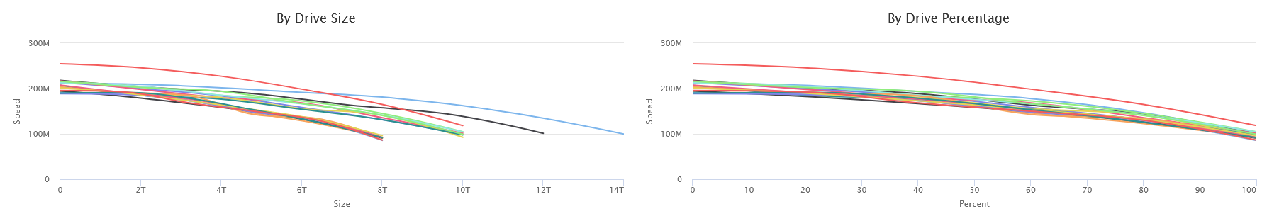

July 7, 20215 yr Author I just did a disk speed test on each drive and at 0GB they all managed right around 200MB/s. These were one at a time btw. Edited July 7, 20215 yr by xxredxpandaxx
