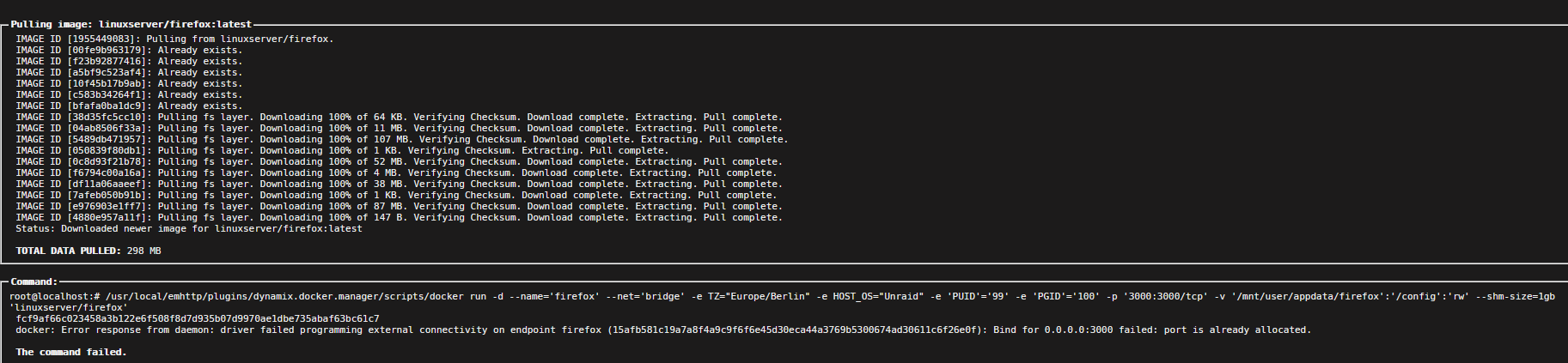

All new docker that I try to install (1) failes though visible in dockers but of course won't (2) start and says Execution Error, see pictures and diagnostics file. My already installed Dockers work just fine. Have something changed in shares or alike?

Port 3000 is already in use by another app.  Change the host port being used on the template to something else
Thanks for the quick response, changed the port and now it works perfectly!
