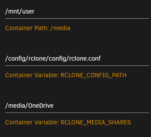

Trying to Sync from OneDrive to unRAID share named OneDrive. The issue I can't seem to deteremine the correct paths to sync data from OneDrive to the unRAID OneDrive share. The data always syncs to the root / of the container when I login to the console. Below is the settings:
I have tried every combination of paths I can think of, only to sync to the root of the container from the console rather to the OneDrive share located at /mnt/user/OneDrive. Any suggestions would be appreciated.
set the first path like so:-
then set RCLONE_MEDIA_SHARES as follows:-
also please ensure that RCLONE_REMOTE_NAME does indeed match the remote name defined in your rclone config file, including CaSe
Yup, it's the same and will create another config and rename. Thanks for the reply!

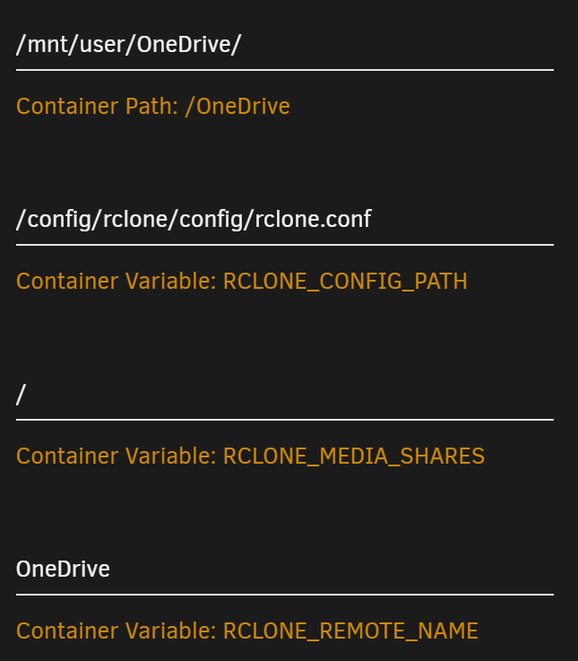

Revisting from an unsuccessful effort, I am attempting to "remotetolocal (OneDrive to unRAID). I have a share on unRAD for OneDrive located at /mnt/user/OneDrive.
I have tried every possible combination I can think related to the following:
Log:
2022-12-02 18:44:13,542 DEBG 'start-script' stdout output:
[info] Running rclone copy from remote 'remote:/media/OneDrive' to local share '/media/OneDrive'...
2022-12-02 18:44:14,953 DEBG 'start-script' stdout output:
[info] rclone copy finished
Any help would be appreciated.
Thanks
Edited by Govnah
Log:
Thanks
Does '/media/OneDrive/' exist on the remote (OneDrive)?
Sent from my 22021211RG using Tapatalk
It does not, here is my directory structure in OneDrive/remote:
My Files from left;
  Pictures
  Apps
  Documents
  Public
  Music
  etc...
So what I am attempting is to sync/remotetolocal from the above OneDrive root (including all the directories listed) to the root of /mnt/user/OneDrive.
So the question, if I wanted to sync the entire OneDrive (remote) to /mnt/user/OneDrive (local) what would be the paths for "Container Path" and "Rclone_Media-Shares"? All OneDrive directories are in the root of OneDrive, I don't have a "media" directory w/ all the directories underneath that. I think I understand the logic, but just can't seem to come w/ the correct variables to achieve what I am trying to accomplish, just simply synching OneDrive to /mnt/user/OneDrive.
Thanks
Edited by Govnah

This didn't work unfortunately:
6 hours ago, nitrosont said:
Thank you binhex for this amazing container. For me this will solve I assume many wishes regarding my cloud backup!
One question while I'm playing with my setup: In the GUI you can set bandwith limits. However I tried to define this in the docker environment, but this didn't work. How can I set the limits static / before starting the container?
