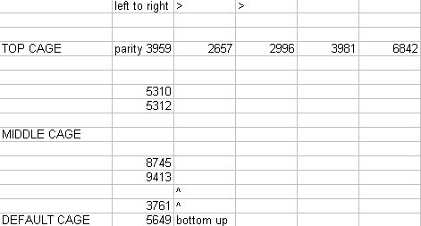

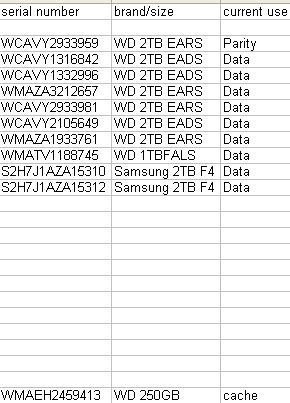

I use the last four of the serial number written on the drive in black Sharpie.  That way they can't really be seen until you shine a flash light on them. 8)
Here's what I have:
