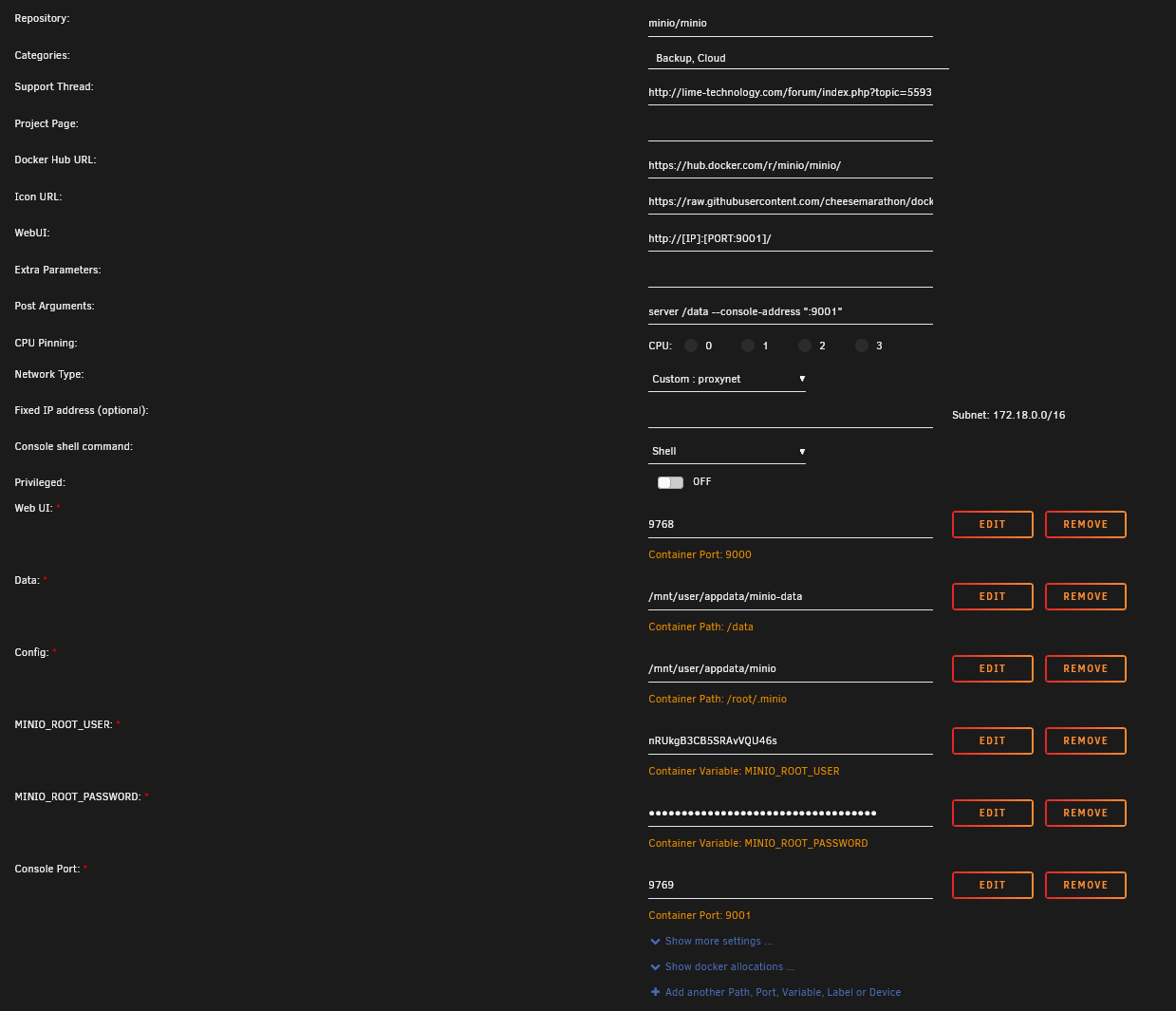

July 28, 20215 yr This is what mine looks like in Advanced View (required). Note the modified Post Arguments, changed keys/passwords, and added port mapping. It seems to work and comes up without error, though I haven't used it extensively yet.

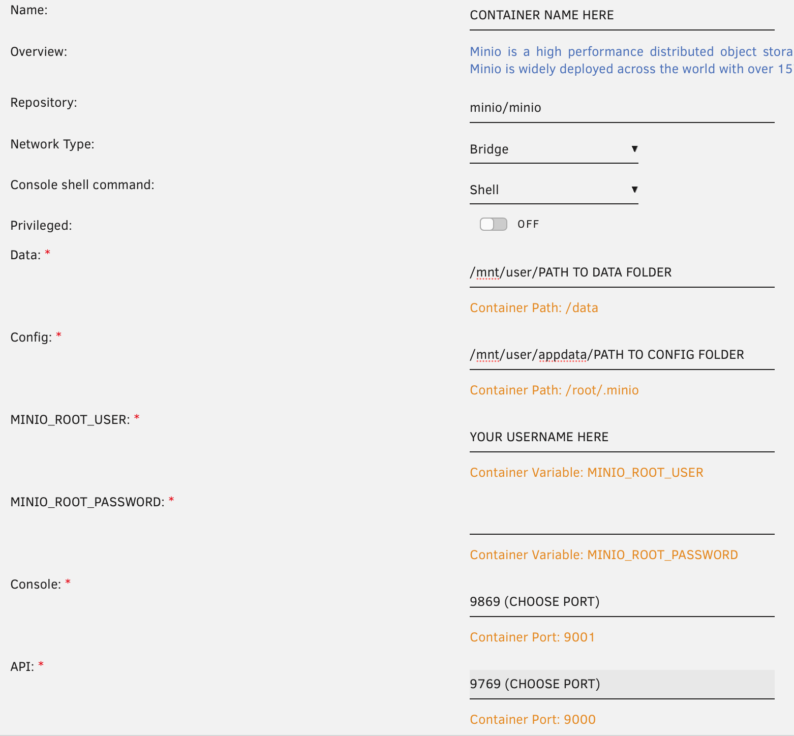

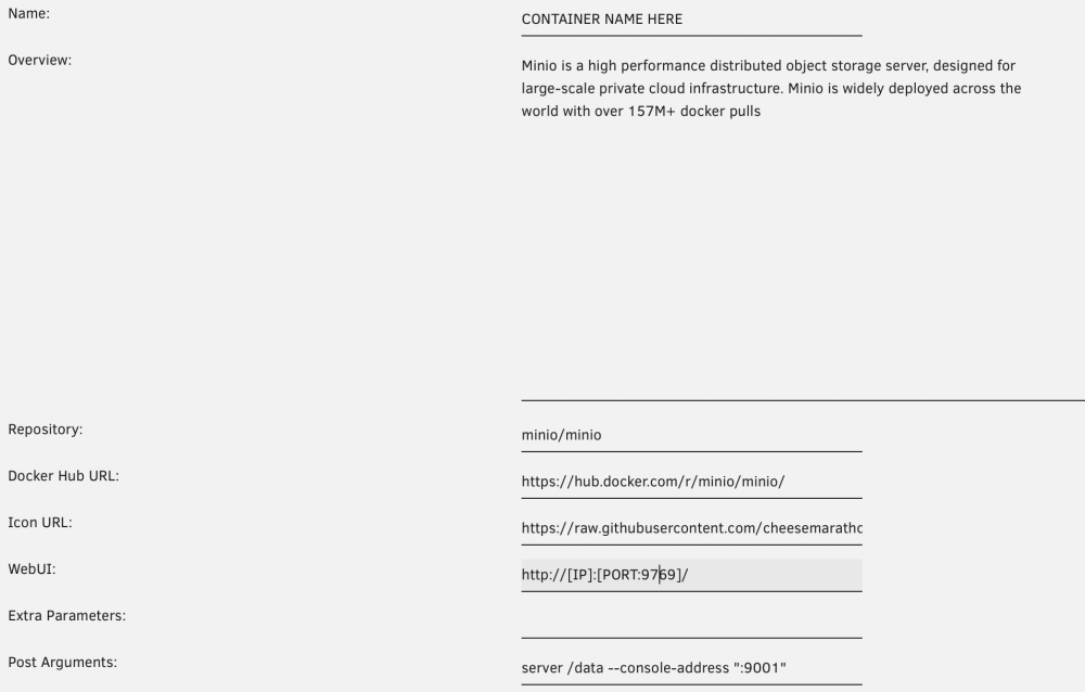

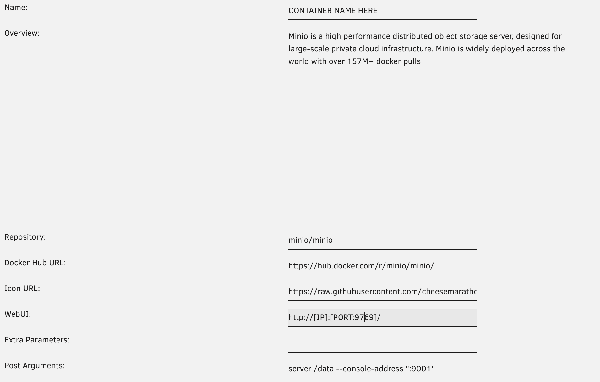

July 29, 20215 yr Thanks to everyone for your help. All my Minio instances are now back up and all users are able to attach to the servers to perform backups, etc. Settings I used in Unraid (Advanced view): Reminder, when connecting software to perform backups, etc, (Arq, GoodSync, Cloudberry, etc.) you will connect to the API port. So, if using NGINX Proxy Manager, you would map the connection to 9769 (in the example above).
