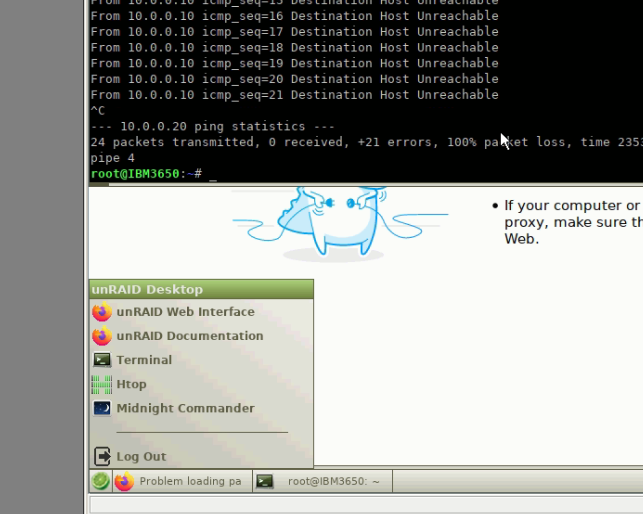

HELP!!! Server not responding to network, but local gui comes up
there is no web page displayed and a bunch of errors scrolled across the screen and the localhost page wont show, but can get to gui and terminal im a very little bit knowlegable in linux but NOT proficient enough to troubleshoot unraid.  can someone help?

wont let me get there this is the only gui i can access. from the boot of unraid
it knows its a network config, but has no internet access, or local lan access, all i did was reboot the server..
7 minutes ago, Squid said:
Tools - Diagnostics.  Upload entire zip file here.  What do you mean exactly by localhost page won't show?  Is it just blank (flashing cursor)
The web page for the dashboard doesnt show. page not found error.. but the boot gui screen for log in and then basic options does come up and i can get to a terminal window in there

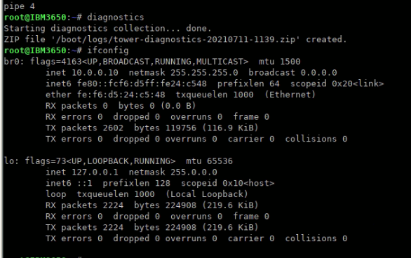

From the terminal,
diagnostics
The zip will get saved onto the flash drive (logs folder) Power down the server
powerdown
Pull the flash drive and upload the diagnostics zip file here from another computer (or alternatively, use a new tab on firefox to connect to the forums)

I tried to get the diagnostics file but it said it created , i looked for it and nothing.  no files..
ideas?
ideas?

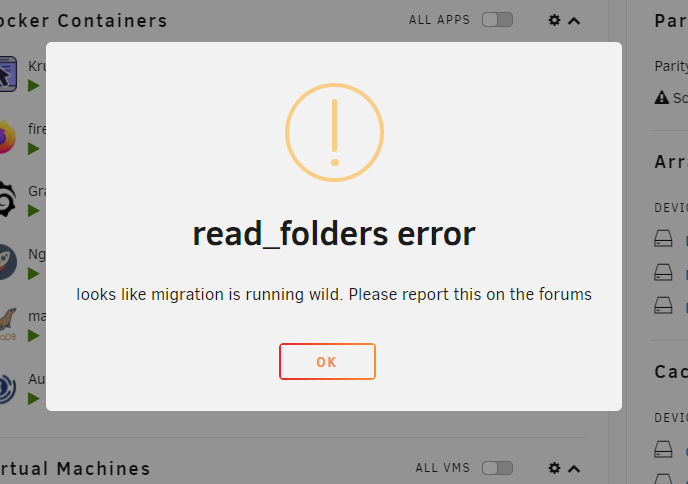

ok was able to restore from my backup'sand then using the appdata backup's i had, it recovered but it was giving me the strange errors as above..
The error above is from the Docker folder plugin, update or remove it.
