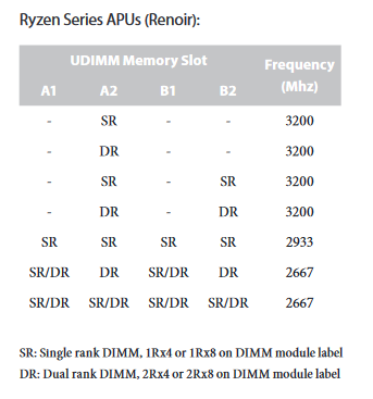

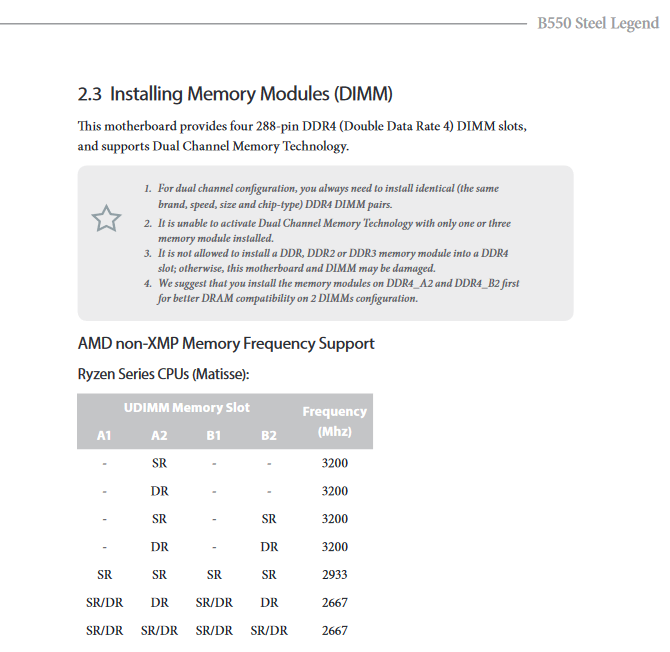

July 13, 20215 yr 5 hours ago, danktankk said: Why isnt there more backlash as a result of this ridiculous limitation? Its not a secret - this "fact" is mentioned in every AMD Mainboard-Usermanual 🤣 Here an Example of an ASRock B550 Board: Edited July 13, 20215 yr by Zonediver
