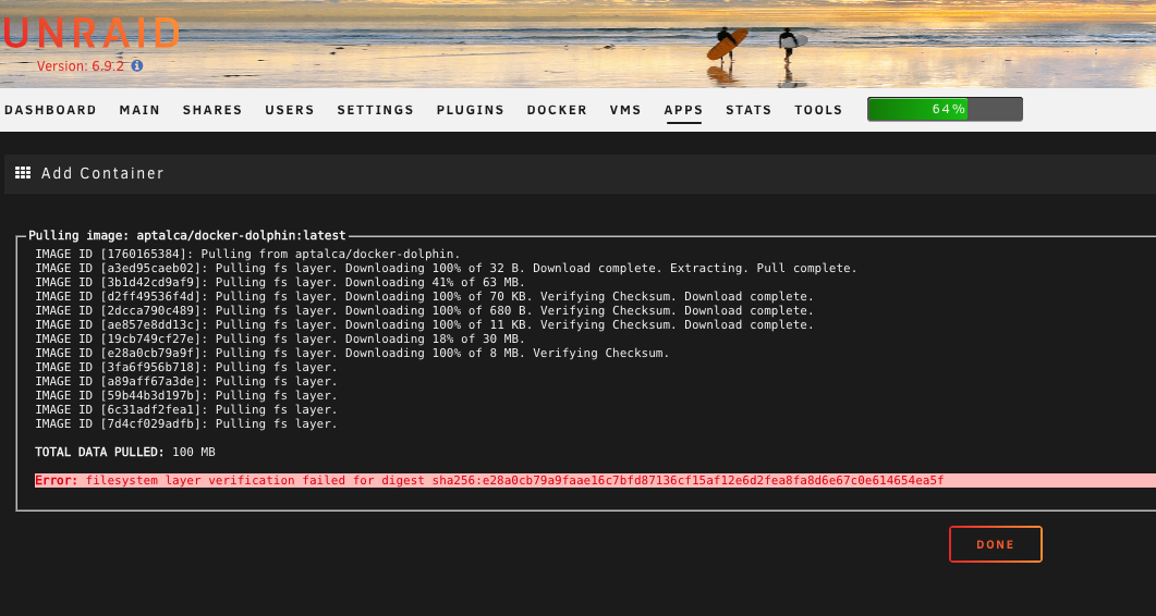

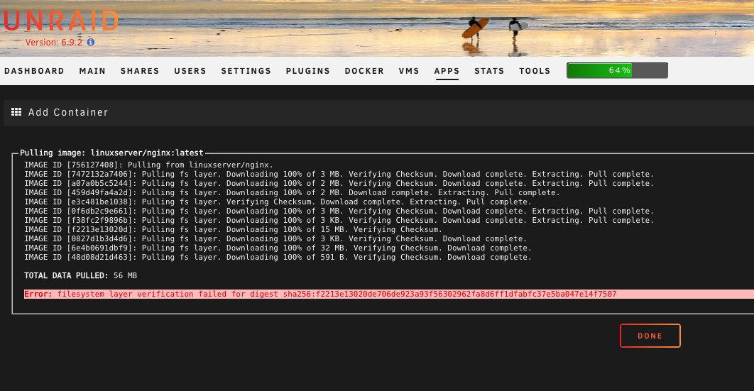

July 12, 20215 yr Hello team! I was using some dockers, like nginx, transmission and machinaris... First issue started when I tried to update machinaris, I did it and the docker disappear. I restarted the System, but still without the docker... I said, ok, maybe I touch the incorrect buttom... Next day, I tried to update the nginx and transmission and I get same error in both (next image), I read a few threads, and in some cases said that deleting and restarting solves the issue, tried and nothing happened. Now, I cant install any docker. I get the same error that I commented. Here is: Error: filesystem layer verification failed for digest sha256:f2213e13020de706de923a93f56302962fa8d6ff1dfabfc37e5ba04xxxxx I attached 2 images, from differents dockers, the error is the same in both... and with any docker! Diagnostics attached too. Can someone help me please? Thanks in advance!! unraid-server-diagnostics-20210712-1859.zip
