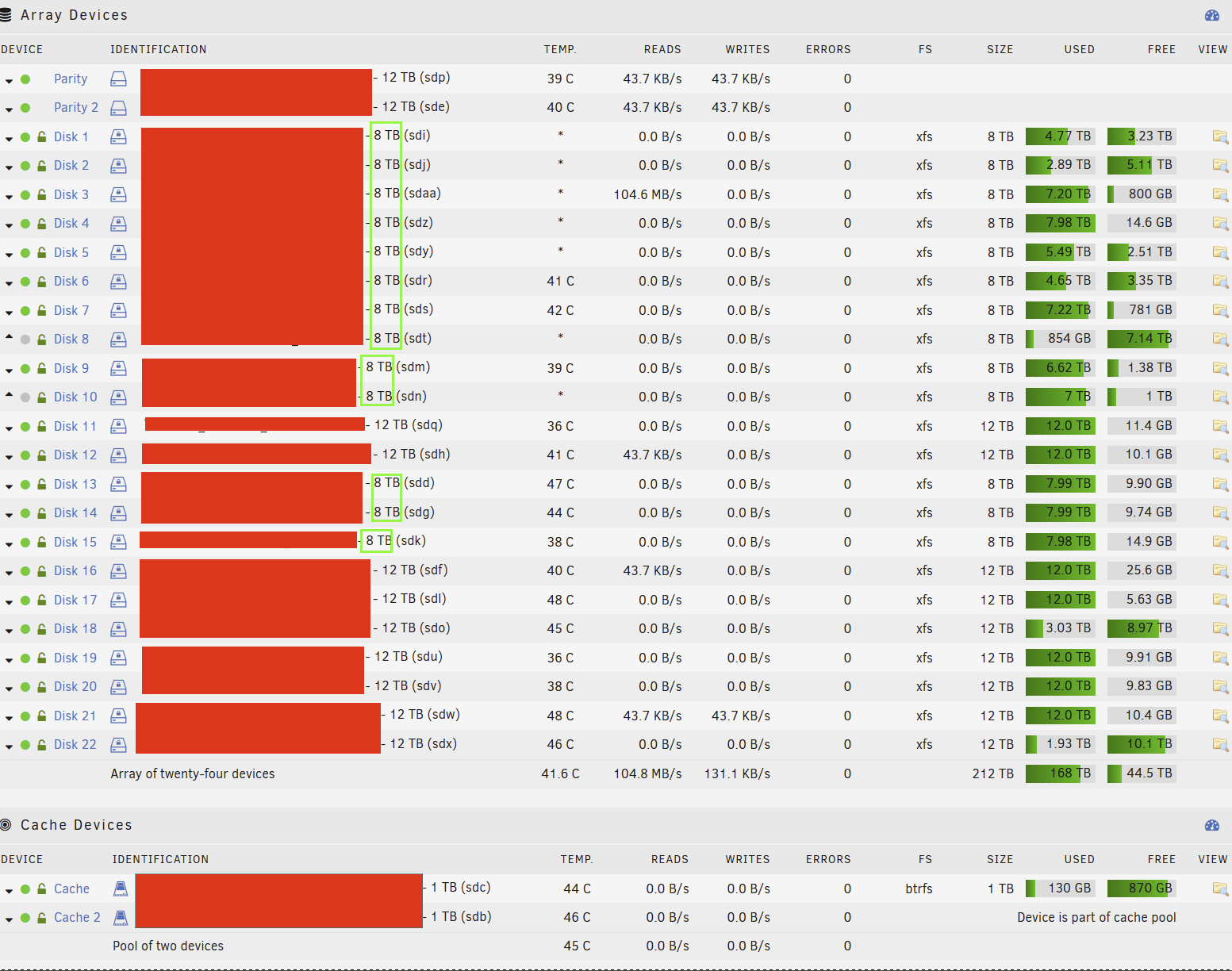

My disk order will become sort of messy once i remove 13 8tb drives from the array, as you can see in the picture below:
What would be the best way to go about re-arranging the disk order? As i understand if i don't want gaps in my disk order i have to do a full parity re-sync first with the old disk order, then i can re-arrange the drives and fix the order so i don't have a massive gap, but due to to me having double parity i will have to do a full re-sync once again?
As i understand the second parity drive will not be valid if i change the disk order, but how can i only re-build the parity of the second parity drive so i can keep the protection from at least 1 parity during the disk order reassignment?
This is obviously not a super important thing, but it would be nice to keep things tidy as i don't plan to grow the array more once this operation has been done, so having massive gaps in the order will look messy.
Edited by je82
You are already going to do a parity sync, just assign the disks in the positions you want before doing it.
So i can assign the disks as i see fit directly at step 6? Only the parity assignments need to be correct so the parity is written to the correct drives, i think i understand, thanks for all the information.
Edited by je82
Yes, the main danger here would be assigning a data disk to a parity slot, since those would be overwritten at array start, but if you leave parity disks assigned no reason to do that.

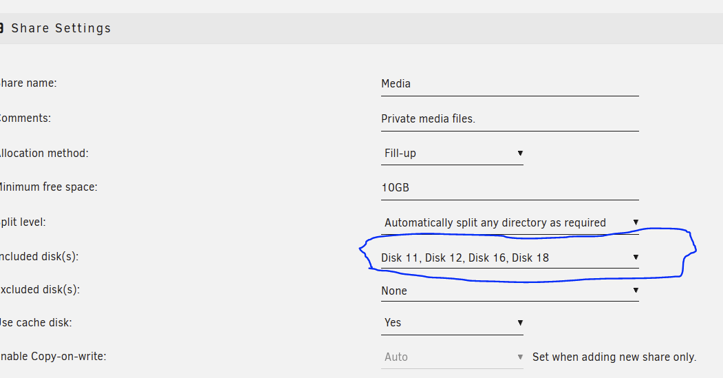

Sorry for bumping this thread again, i came to think of something i really don't feel comfortable doing without testing it first on a test build, but i cannot find the zip package for unraid version 6.7.2, is there any chance someone knows where i can find this package?
The thing i want to test is what happens to a share i have on the server and i change the disk location. Is shares that have allocated disks allocated on "per slot basis" or per disk unique identifier basis? If they are per slot basis, what happens when i change the order of the disks and the share is allocated to now paths that no longer exists?
These allocations would not be the same if i change the order, what happens to this share?
This is probably easier for me to try on my own than anyone answering it because its a very strange usecase, so the TLDR is, where can i find 6.7.2? This is the version i have on my unraid production server.
Cheers!
EDIT: Found version 6.7.1 via waybackmachine for whatever reason 6.7.2 seems to never have been posted to the ofifical releases page as it went from 6.7.1 to 6.8.x :( but 6.7.1 is better than nothing, ill do my own tests to see how unraid behaves when having a share and swapping the order of the drives around.
Edited by je82
Disks are allocated using their serial numbers and where they are connected is not relevant (unless it somehow results in presenting a different serial number to UnRaid)
Okay, i am surprised by the "where they are located" are we talking about physically?
I intend to move things psyically too, i never though this had any matter at all though.
EDIT: Ignore my question, i am ot of coffee and i somehow read that it mattered where the drivers were connected psyically, i have no idea why, sorry. As long as disks are using the unique ID all should be fine!
Edited by je82
