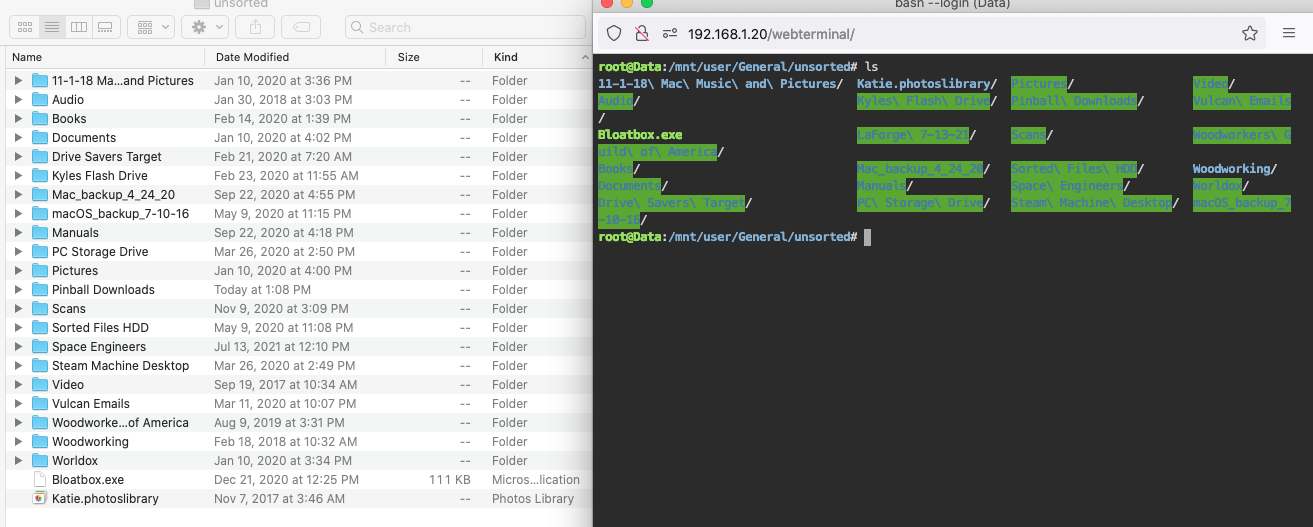

July 13, 20215 yr Hey guys, I made a mistake in my robocopy command transferring data from my computer to my Unraid server over the network. robocopy E: "\\data\general\unsorted\Laforge 7-13-21" The share is actually General (capital G), but robocopy reports that the copy was successful and if I try to create a new folder via the file explorer in ..\General\unsorted, it states that the folder already exists, even though it doesn't show it. CMD in windows and MC in Unraid don't show ...\general at all. I feel like I've done this before but I can't recall what the solution ended up being. Additionally, I noticed that one of my drives is emulated at the moment. Not sure if that is related or not. Not exactly sure what to do here. I can easily copy the files into the correct directory from the computer again, but do I need to free up the space or move the files from this ghost directory? Is this related to the emulated drive and fixing that may fix this? I'm running a read-check now. I don't think it's the drive, I think it's crappy hardware. EDIT: I found the "ghost" folder in /mnt/disk2/General/unsorted. It is also showing in MC in /mnt/user/General/unsorted. What is the correct way to fix this? Delete the directory on the disk and recopy it from the computer to the share? Can I use a move or rename command to move it from the user or disk to a new directory in the correct share? Edited July 13, 20215 yr by Jhorts New info

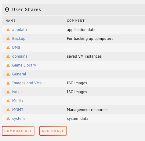

July 15, 20215 yr Community Expert You can send syslog to a syslog server, and syslog is where I would have looked to see I/O errors when they occurred. https://wiki.unraid.net/Manual/Troubleshooting#Persistent_Logs_.28Syslog_server.29 As mentioned, I didn't see any "general" share in your diagnostics. Go to Shares - User Shares and post a screenshot.
July 16, 20215 yr Community Expert As you can see in that screenshot, there is no "general" share, only "General". Do you have something you can show me to demonstrate why you think there is something named "general"?

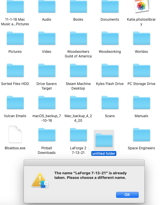

July 16, 20215 yr Author Thanks for the continued help trurl. I guess the issue really comes down to what's going on with the LaForge folder? On the left is SMB and the right is a terminal inside Unraid, inside the "user" directory.

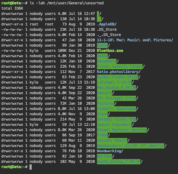

July 17, 20215 yr Community Expert From the command line, what do you get with this? ls -lah /mnt/user/General/unsorted
July 17, 20215 yr Community Expert That looks OK and since I have no experience with Mac I don't know why it won't show that folder

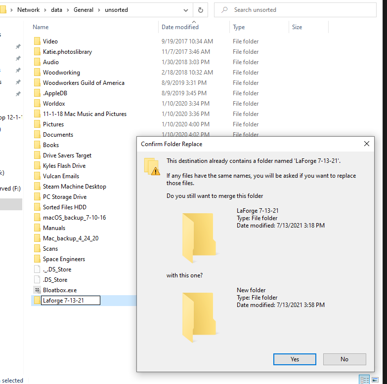

July 17, 20215 yr Author It does not. The only place it shows up is on the terminal or MC on Unraid, and previously via AFP protocol. I just updated, so now AFP is not an option or I would show you. But if I try to create a folder in that directory with the same name from my PC, it says it already exists and prompts for a merge. I did that and it still didn’t show. Edited July 17, 20215 yr by Jhorts

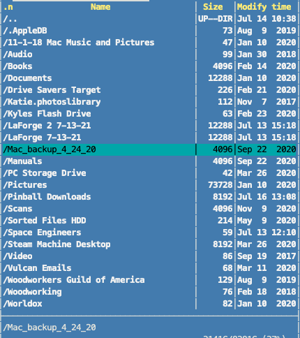

July 17, 20215 yr Author I copied the contents of the folder to a new folder, and the new folder shows in SMB correctly. MC shows both folders and if I try to create a folder in SMB with the same name as the original, it says it already exists. LaForge 7-13-21 is the original ghost folder, LaForge 2 7-13-21 is the copied folder.
July 17, 20215 yr 38 minutes ago, Jhorts said: I copied the contents of the folder to a new folder, 3 hours ago, jonathanm said: What happens if you rename the folder in MC?
July 17, 20215 yr Author Renamed the folder to "NOT_LaForge 7-13-21" in MC and the situation didn't change. MC shows "NOT_LaForge 7-13-21" but SMB doesn't and won't let me create a folder called "NOT_LaForge 7-13-21" because it already exists.

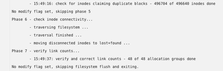

July 17, 20215 yr Author File system check on disk 2 complete, now what? Restart the array and see if it's there?
July 17, 20215 yr Community Expert 23 minutes ago, Jhorts said: File system check on disk 2 complete, now what? Restart the array and see if it's there? You need to run without the -n flag or no corrections are ever made. I wonder if there us some hidden (unprintable) character in the name of the folder (or a file it contains) and that is upsetting Sambz.
