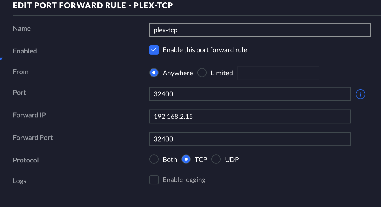

I forwarded port 32400 TCP in my ubiquity router.   192.168.xxx.xxx:32400 address of my unraid server static IP
I added a host port 1 32400 to the docker

By chance, do you have geolocation filtering on? If so, allow Ireland through. Plex remote/proxy servers are located there and for whatever reason it needs to be able to communicate with them.
My Plex rule:
Edited by mfwade
My Plex rule:
I'll try this tonight when i get home.
Also could it be that i have port forwarding and UPnP running... could i remove my port forwarding.
My Plex rule:
Yes its from Any....

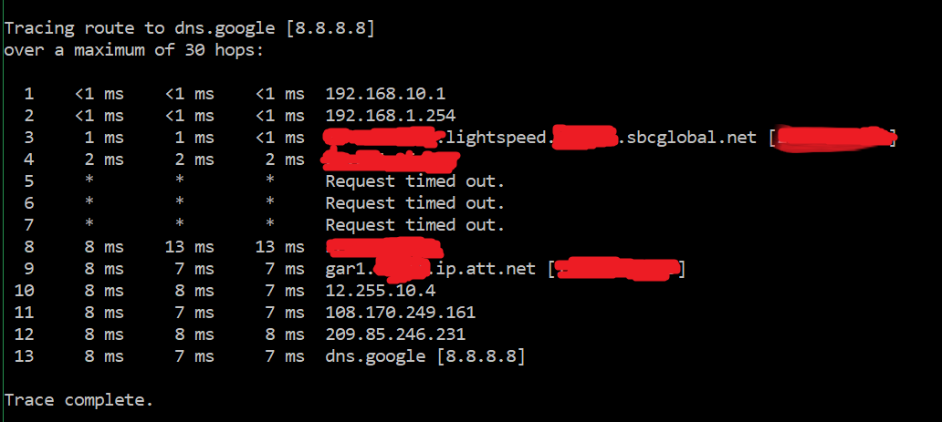

Nope i think my issue is a double NAT, my router and ATT's fiber router.... maybe i can find a way to plug ATT fiber into my SFP+ port.....
Ah, that could cause issues. Did you pass through 32400 from the ATT device to the Unifi? Since I dont know what you have, in theory you should be able to directly connect the fiber into the Unifi device - provided you have the correct singlemode or multimode SFP / SFP+. You would then need to simply set DHCP or manually assign the IP.
As I stated, i dont know what ATT brings to the table with ther device so some things may break (like in the Verizon FIOS world).

I told ATT to bridge the fiber directly to my ubiquiti dream machine pro mac address. So i don't know if i can still log into it and do that or not. It seems a lot of people complain about ATT bridges and double NATs.
Ill plug my laptop into it tonight and see what i can mess around with.

I was able to get into the ATT router and try port forwarding to my uni pro address, and seems to be working off and on right now... But much better
I just ran a tracert command to google and umm can someone explain the amount of hops.. they all seem like ATT internal ones and it bounces all over the place, from California to Atlanta and back....
