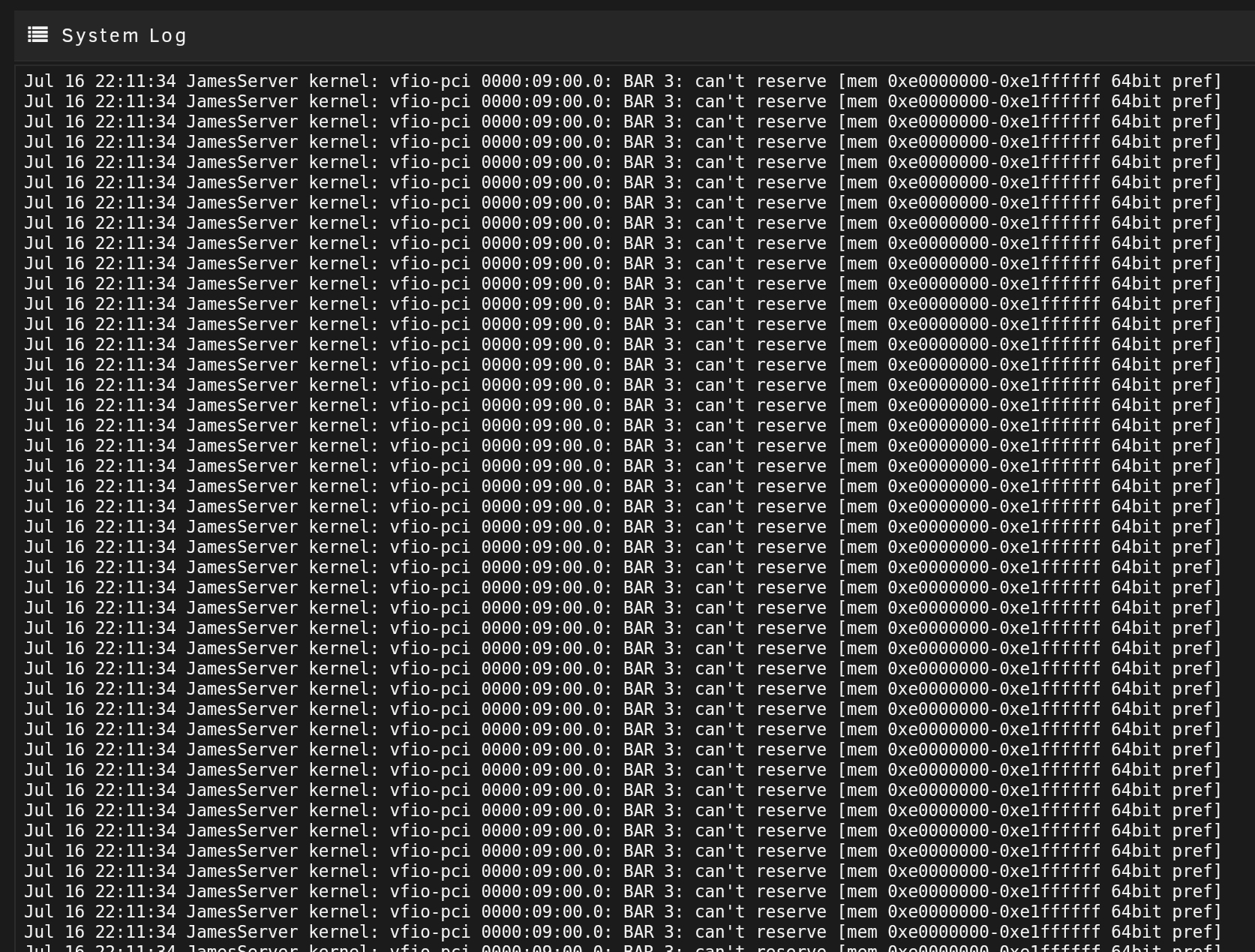

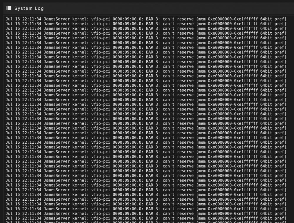

Now after crash i have this
Jul 16 23:43:23 JamesServer kernel: vfio-pci 0000:09:00.0: vfio_bar_restore: reset recovery - restoring BARs
Jul 16 23:43:55 JamesServer kernel: vfio-pci 0000:09:00.0: vfio_bar_restore: reset recovery - restoring BARs
