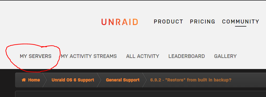

What I would do :
Go to My Servers at the top of the page :

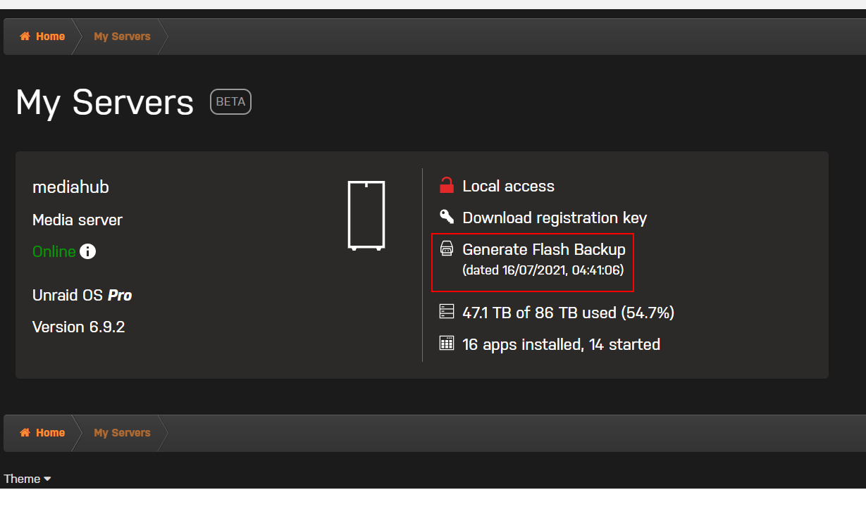

Then generate backup
wait a bit .... download
Backup manually the content of your flashdrive.
Run a checkdisk on the drive.
copy the content of the zip on your flash drive
And just in case, run the applicable make bootable script.
https://wiki.unraid.net/Articles/Getting_Started#Manual_Method_.28Legacy.29
You should be good for the drive.
