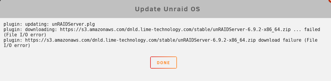

Hello, I tried updating my unraid version, but received the following error below during a download update, does this mean my usb drive has a read/write error failure?  Or should I reformat the usb drive, install the key and then update to the latest version.
Error message:
plugin: updating: unRAIDServer.plg
plugin: downloading: https://s3.amazonaws.com/dnld.lime-technology.com/stable/unRAIDServer-6.9.2-x86_64.zip ... failed (File I/O error)
plugin: https://s3.amazonaws.com/dnld.lime-technology.com/stable/unRAIDServer-6.9.2-x86_64.zip download failure (File I/O error)

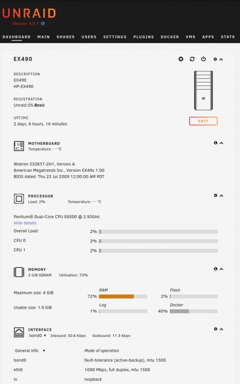

Also to answer the other question:

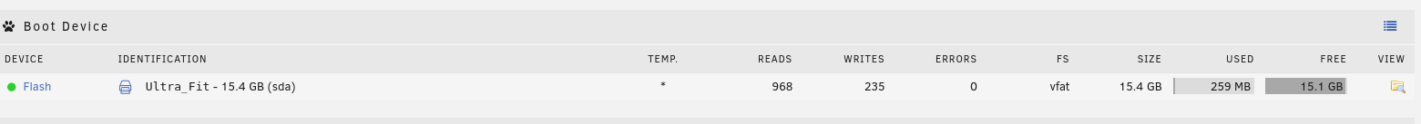

My flash drive is a Sandisk FlashUltra_Fit - 15.4 GB (sda)

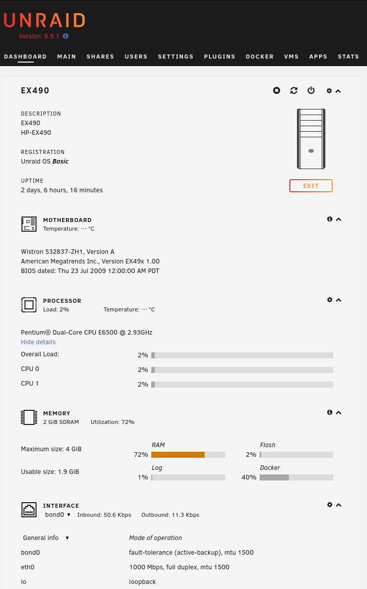

The current space on the drive is (see attached screenshot)
I am running on unRaid Server on the following hardware (HP Server EX490)
ex490-diagnostics-20210719-2029.zip

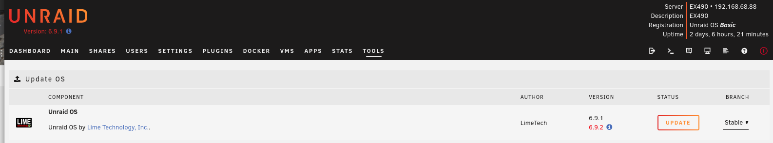

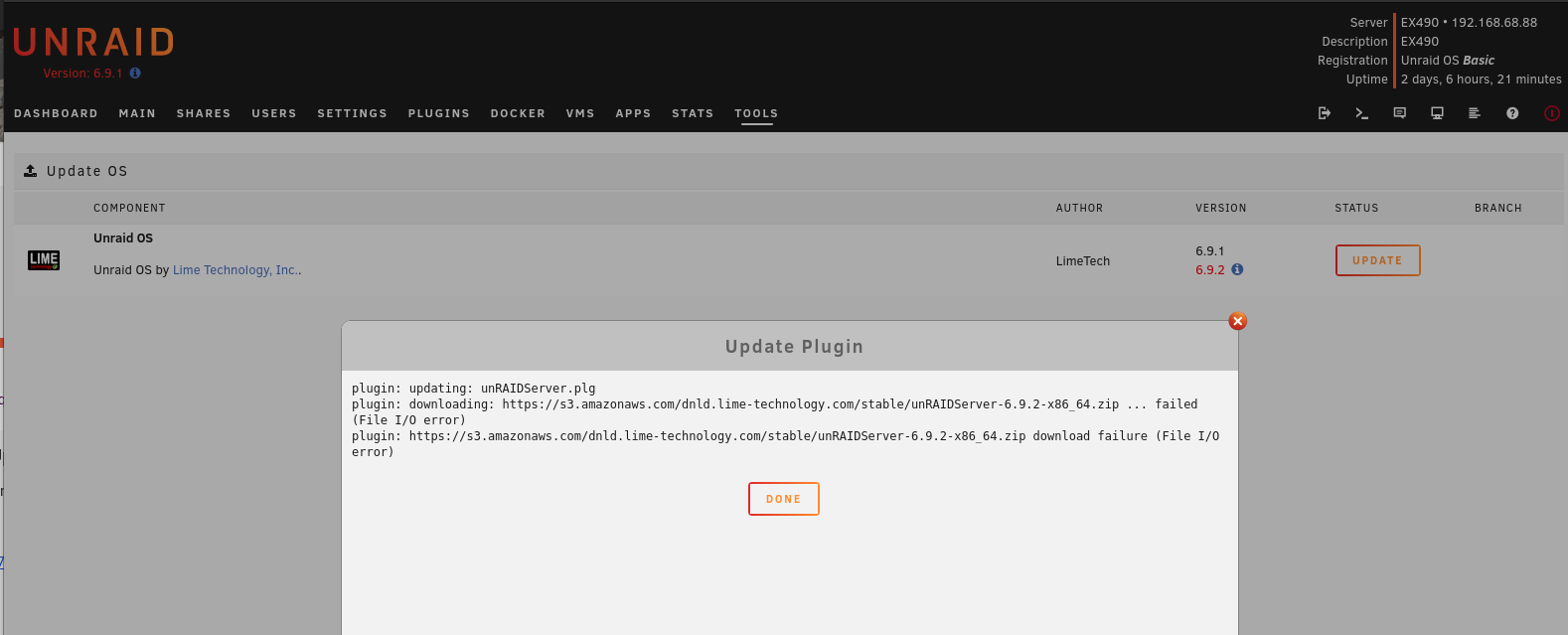

Update:  I tried to do another update at this time, and still got the following error.  I have two other servers, with no issues on the updates.
Ok, you probably do not have enough RAM to make the update through the GUI. The update downloads and unpack the zip to RAM, with so little available, it is an issue some time.
You should try to update manually.
