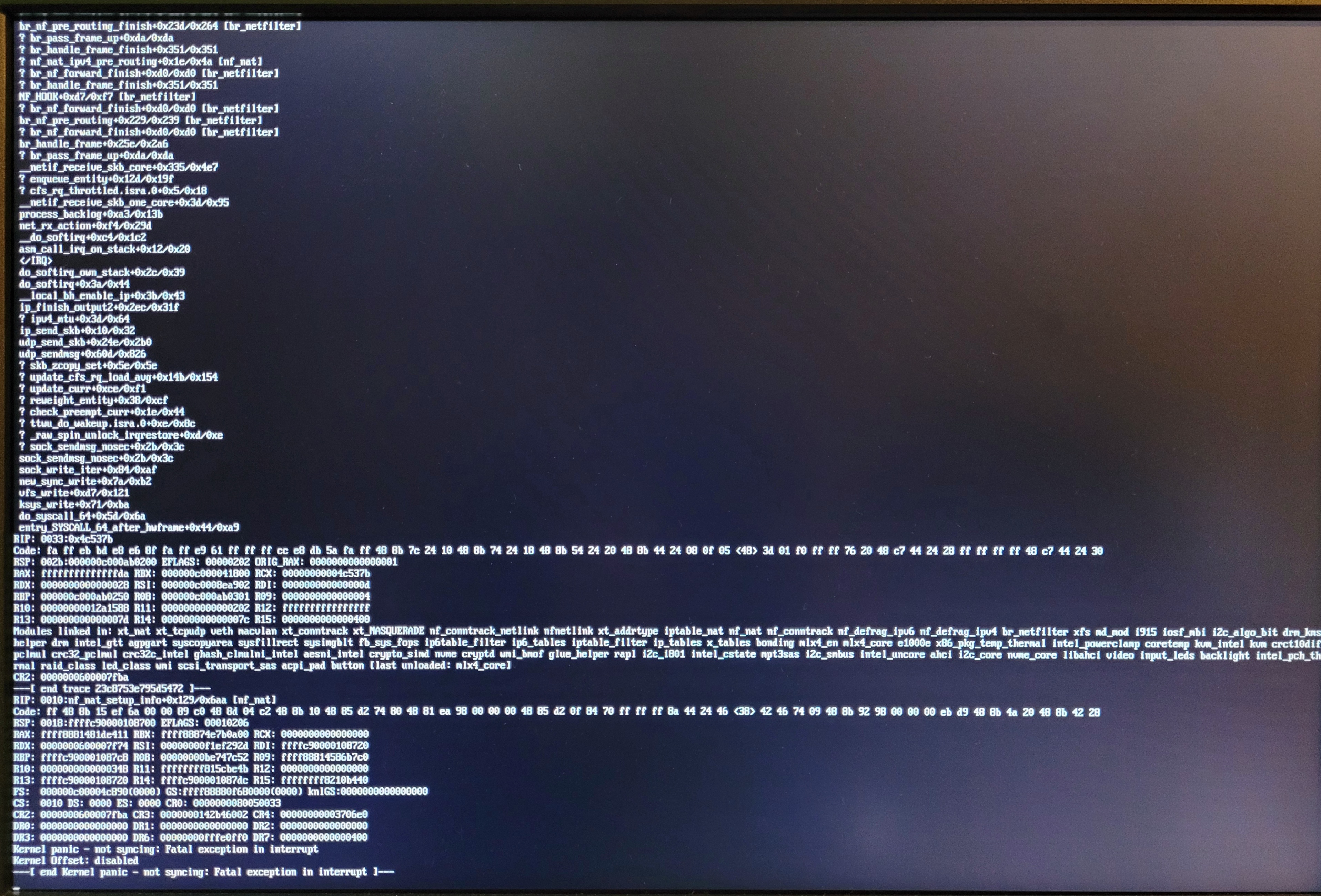

July 26, 20215 yr Author After a few days of running pretty stable. This morning. It froze again. This time there is video display (probably in the video buffer) right before it froze. syslog_0726_1045.txt neo-diagnostics-20210726-1051.zip Edited July 26, 20215 yr by jena Add log
July 26, 20215 yr Community Expert See if this applies to you: https://forums.unraid.net/topic/70529-650-call-traces-when-assigning-ip-address-to-docker-containers/ See also here: https://forums.unraid.net/bug-reports/stable-releases/690691-kernel-panic-due-to-netfilter-nf_nat_setup_info-docker-static-ip-macvlan-r1356/
July 26, 20215 yr Author 14 minutes ago, JorgeB said: See if this applies to you: https://forums.unraid.net/topic/70529-650-call-traces-when-assigning-ip-address-to-docker-containers/ See also here: https://forums.unraid.net/bug-reports/stable-releases/690691-kernel-panic-due-to-netfilter-nf_nat_setup_info-docker-static-ip-macvlan-r1356/ Thank you very much. I also just attached syslog in my last reply. Could you help to take a look?
July 26, 20215 yr Community Expert 2 minutes ago, jena said: Could you help to take a look? Yes, syslog also points to that issue: Jul 18 14:37:14 Neo kernel: macvlan_broadcast+0x10e/0x13c [macvlan] Jul 18 14:37:14 Neo kernel: macvlan_process_broadcast+0xf8/0x143 [macvlan]
July 26, 20215 yr Author 1 minute ago, JorgeB said: Yes, syslog also points to that issue: Jul 18 14:37:14 Neo kernel: macvlan_broadcast+0x10e/0x13c [macvlan] Jul 18 14:37:14 Neo kernel: macvlan_process_broadcast+0xf8/0x143 [macvlan] Great. A relief for me finally. Thank you so much.

August 4, 20215 yr Author Crashed again today. on July 27, I followed the third option: "Keep docker containers in host or bridge mode which use the server IP address and ports as needed" I changed all dockers to host or bridge mode. Turned off "AdGuard" because it cannot run under host or bridge mode and disabled auto start. My unraid ran for a week and crashed again (same symptom, no response) last night. I attached the syslog. Please start from July 27, the day that I rebooted and made the change. syslog_20210803.txt Edited August 4, 20215 yr by jena
August 4, 20215 yr Community Expert Still a lot of network related crashes, if you haven't yet try this: https://forums.unraid.net/bug-reports/stable-releases/690691-kernel-panic-due-to-netfilter-nf_nat_setup_info-docker-static-ip-macvlan-r1356/?do=findComment&comment=14530
