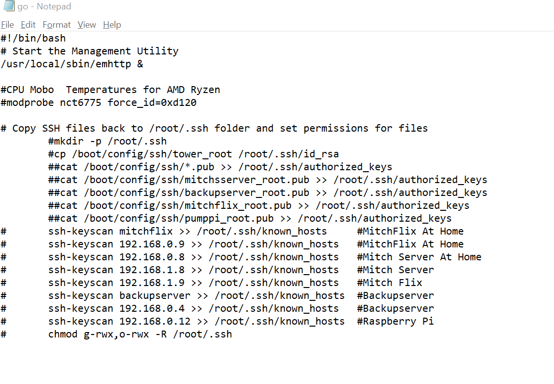

having issues using ssh keys between servers
in the past i used to have the go file  do the mkdir  and chmod and the cat >>authorized keys or what not
then the latest version of unraid told me not to do that anymore in fix common fixes.. and i remmed out all that code
and for the longest time it still worked between reboots
but now i noticed  with user scripts  the rsync between servers is broken.. when i shell it i have to do the authorization
i thought i should no longer have problems as long as the keys are in the flash's  .ssh folder
but it doesnt work?
so what should i do ti get it up and running again with no issues
cuz i didnt understand the documentation  back then  i guess as long as its in the .ssh folder it should just copy over  and import on its own
but now it doesnt work and i wish there was a notification to say rysnc userscripts the connection between the servers are broken

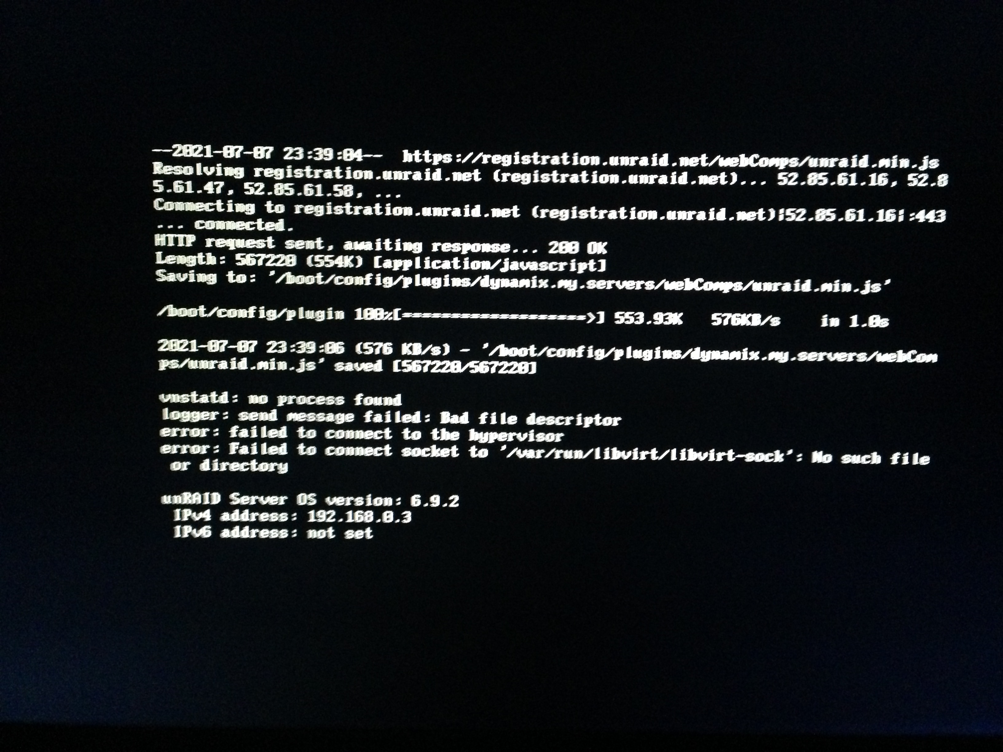

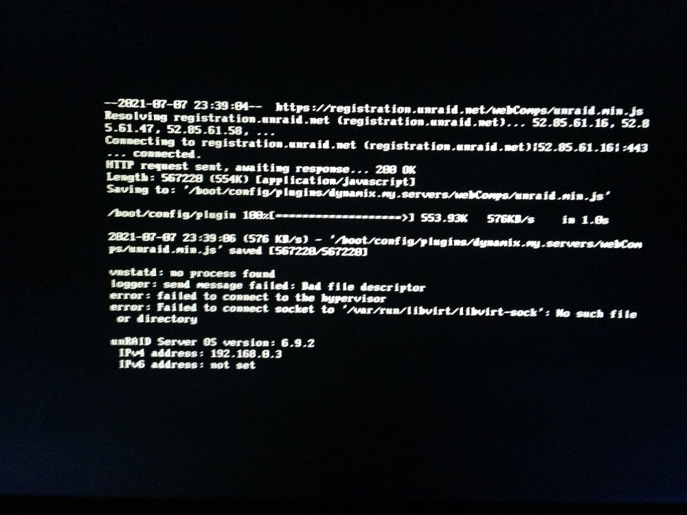

oh ok i know the Unraid My Servers plugin has caused me issues i forgot to uninstall it as it has made it before you cant boot up  unraid...  and the pluggin has disabled the Tower login..IMG_0444.thumb.JPG.6932de1eb82616686009a299126b51bf.JPG
when you boot into safe mode then what do you do?  ill have to replug in a video card.. its headless   unless i can boot into safe mode from  console?
and would removing the unraid plugin fix it
pics are from last week  but i ment to uninstall the plugin
ill probably uninstall it later today i not at home at the moment..
possibly this is the reason?
i just uninstalled the my servers plugin..   and just rebooted  unraid  i need to plug a video card in to be able to change to safe mode

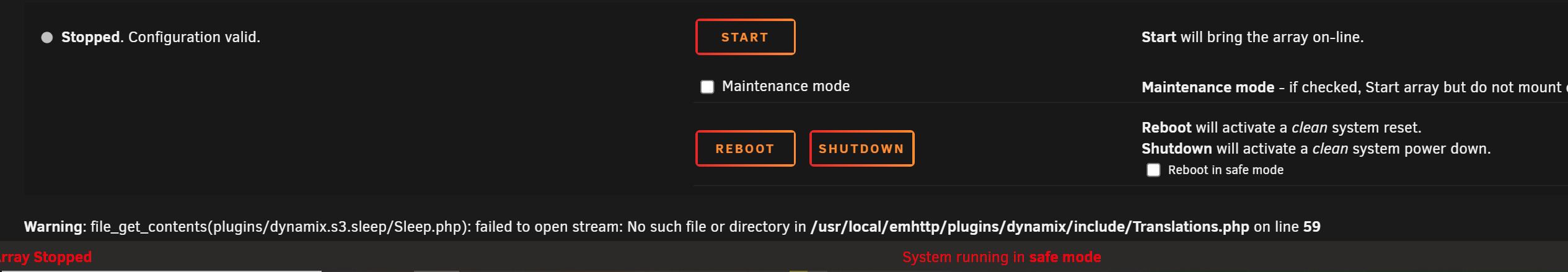

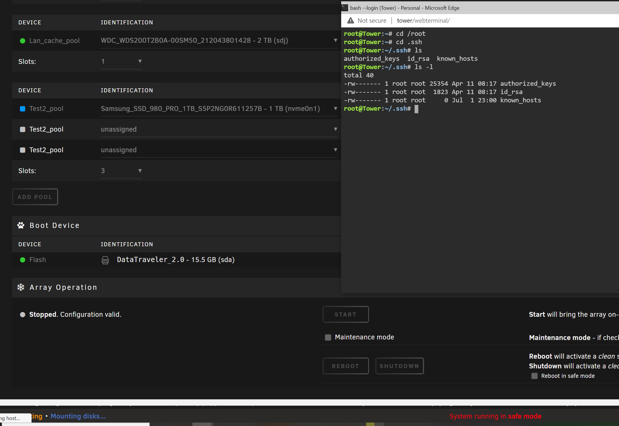

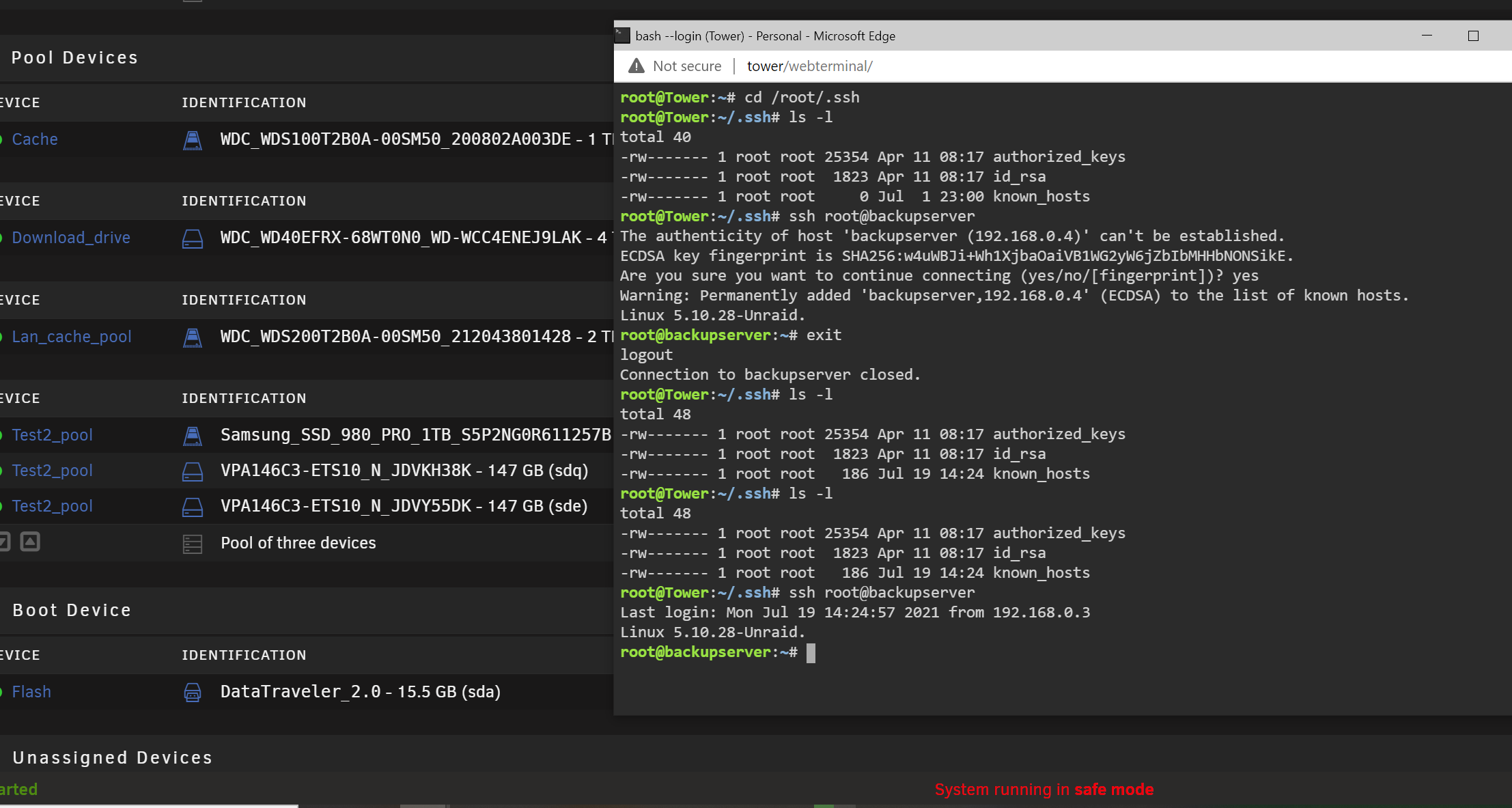

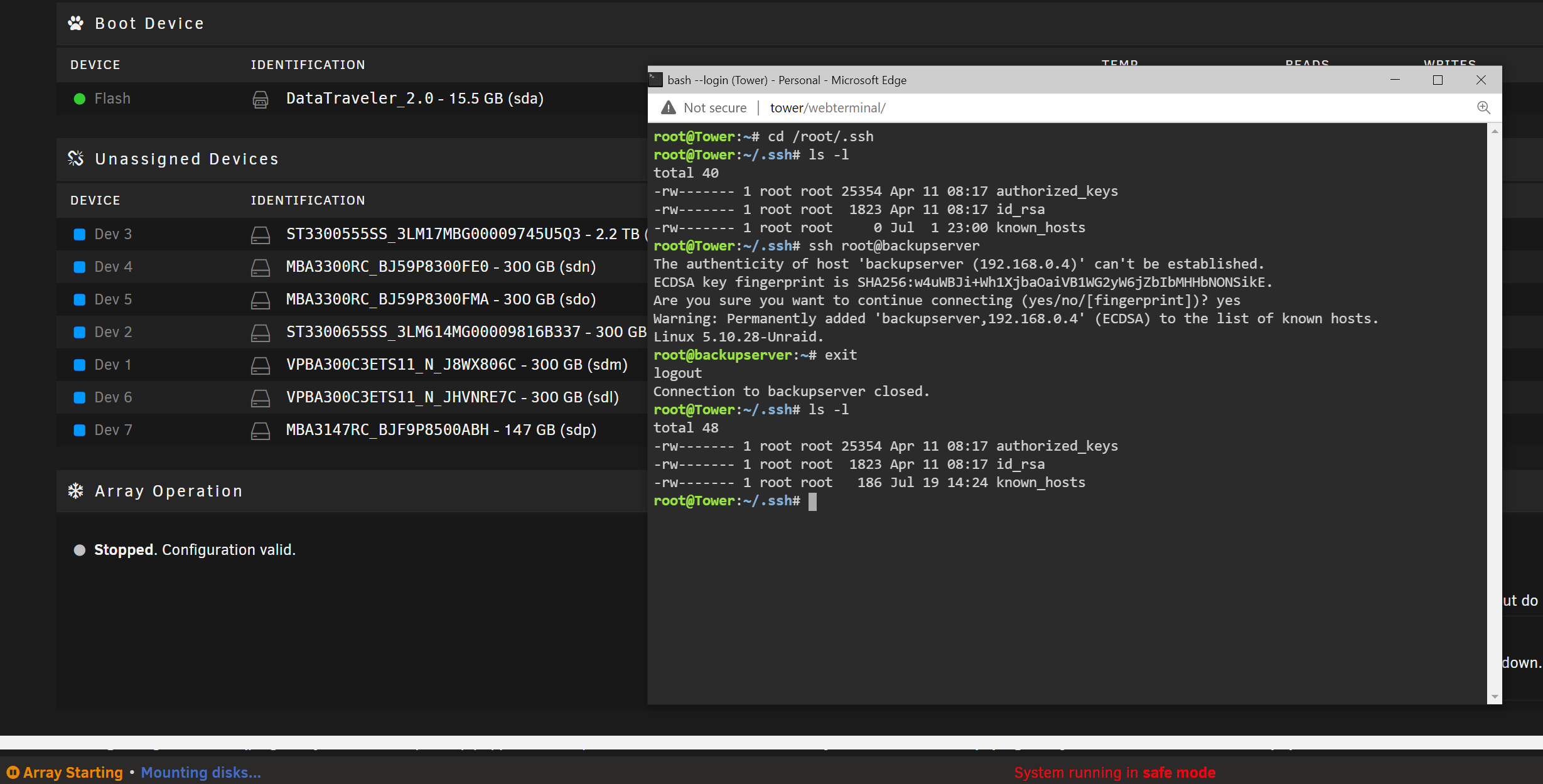

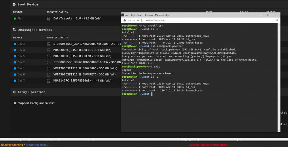

so i booted into safe mode.. i did the gui  no plugins..  it gives me a login.

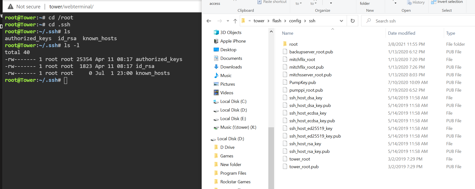

i used my windows machine and ran the terminal...  went into root/.ssh   folder  and no other things there other then what you see..  i tried to ssh root@backupserver   but asked for that finger print thing and said host failed..
i reboot tower.. and i still have no login for the main server..
but able to access the gui still..
so here some pics and a diagnostic..  maybe it can tell you.

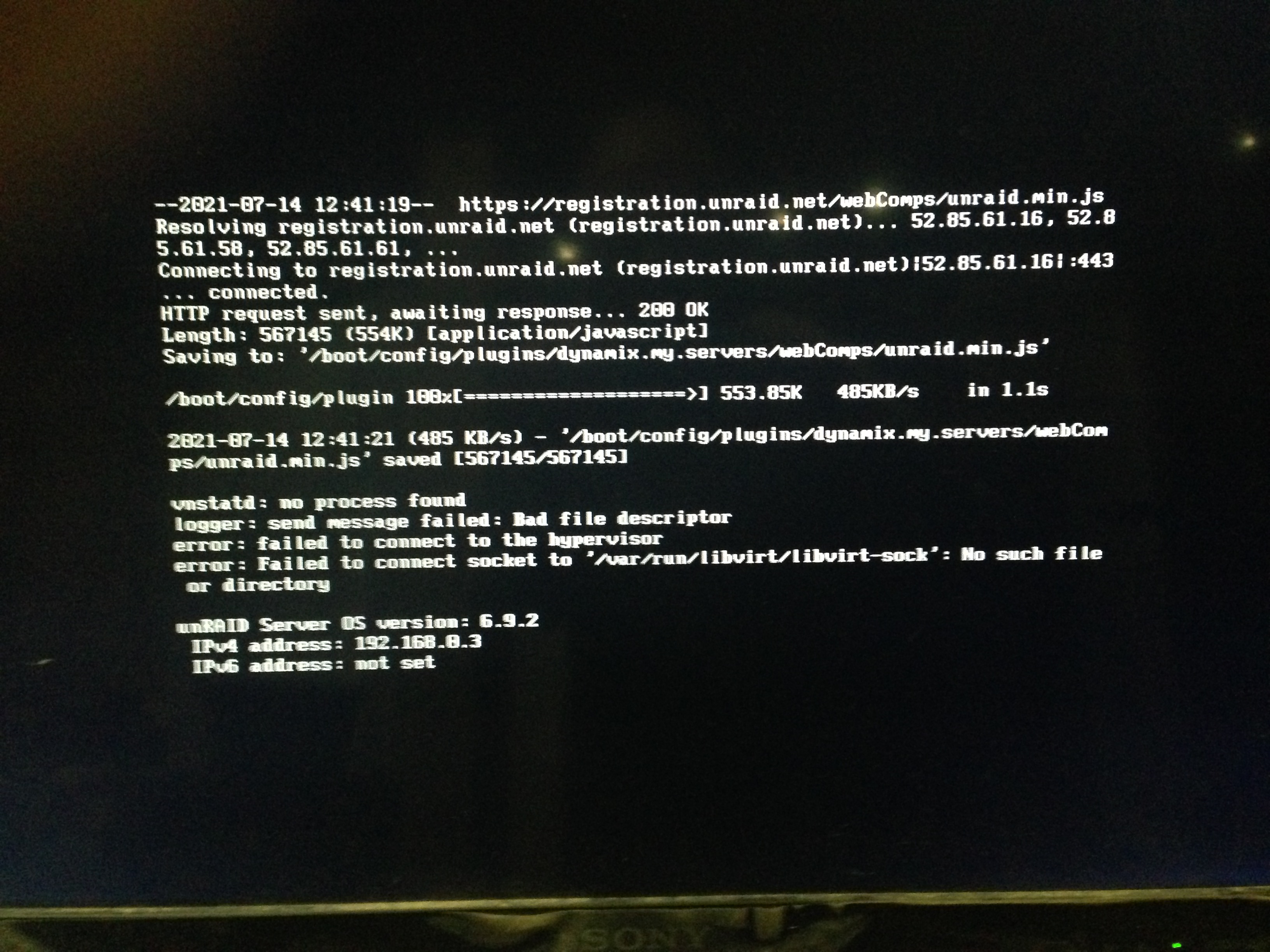

the last 2 photos are from other day.. just before i uninstalled the unraids my server plugin
you can see there also i do not have a login anymore

No, and it's not clear to me after reading your post if pass-wordless SSH started working in safe mode, did it?

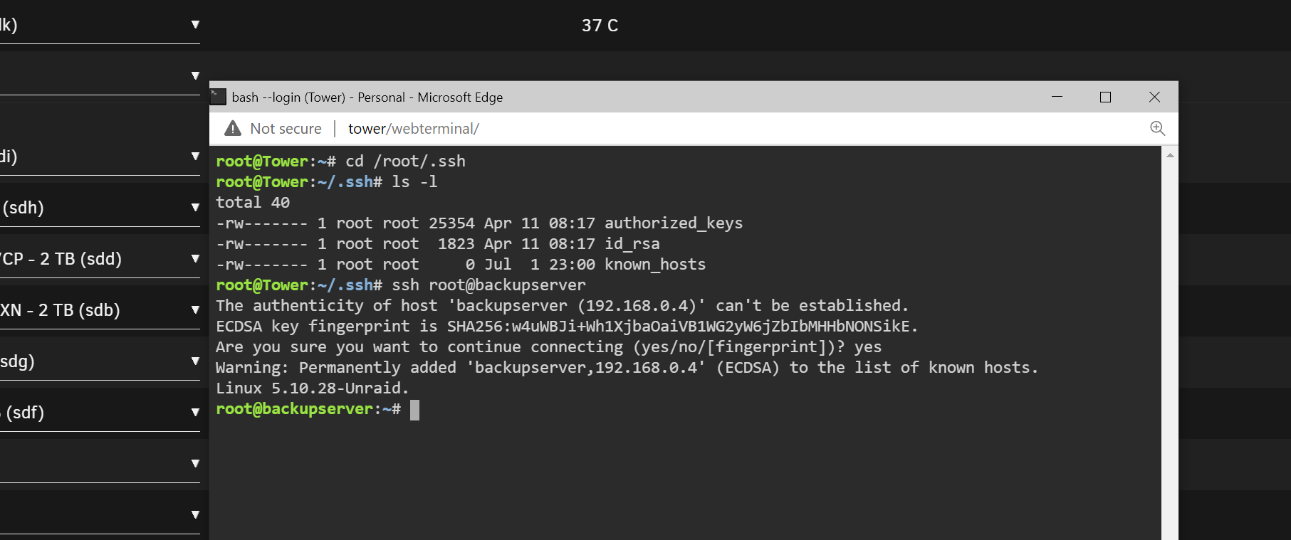

no  i..  i went to shell
i typed
it asked for your fingerprint i typed yes
it said
host failed
Then it's not a plugin problem, you can create new keys and make sure all is correctly configured, IIRC we already went through this with you in another thread.

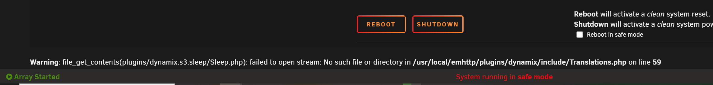

so i rebooted  back into  unradi safe mode

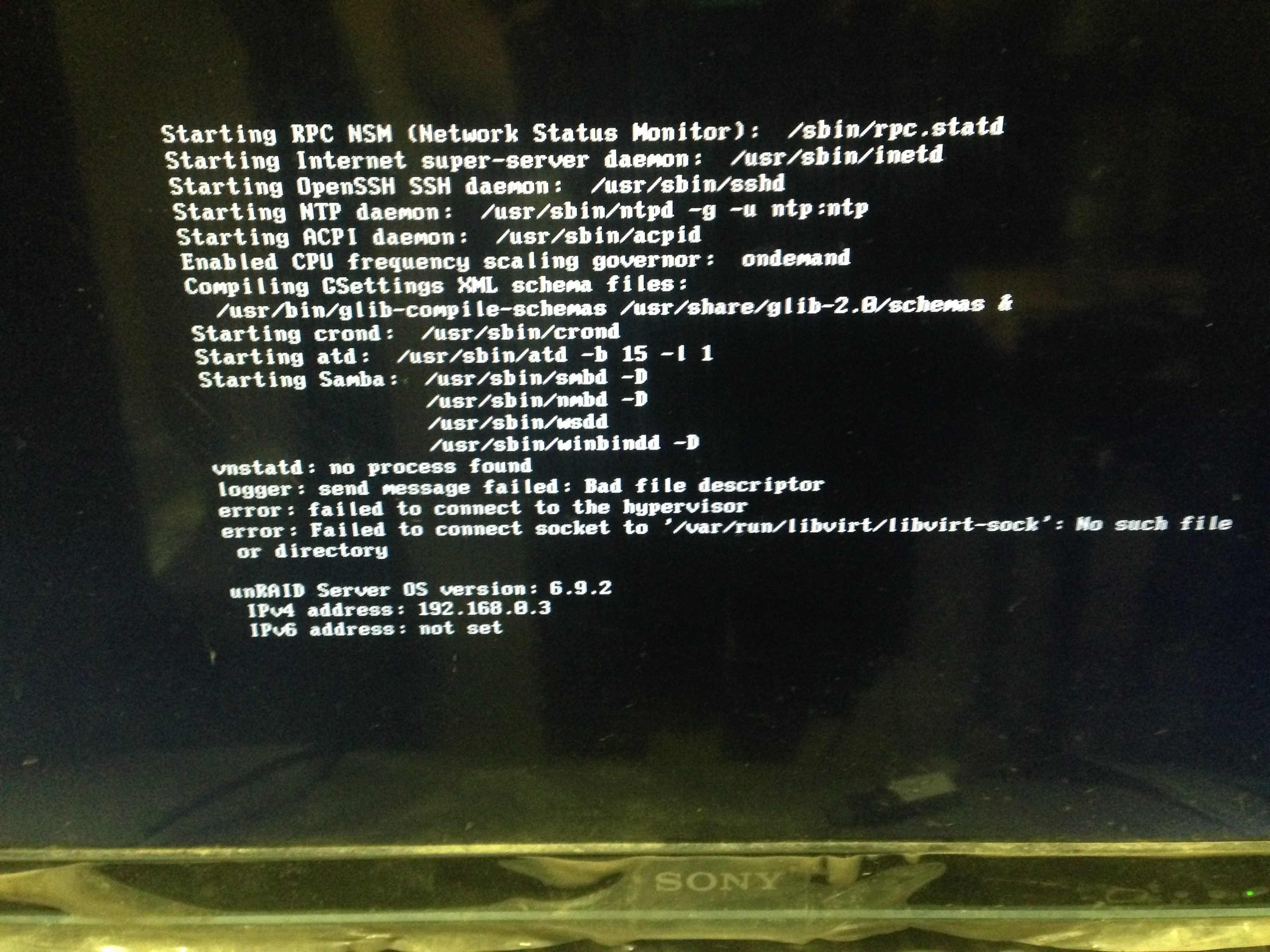

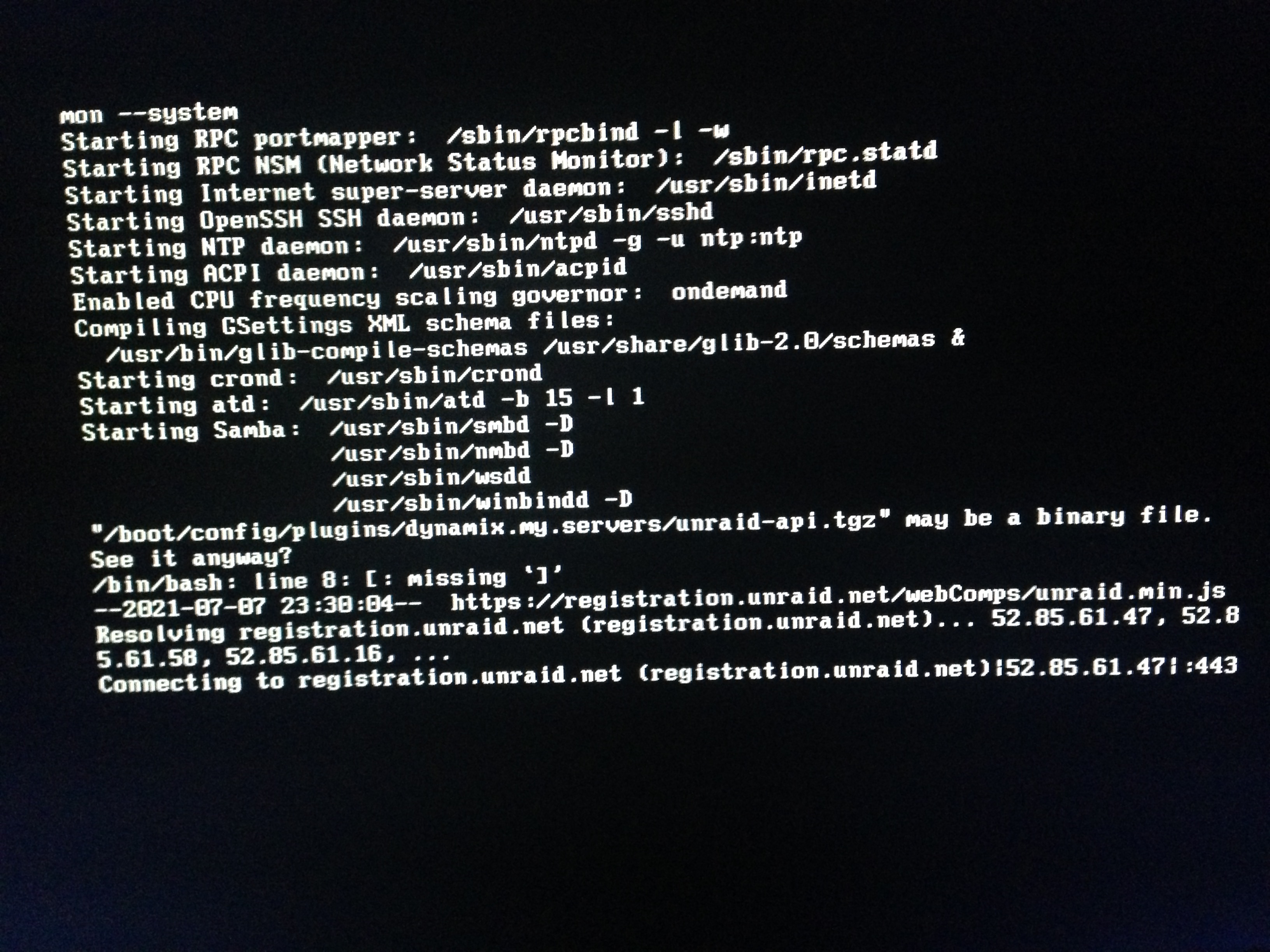

i get errors booting up  and it hangs alot

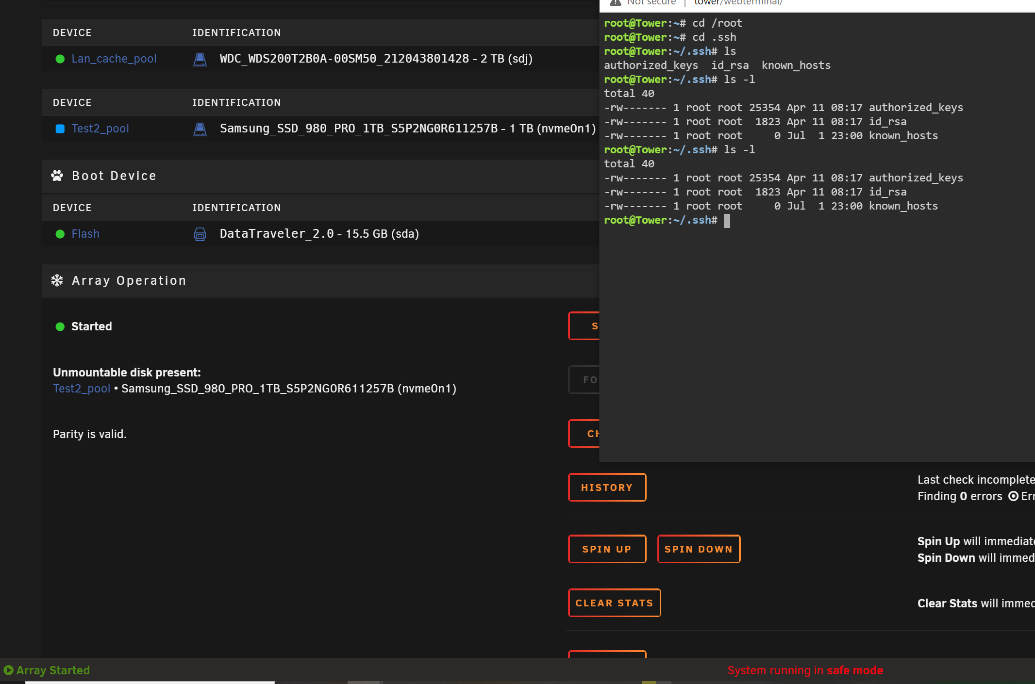

but you can see i had to recreate a key   as u see unraid isnt mkaing that known_hosts file
also last couple pics are when i reboot the unraid  it hangs
and like i mentioned above .. there is no longer a login
plus why is there an error for Plugins when it safe mode? its not supposed to be running plugins?

so i figureed it out which no one told me in my other post..  as no one is step by step detailed
you still gotta use the mkdir   you still gotta use chmod keyscan and cat..  but you only have to run it once..  then it saves it.. and unraid takes those saves to the flash so when you reboot all it does is copy that folder.....
if someone would have said all you gotta do is just re run those commands in my go file to import.. i wouldnt spent hours last night reboots  and such..
unraid docs should tell you that too.. when  unraid looses keys folder.. all you gotta do is run  mkdir,cat,keyscan,chmod, to restore it.. so keep a copy of your script..  dont toss it..
so least i figured it out trial and error  and figured id try it
