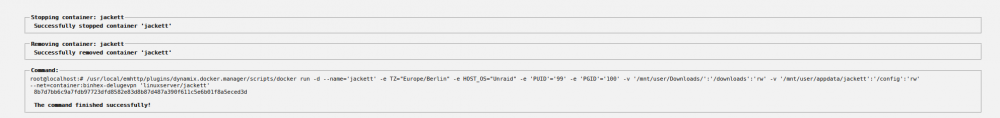

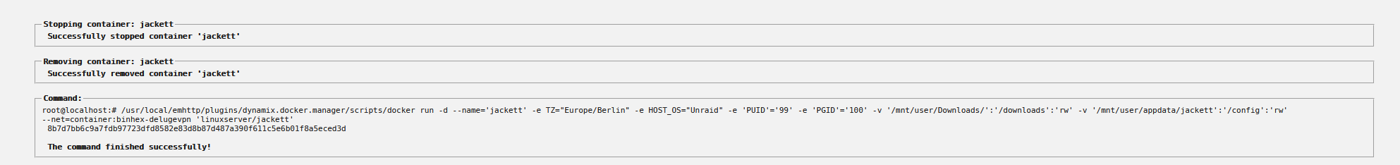

Here is the docker run from one of the dockers, which doesn't autostart (jackett):

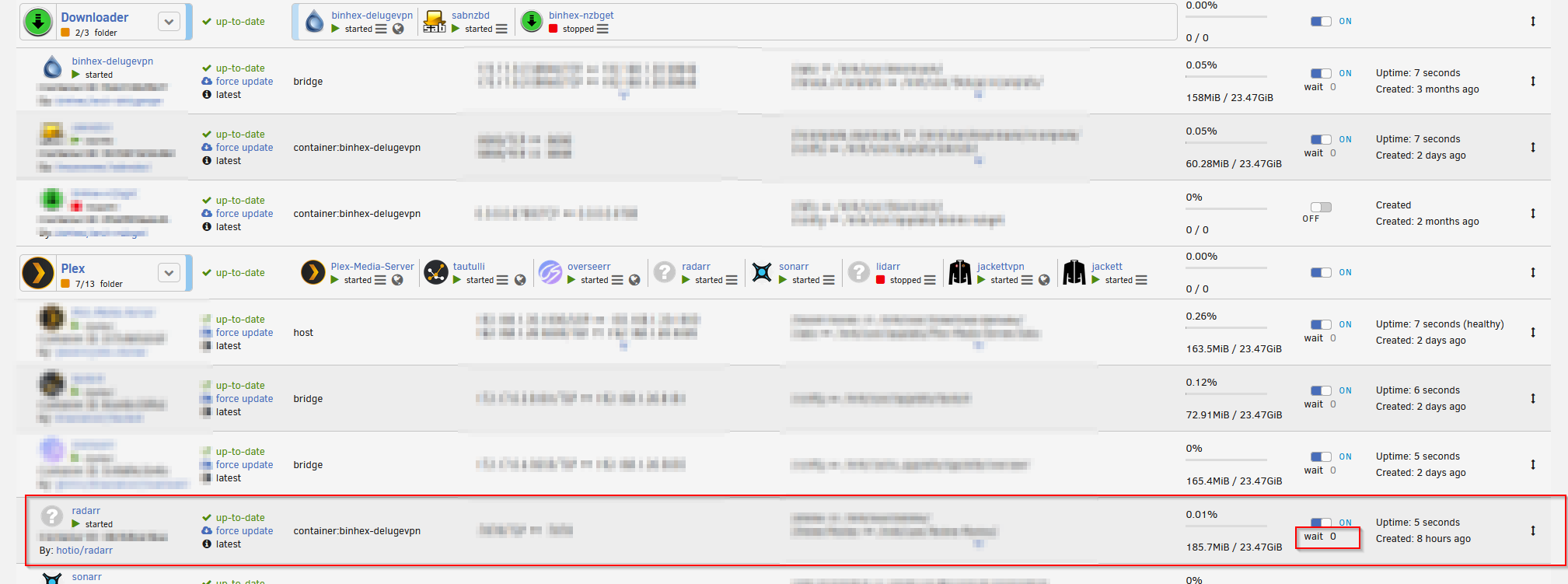

In addition, I have also tried to add a "wait" under advanced view for like 55-95 seconds. I thought that maybe they aren't autostarting because they are waiting for delugevpn to start, but it didn't help.
Edit: But for example sabnzbd which is also going trough delugevpn is autostarting correctly.

Where is jacket in relation to deluge in the order?  Sab starts because it starts after deluge.  If jacket is before deluge it will always fail.  Drag to rearrange the order

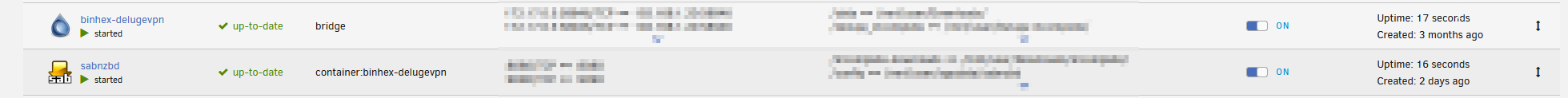

Woah, you are like a magician .. after I rearranged the docker folders, it worked ... so strange, as I thought that if I add a "wait" on the dockers itself, it would wait X seconds and then start, but rearranging did the trick for me (in this case I not only updated the SSD, but also added the docker folders, which caused the issues):

The wait indicates to wait x seconds before it carries on in the list starting.
No idea what you mean by that, but thanks anyway! At least I know now the rule to have such stuff at the top :)
It always goes down the list in order. You can set a delay for any container, and the container will wait that amount of time after the previous one starts before it tries to start.
