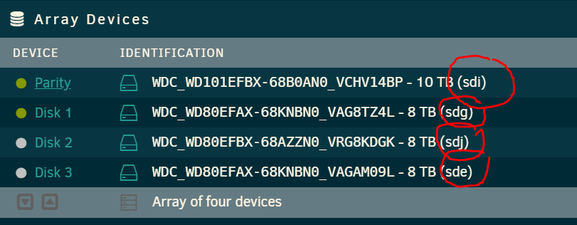

July 18, 20215 yr Hy After each boot the mount points for each disks are different. For the array this is not a problem but for one script that adjusts the Fans inside the server according to the temperature of each hdd. I read the temp etc by accessing the add via the mount point (sdi, deg etc.) But every reboot of the server I need to adjust the script to fit the new mounting points. Why are they always different and don't stay the same? How can I fix this? Edited July 19, 20215 yr by gekoch
July 18, 20215 yr Community Expert You can never assume that the /dev/sdX type device names will not changed as they are assigned dynamically by Linux during the boot process. If you want invariant names use something from the ‘dev/by-* family.
July 18, 20215 yr Author thx yes /dev/by- would be a solution however I can't se any "by-" devices... EDIT: ah sorry it was under "/dev/disk/by-" Edited July 18, 20215 yr by gekoch
July 18, 20215 yr Community Expert 23 minutes ago, gekoch said: thx yes /dev/by- would be a solution however I can't se any "by-" devices... EDIT: ah sorry it was under "/dev/disk/by-" Glad you found it despite my slightly incorrect path
