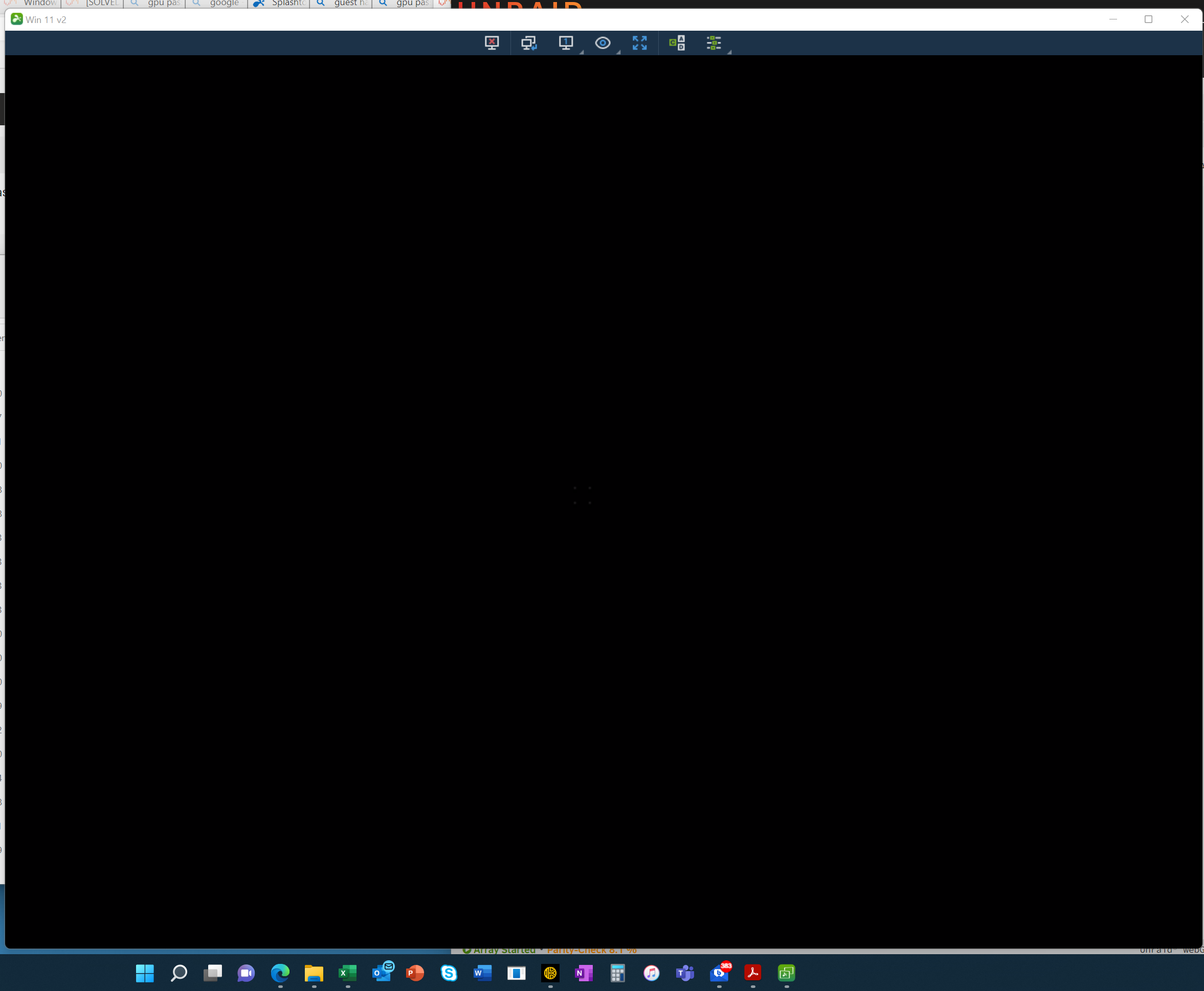

June 4, 20224 yr Hi ejss (or anyone else who might be able to help), Were you ever able to get your issue resolved? I'm having the same situation. I have a PNY RTX A4000 GPU I'm trying to pass through to a Windows VM. Like you, I've watched and followed all of the SpaceInvader videos but wind up in the same place - black screen with 4 white dots flashing in the middle. My hardware specs are as follows: CPU: Threadripper 3970 MoBo: ASUS Zenith Extreme Alpha II RAM: 128GB GPU 1: AMD Radeon Pro W5500 (slot GPU 2: Nvidia RTX A4000 So far, I've created the VM with VNC and it installed and booted up just fine. I added the virtio drivers (but left the display driver as the built-in Windows Basic Display). I installed Splashtop, shut down the VM and changed the graphics card to be the Nvidia card. I did load the vbios and the sound card from the GPU (following the instructions from the SpaceInvader video). I saved and then started the VM and got the aforementioned black screen with the four blinking dots. I've attached the log from the VM as well as a screenshot (if you look real close, you can see the four dots)! Any thoughts/insights would be greatly appreciated. Thanks in advance!! vmlog.txt Edited June 4, 20224 yr by atwillia009 Added a screenshot
