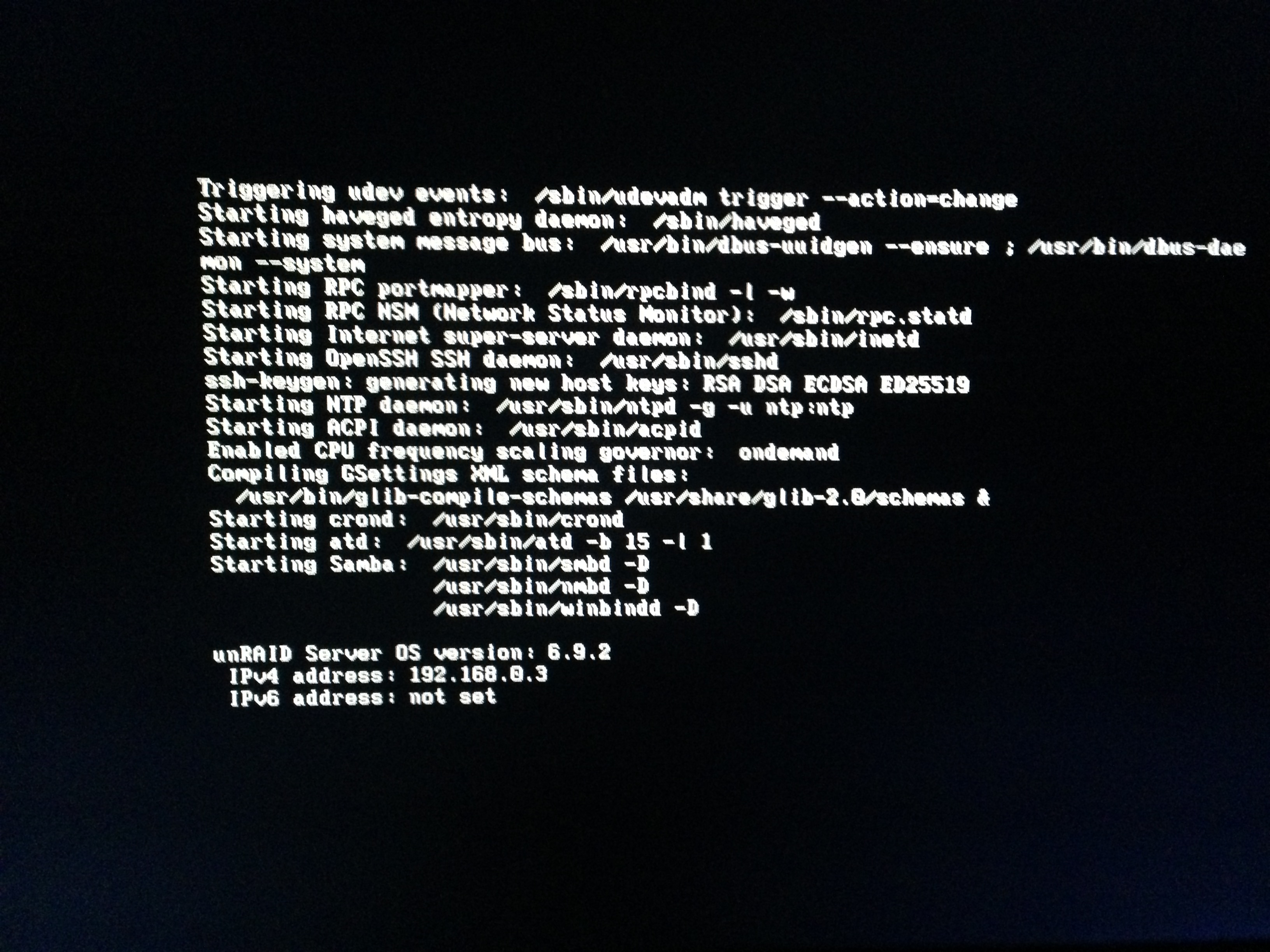

July 20, 20215 yr so i been dealing with multiple issues that all started when a nvme went wonky and buggered up a couple weeks ago for my appdata system and vms, but my question is. when unraid boots up it shows ip address i guess and no ip for v6 but i dont get a login its just disabled how do i fix that? when booting up in safe mode no plugins but gui.. i get a login there but when booting up normally.. the login is disabled.. anyway to re enable it?

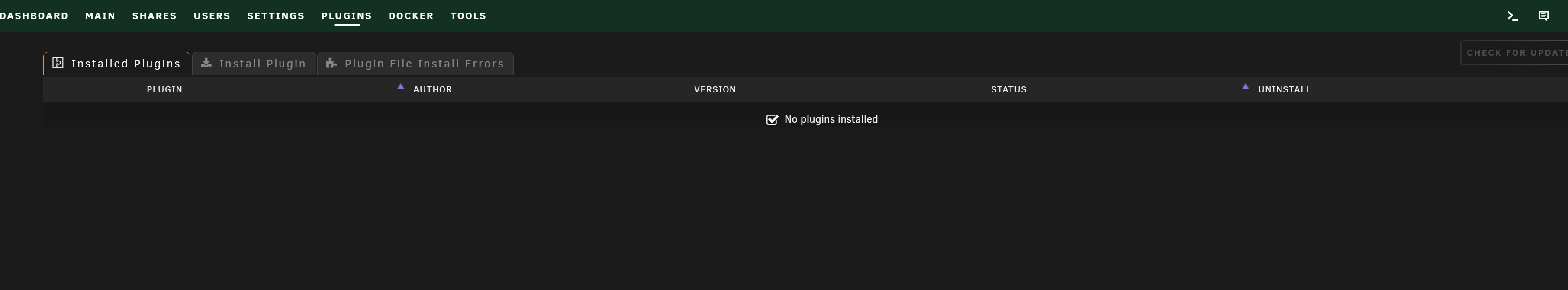

July 20, 20215 yr Author @JorgeB didnt work i did uninstall of 2 plugins at a time then rebooted.. now no plugins still cant use the login on the console.. and dunno if the unraid still broken other then the login issue i kept the array offline for each reboot i also moved the system folder to the array.. and rebooted so the system folder wouldnt mount at bootup didnt matter... still no login and dunno what else is affected tower-diagnostics-20210720-1839.zip Edited July 20, 20215 yr by comet424

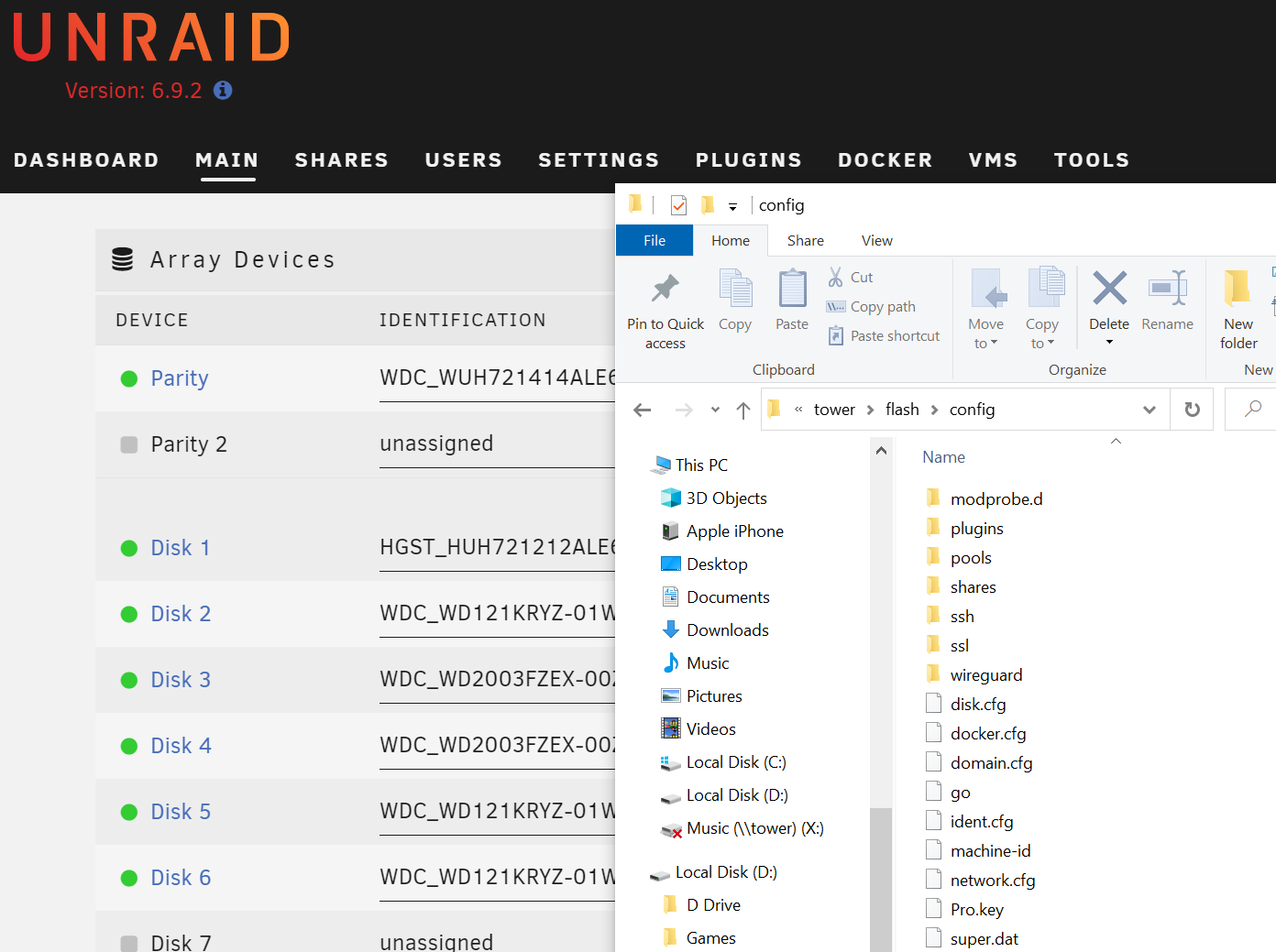

July 21, 20215 yr Community Expert Backup current flash, re-create it and restore only super.dat and the key file, both in the config folder, boot in normal mode, if it boots correctly start copying rest of the config folder until you find the problem or reconfigure the server.
July 21, 20215 yr Author @JorgeB did not work still login is gone is the usb broken? that then is causing my unraid to wrong problems also found bug in the unraid usb creator tool so i post that in the bugs section but i copied the 2 files and took screen shot everything went downhill when i had issues with my xpg 1tb nvme and when i moving the vms off it and my home assistant vm corrupted and then it was bam everything 1 problem after another as you probably seen different posts i been having tower-diagnostics-20210721-0846.zip

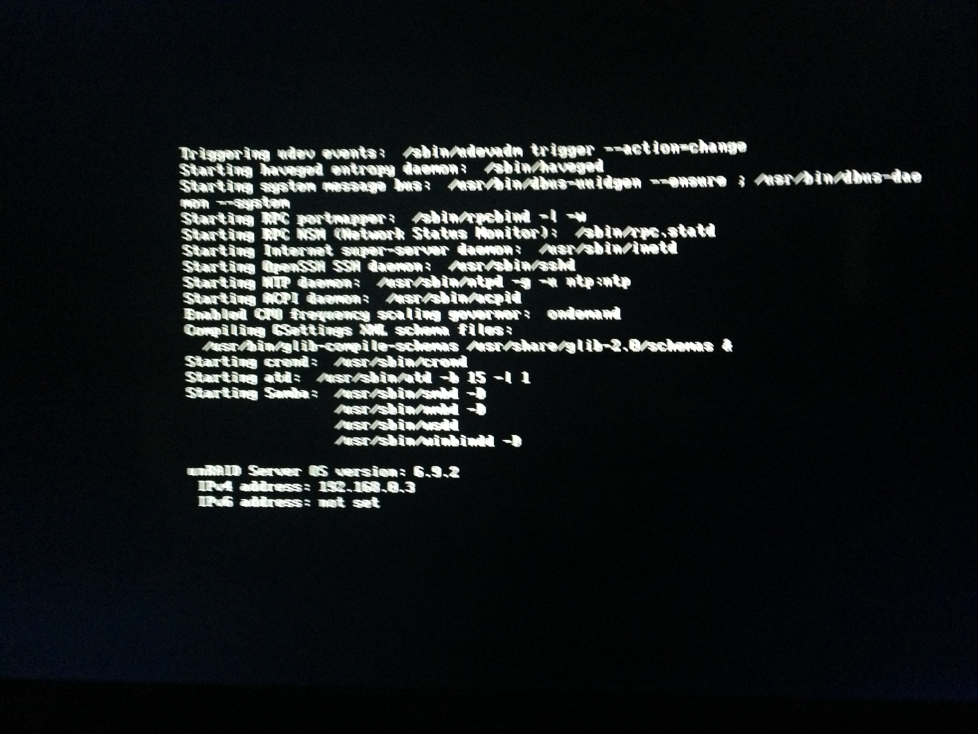

July 21, 20215 yr Author @JorgeB i think i solved it.. in the previous version of unraid it had no issues but i guess after this new upgrade and i only have the 1 monitor for unraid so what i found.. is if i hit enter like 5 times.. the Tower:Login shows up if i randomly type stuff doesnt show up.. after i login with root and then when you type "a" and hit enter then it shows up its like unraid console is off 2 Lines its going 2 lines before the display View so what i mean is you have a box and the stuff is showing 2 lines below that box.. but in the previous version i had not issues.. as i cant adjust my video card output for the generic console.. is there a way to fix that..? to expand my video card 2 lines. or is unraid able to so whatever you type you cant see it till you hit enter.. so its outside the graphic zone.. is that a bug ? or video card issue if i do safe mode no gui.. it also cant display the login.. guess i should chose that.. to helped diagnose things as i kept doing safe with gui.. but is there a way i can fix that ? back to like 6.8 login worked its probably not probably important to bug section... guess ill copy my plugins back and see if i get any improvements now on a clean install update: updated the motherboards bios to the latest.. and it fixed the unraid issue now it fits on the screen.. so i guess with each update of unraid should always check your bios is upto date too least that 1 issue fixed.. from others i got but work on them later Edited July 21, 20215 yr by comet424
