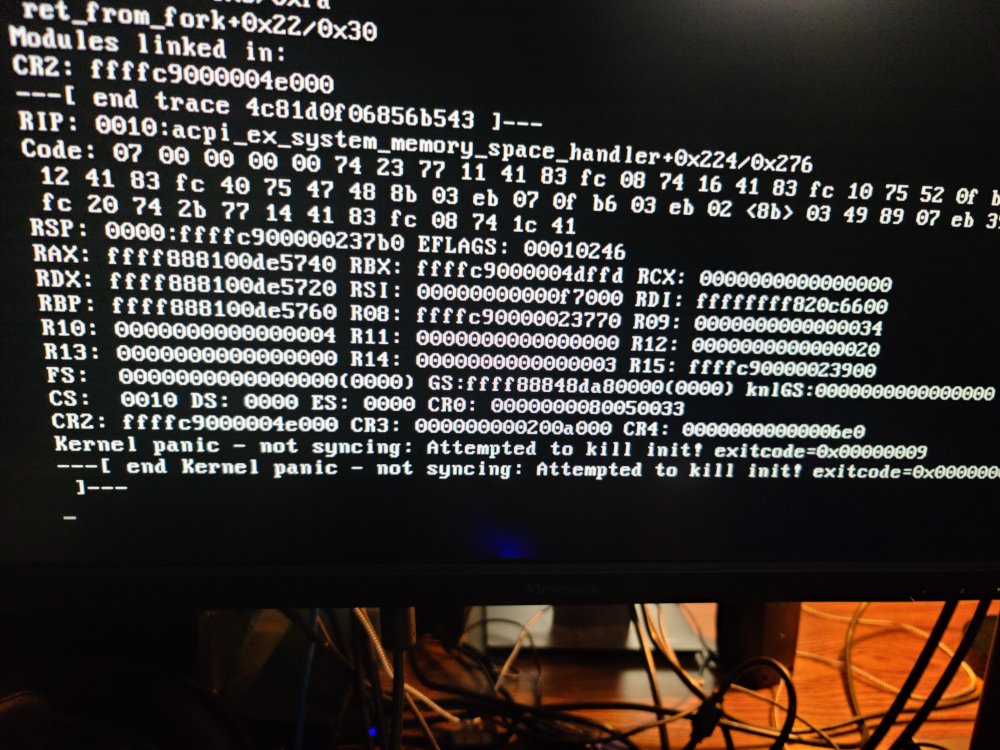

July 20, 20215 yr Hello, I am attempting to install unraid on a HP Z400 workstation. When booting the sequnce stops and states the following: Kernel panic - not syncing: Attempt to kill init! exitcode 0x00000009 ---[end Kernel panic - not syncing: Attempt to kill init! exitcode 0x00000009]--- The USB is newly created and will boot fine on other hardware. I have rearranged memory configurations and ran memtest64 and found no issues. The hardware will boot into windows 10 fine with no issues. Any suggestions? Edited July 20, 20215 yr by cheeto7017 Uploading picture
July 24, 20215 yr Author An update. I have switched to non ECC memory in both a single stick, two sticks and, three sticks of 4GB of RAM. I sill have the same result. Is there a way to look at logs and see what is going on?
July 24, 20215 yr Community Expert Could be a kernel incompatibility with that hardware, you can try a previous Unraid release to see if it's any different.
July 24, 20215 yr Author I started with version 6.9.2 and then tried 6.8.3. same result. I guess ill try the release candidate next. I saw this post below thinking this hardware would work. I
