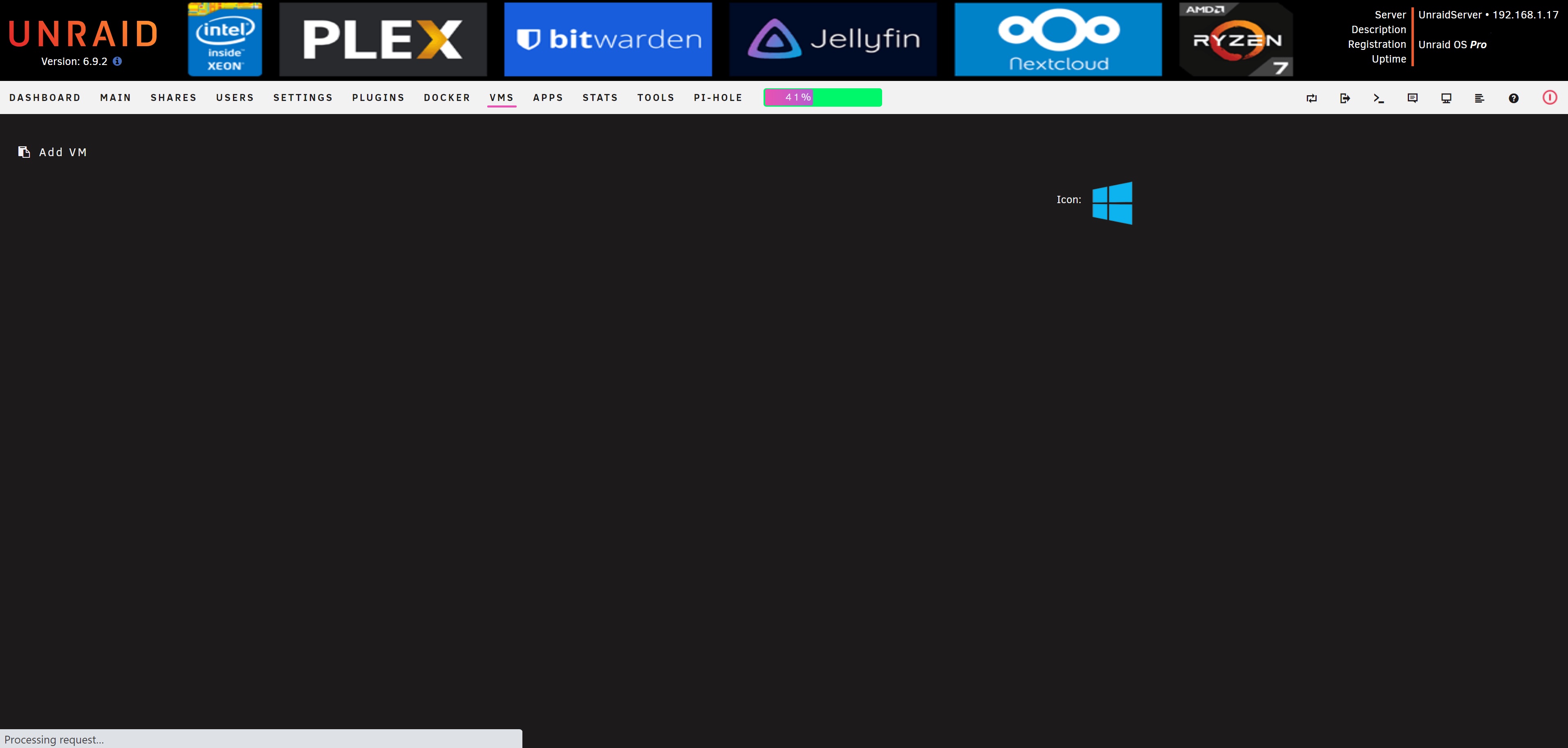

When I try and make VMs I get the list of types to add but once I click on the VM i want the page only part loads and doesnt do anything else.
The Syslog entry shows:
UnraidServer nginx: 2021/07/20 19:29:15 [error] 10573#10573: *30123 upstream timed out (110: Connection timed out) while reading upstream, client: 192.168.1.2, server: , request: "GET /VMs/AddVM?template=Windows+10 HTTP/2.0", upstream: "fastcgi://unix:/var/run/php5-fpm.sock:", host: "192.168.1.17", referrer: "https://192.168.1.17/VMs/VMTemplates"
Also:
nginx: 2021/07/20 22:06:35 [error] 10573#10573: *65475 upstream timed out (110: Connection timed out) while reading response header from upstream, client: 192.168.1.2, server: , request: "POST /plugins/fix.common.problems/include/fixExec.php HTTP/2.0", upstream: "fastcgi://unix:/var/run/php5-fpm.sock", host: "192.168.1.17", referrer: "https://192.168.1.17/Settings/FixProblem
nginx: 2021/07/20 22:46:19 [error] 10573#10573: *74705 upstream timed out (110: Connection timed out) while reading response header from upstream, client: 192.168.1.2, server: , request: "POST /plugins/unassigned.devices/UnassignedDevices.php HTTP/2.0", upstream: "fastcgi://unix:/var/run/php5-fpm.sock", host: "192.168.1.17", referrer: "https://192.168.1.17/Main"
I've tried deleting the libvirt.img and remaking it just in case but its still not working....
Any thoughts on whats going on?

i have the same thing. created a bug report here:
feel free to add your issue there, maybe then it gets some attention. should you figure it out on your own, please let me know. i am this close from starting from scratch on an 6.8 version...
Make sure you whitelist your server in any adblockers or anything else that might interfere with the webUI in the browser.
i apreciate you taking the time to answer, but unfortunately its not that simple. if it were the adblocker you would not see server side logs of an error/timeout i would think. still, i tested it because i am clinging to every straw at this moment and as suspected, no change in behavior.
downgraded to 6.8.3, no issues (other than had to reformat cache drive becauso of that pool setting in 6.9). @SmokeyOdin: what version are you on?
I'm on 6.9.2, but I did find that whitelisting my server on AdGuard and Pi-Hole, with a reboot seems to have fixed it. So guess it was that is what was causing the problem!
