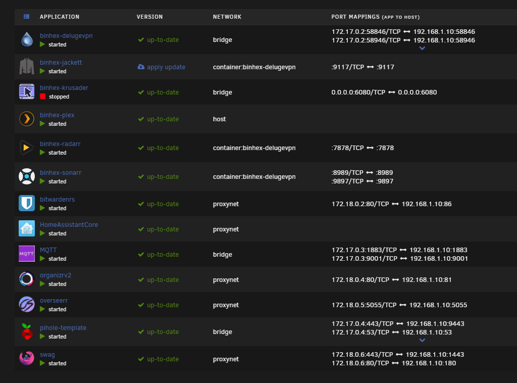

There are a couple of call traces but can't see the reason, could be the kernel doesn't like your board, the number one issue for crashes on v6.9.2 appears to be this:
Though this is usually visible in the syslog, still might be worth checking if it applies to you.
Took me a while to find the setting for host access. This has been disabled the whole time I am pretty sure.
There are quite a few networks in all as I have had to push jackett, radarr and sonarr clients through deluge since the proxy has been disabled. I also have a few dockers that are setup for external access through swag and only plex which appears on the host network.
Let me know if you see anything stupid though...

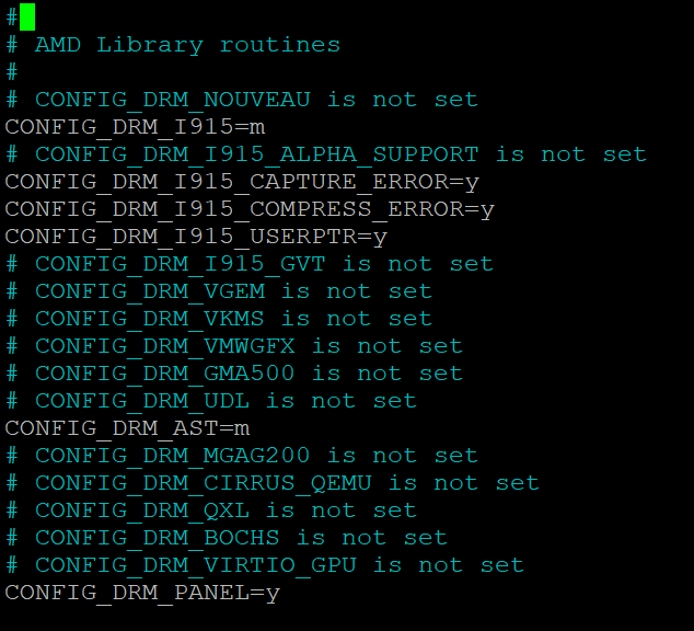

I'm running out of options. There seem to be a lot of people with similar issues on intel gear. Is there anything else I can try or should I just go back to 6.8.3?
Looking into reports from the linux community and there seem to be intel gou hangs from the kernel. I am using intel passtrough to my plex docker. Has anyone looked into this?
