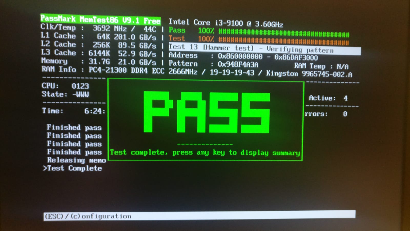

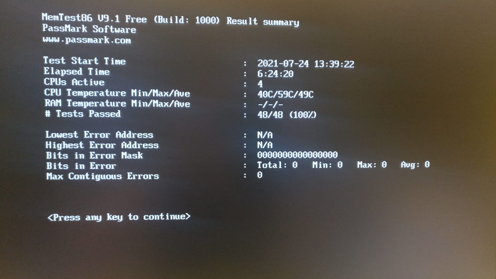

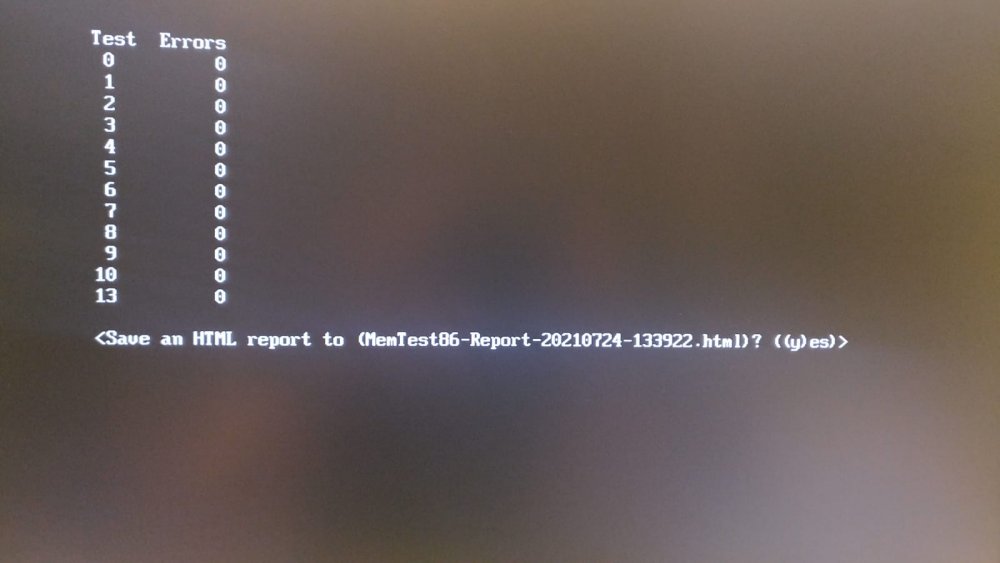

July 25, 20215 yr Author Finished a memtest, it passed. Seems to be no issue with the memory. I tried to run the memtest86 from Unraid, but seems to be freezed. So I created a usb with memtest86, that runs fine.
