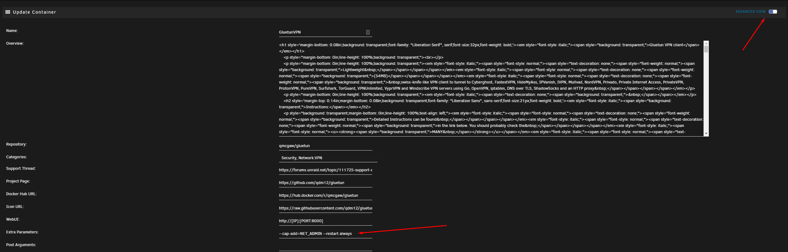

That would be the "--restart always" flag in the Extra Parameters field. You will have to toggle on Advanced View in the top right.
Make sure you leave --cap-add=NET_ADMIN as it is required for the container to work properly.
