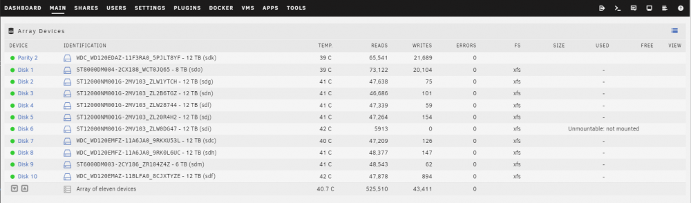

So out of nowhere one of my newest drives (couple of months old) became uncountable. So I tried XFS Repair and I got the following error:
Any way I can get to drive restored using the parity drive?

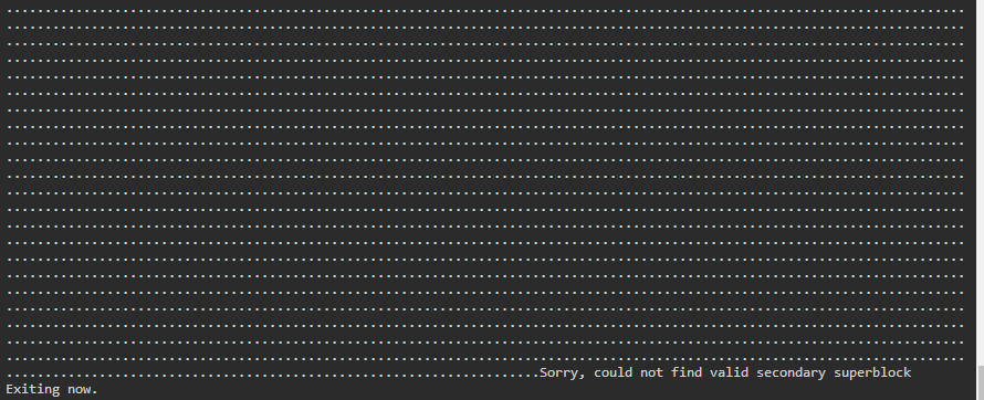

I ran it from the command line and I used this syntax: xfs_repair -v /dev/sdi
I also used the gui with the command -nv but it did not fix anything. I will run the command again and attach a log here shortly.

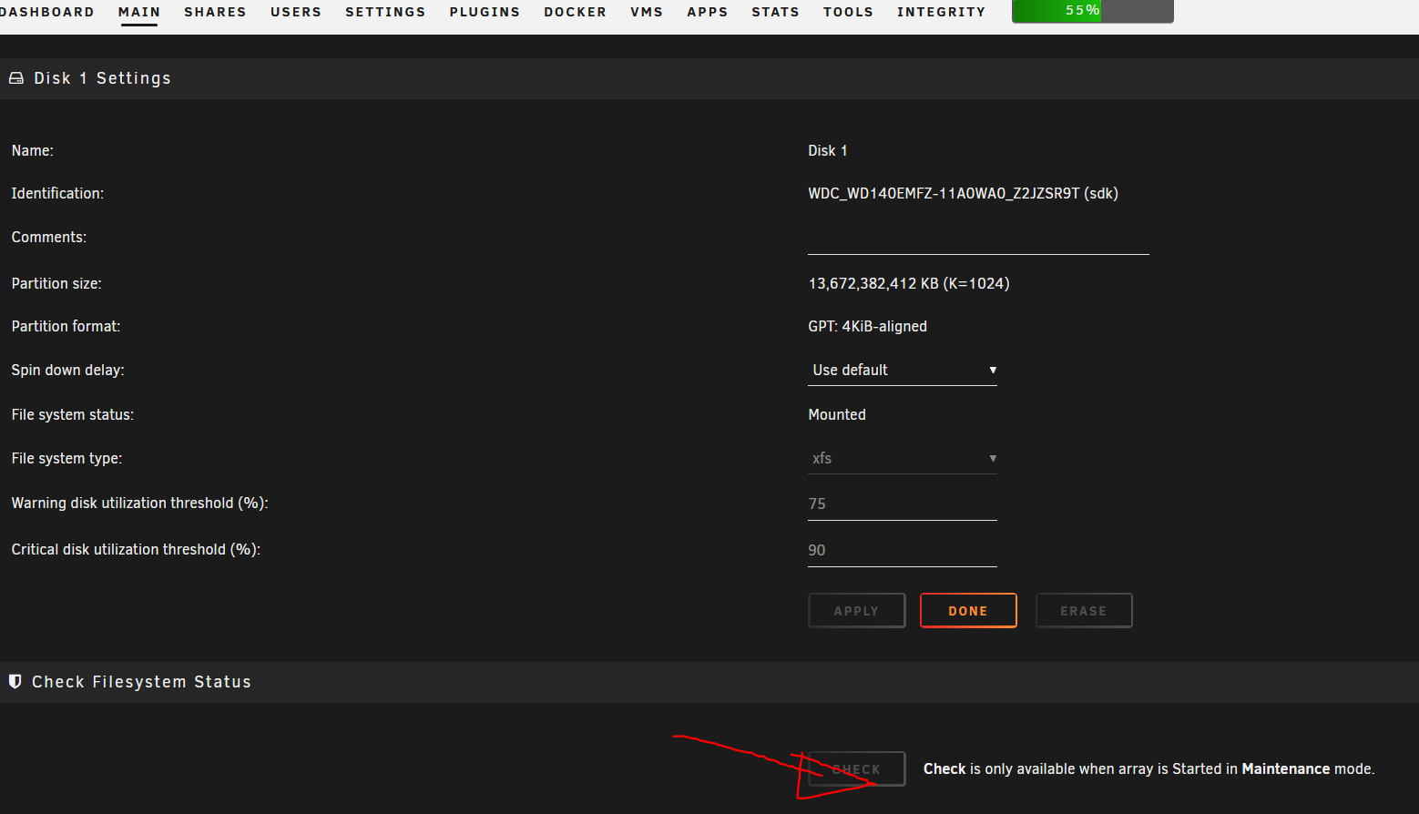

Edit when you say from gui do you mean the command line inside of unraid? Or the Check disk option?

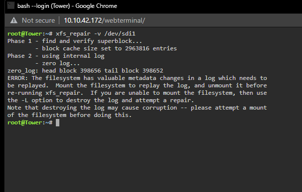

I used the command on the command line and I got this response:
Should I use the -L option or should I do something else first?
I have tried running the array again but the result is the same.
Edited by ONI
It worked! This is the command I used in hopes it helps other people in the future:
xfs_repair -v -L /dev/sdi1
I think he means the check command

I would still recommend using the GUI rather than the command line as then it automatically handles getting the device name right for you.

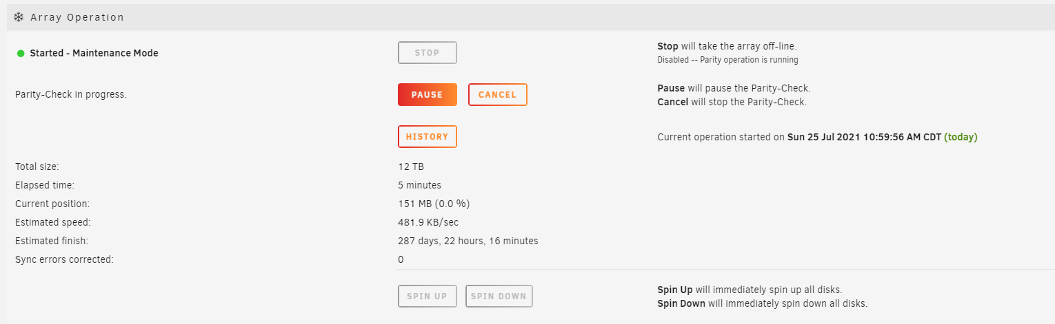

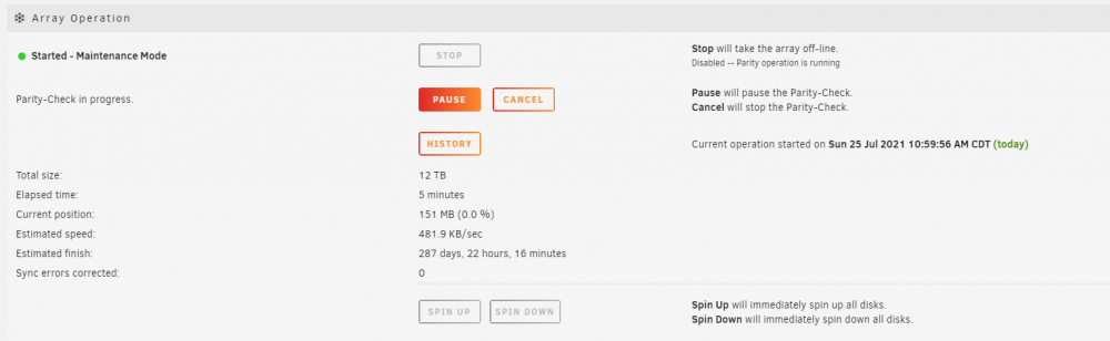

I tried to run the parity check and it’s now running at 600kb/sec so it will finish in 300 days lol…
This suggests you have some underlying problem - you are likely to get better informed feedback if you attach your systems diagnostics zip file (obtained via Tools->Diagnostics) taken while the system is showing the problem to your NEXT post.

I had the diagnostic files attached on my first post. Regardless I rebooted my unraid pc and I put it into maintenance mode. The issue is still there so I made a new diagnostic file and attaching it to this post.
Just as an FYI I had this issue a few months back too (slow parity check) and I made a post about it here. I was told I had a bad SATA cable so I ordered new ones to replace all the drives. That seemed to fix the issue until now.

The diagnostics show that you are getting continual errors (and resulting retries) on disk6.   There is no SMART information for this drive suggesting it has dropped offline for some reason. This can be as a result of a bad connection to the drive or it could be a problem with the drive itself.
Note that a bad connection can result from a cable (either SATA OR power) not being well seated as well as from a dodgy cable!
You will probably have to power cycle the server to get that drive back online.  If you want to test the drive itself then the extended SMART test is the best way to do this.

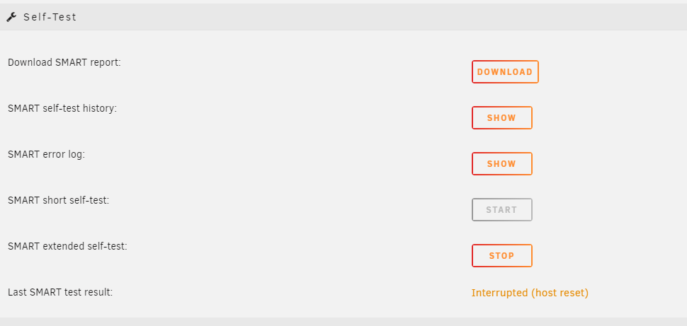

After running for about 12 hours it was still at 40%. That was when I went to sleep and I woke up in the morning with the following error:
I am still attaching the smart report in the hopes it retained some of the extgended scan. I am also starting another extended scan once my new PCIE SATA card arrives today. I am in the hopes that it might be that causing issues since its much cheaper and easier to replace than a 12tb HDD (also upgrading from a 6 port to a 10 port SATA card) and worst case scenario if it fails it still gives me room for 4 more drives.

The previous SMART test was interrupted, this is not a disk problem, make sure the disk is set to not spin down during the test.
Thank you, let me double check my settings and have it run again.
