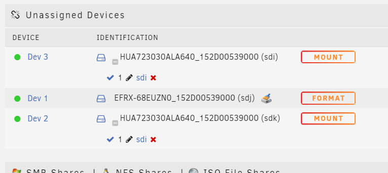

July 24, 20215 yr Hi everyone, I just bought a terramaster D5-300 and attached it to my Unraid server via USB-TypeC cable. All five disks are recognized, and the 5-bay storage is not running the software raid (I mounted the bays in Windows, ran their software and removed any raid). My aim is to mount 5 single disks in Unraid as I want to use the maximum space and don't care if I loose one disk (no redundancy required). When trying to mount the NTFS formatted disks, they all and up having the same mount point, like this: sdt 65:48 0 14.6T 0 disk └─sdt1 65:49 0 14.6T 0 part /mnt/disks/ST16000N_M000J-2TW103 sdu 65:64 0 14.6T 0 disk └─sdu1 65:65 0 14.6T 0 part /mnt/disks/ST16000N_M000J-2TW103 sdv 65:80 0 14.6T 0 disk └─sdv1 65:81 0 14.6T 0 part /mnt/disks/ST16000N_M000J-2TW103 sdw 65:96 0 14.6T 0 disk └─sdw1 65:97 0 14.6T 0 part /mnt/disks/ST16000N_M000J-2TW103 sdx 65:112 0 14.6T 0 disk └─sdx1 65:113 0 14.6T 0 part /mnt/disks/ST16000N_M000J-2TW103 When I try and change the mount point for one drive, it changes them for all drives. Why could that be and is there a way I can mount these drives as independent disks? In Windows (Computer Management), I was able to see 5 individual NTFS-formatted disks, however in Unraid, something isn't working quite right... I wanted to format the drives to XFS and mount points like /mnt/disks/sdt1 Not sure where I took the wrong turn and still not entirely sure whether Unraid can maybe not get through to the individual disks through this terramaster enclosure with the raid (as all disks have the same serial number which is suspicious in itself...) Thanks team!! Edited July 24, 20215 yr by theunraidhomeuser added link to enclosure
July 24, 20215 yr Community Expert The Unassigned Devices plugin relies on the USB enclosure passing through different disk serial numbers for each device. It appears that enclosure is not doing this which is why you are getting the results you see so it must be considered as being not compatible with Unraid.
July 24, 20215 yr Author Just for future visitors to this thread: the terramaster D5-300 works fine if you choose to use it in a RAID config, however for single disks, as mentioned above, it will not function reliably over time (you can get it working initially by formatting drives under Windows to NTFS but I wouldn't rely on this to be a safe or permanent solution).

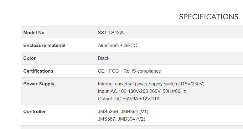

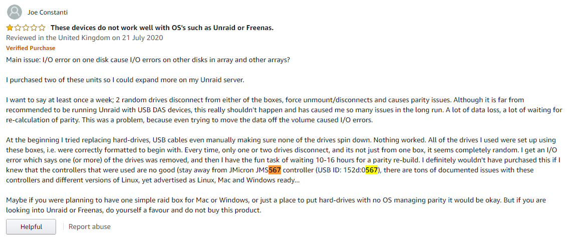

July 26, 20215 yr Notice you try a solution to manual mount disks by filesystem fsid, pls keep going. If this route not success, then you may try flash the enclosure by different firmware route. Several years ago, I buy two 5 bays Orico non-raid USB enclosure for Unraid, they use JMS539 or JMS567. In first test, both never pass reliability test whatever different USB controller or OS, it also not fully work with Unraid. After months fighting, I finally fix the JMS567 one by flash different brand firmware ( also JMS567 ) and insert a VIA USB hub between them, then Unraid ( also other OS ) solidly work, this serve me 1yrs+. - Unraid array or UD, work. - SMART data read, work. - Spinup / down partially work. First check does USB ID: 152d:0567 Below are the example RAID enclosure, also use similar chipset https://www.silverstonetek.com/product.php?area=en&pid=425 ** Take risk yourself ** The firmware which I use as below, only flash JMS567. https://www.startech.com/en-us/hdd/s355bu33erm#driver-and-downloads Don't touch SATA Port Multiplier JMB575 ( I never touch that, but just note silverstone have Port Multiplier chips firmware for JMB394 ) Edited July 26, 20215 yr by Vr2Io

September 11, 20215 yr I have a similar problem with my mediasonic probox using USB mode. When I use esata - it works fine. In USB mode the jmicron controller generates a fake serial number for each disk and it causes the same problem as listed above. The fake serial is unique, but unraid (or something) ignores the unique identifier at the end after the hyphen. Is there something I can do to fix this? I don't want to use this enclosure in esata mode, because I have to reboot the server every time to pick up the disks. Planning on using this as a removeable backup. each disk is identified with the model then the serial (fake from enclosure identified by slot) -0:0 is slot one. -0:1 is slot two, -0:2 is slot 3, and -0:3 is slot 4.
