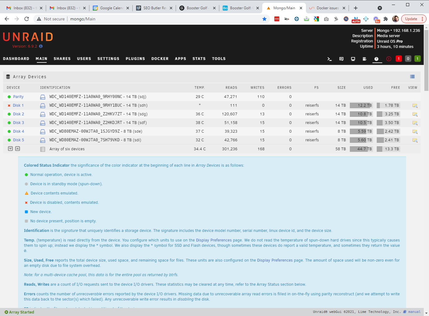

The last screenshot you posted had 9RHY1BUC assigned as disk1 and it was disabled.
These diagnostics show 9RHY1BUC Unassigned and 9RHWXDWC replacing it as disk1.
Can you tell us what you did between that screenshot and these diagnostics?

Post a screenshot of Main - Array Devices.
Is that a new screenshot taken after the diagnostics you posted?
Yes, that screen shot was taken like 3 min ago.
It doesn't agree with those diagnostics. Do you have multiple tabs or browsers working with your server?
Post new diagnostics.
I have been bouncing back and forth between desktop and laptop while dealing with this, so multiple tabs open is a possibility.
