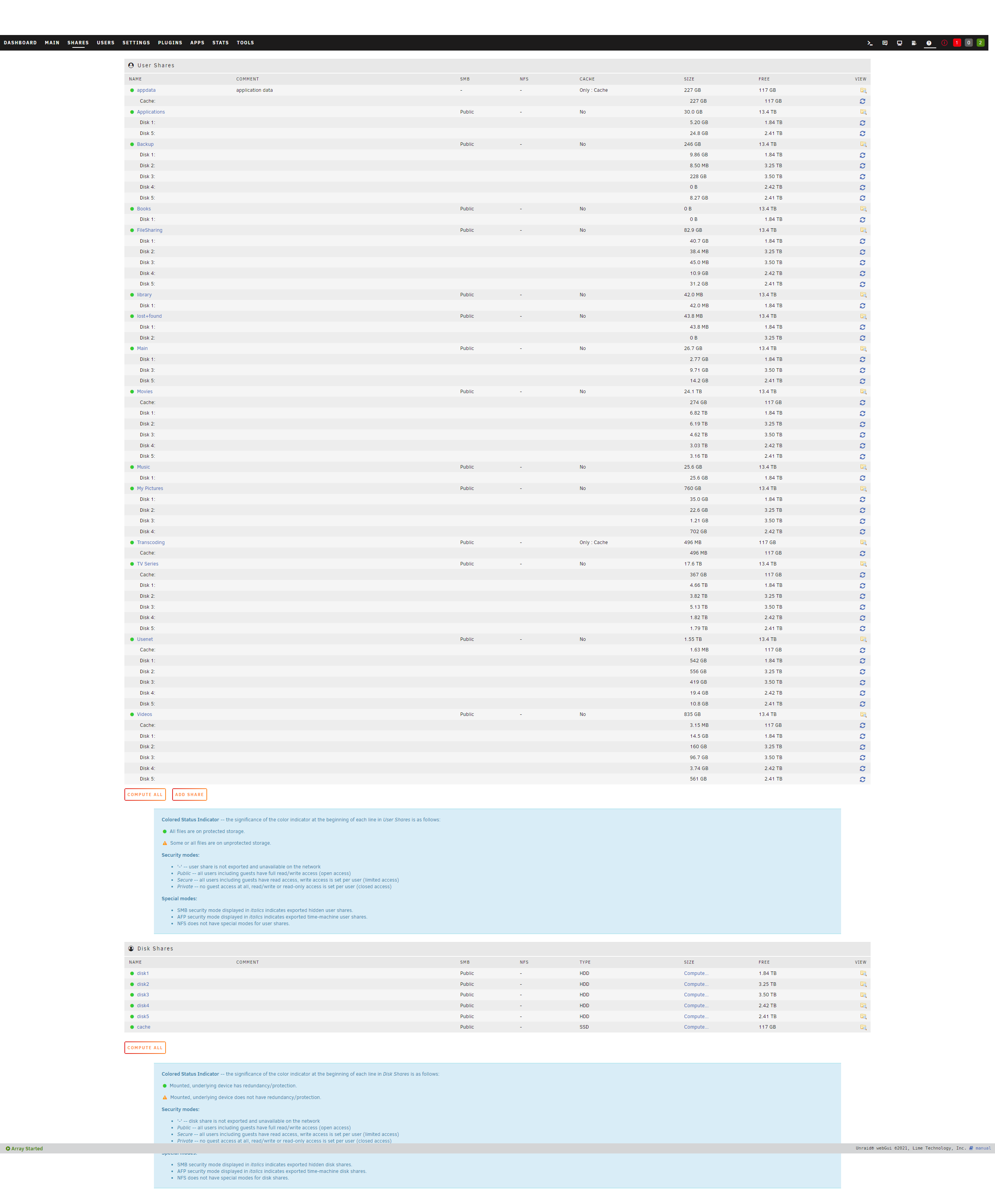

Go to Shares - User Shares, click Compute All button at bottom, wait for the results, then post a screenshot.
@trurl should I restore the share cache settings and try to manually run the mover to see if I can get cache files moved over?
All the shares currently set to cache-no that have files on cache, such as Movies?
Yes, change them to cache-yes, run mover, post new diagnostics.
@trurl here's diagnostics after mover ran. It might still be running, but it's cleared up about 600 GB on the cache drive. Looks like my appdata folder on cache will come in around 180 GB. Is that too much?

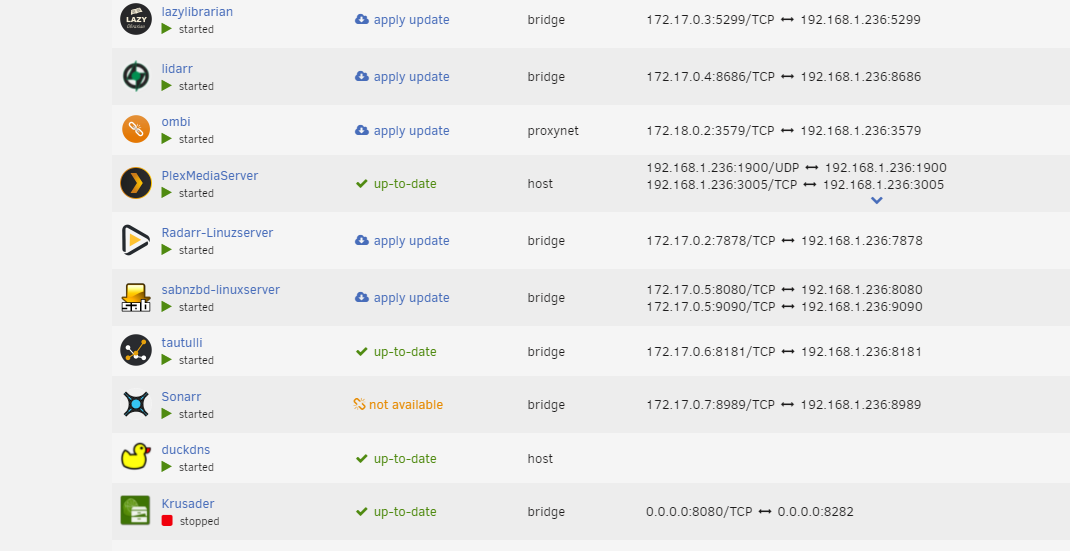

Question about the below image. Sonarr has had "not available" as an update for a while. Am I on the wrong distro or what's going on there?
Are you still on version 2 of sonarr? Or did you manage to upgrade to version 3?
Just checked. I'm on version 2.
I think I had to start over with Sonarr to get version 3. Not a big deal for me since I don't do a lot of TV.
Have you tried "force update"? You have to move the slider at upper right of the Docker page to Advanced View to get that option.
It just kinda hangs when trying a forced update. Would I need to just install version 3 and point the settings to the old appdata folder?
Don't know if v3 can use v2 appdata.
You might go read some on the support thread. You can go directly to the correct support thread for any of your dockers by clicking on its icon and selecting Support.
