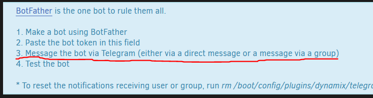

January 25, 20224 yr 1 hour ago, BKS said: This should probably be in the documentation somewhere (unless it already is an I'm just missing it). The information is on the built in help : It might be rephrase if not clear enough ?
January 25, 20224 yr Author I think the order needs changed. I did message the bot prior to testing. It appears the message needs to be sent after the bot sends an initial message to the client.
January 25, 20224 yr 1 hour ago, BKS said: I think the order needs changed. I did message the bot prior to testing. It appears the message needs to be sent after the bot sends an initial message to the client. Agreed, same issue for myself. Rewording and a change in order possibly should be made. Just happy its working now
