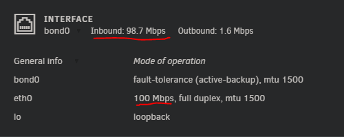

So I have my new server up and running, and I'm starting to transfer files on to some of my shares. I noticed the following on my dashboard:
This looks as if my network connection is operating at 100Mb/s. This is odd, because the PC that I'm copying from and my Unraid server have an Intel Gigabit adapters. To the best of my knowledge, all of my switches are Gigabit compatible. Most of my cable is Cat6, though there may be a Cat5e hiding out somewhere.
Any ideas as to why I'm not getting Gigabit speed?

Try a different cable/switch/port, while it links at 100Mbits you'll be limited to that.
