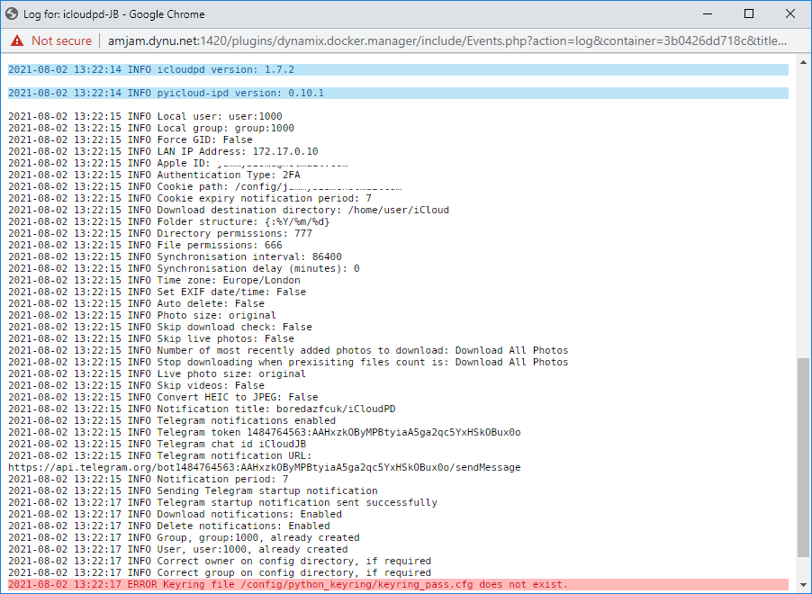

July 30, 20215 yr https://hub.docker.com/r/boredazfcuk/icloudpd/ its been updated and removed the keyring? i cannot get it to login or work. i've deleted my key and tried to kickstart it but it isn't having any of it. any ideas on how to login?

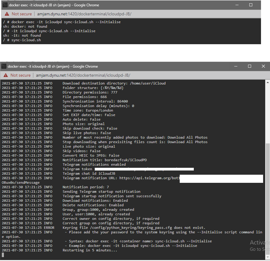

July 30, 20215 yr Author 43 minutes ago, Ashe said: I just had a look as your post prompted me to check and mine was not working after the update. If you edit the container via the unraid webgui, click show more settings just under the Time Zone variable and click remove for the keyring/password option and click apply. I reauthorized the docker and entered the code via then restarted but not sure if that needed to be done but now it is working as normal i've deleted that option out of the container, tried as you suggested and this is what i get:

August 1, 20215 yr Author 7 minutes ago, Ashe said: run the docker , drop to command line and type docker exec -it icloudpd sync-icloud.sh --Initialise you can see I did that in the screen shot at the top and it gave an error. where do I do that command if not in console on the container?
August 1, 20215 yr Sorry I missed that. Looks like you’ve changed the name of your docker from the standard name Usedocker exec -it icloudpd-JB sync-icloud.sh --InitialiseSent from my iPhone using Tapatalk
August 2, 20215 yr Author 13 hours ago, Ashe said: Sorry I missed that. Looks like you’ve changed the name of your docker from the standard name Use docker exec -it icloudpd-JB sync-icloud.sh --Initialise Sent from my iPhone using Tapatalk
August 2, 20215 yr 15 hours ago, Jammy B said: where do I do that command if not in console on the container? Since you are already in the container console you don't need the first half. Just type sync-icloud.sh --Initialise

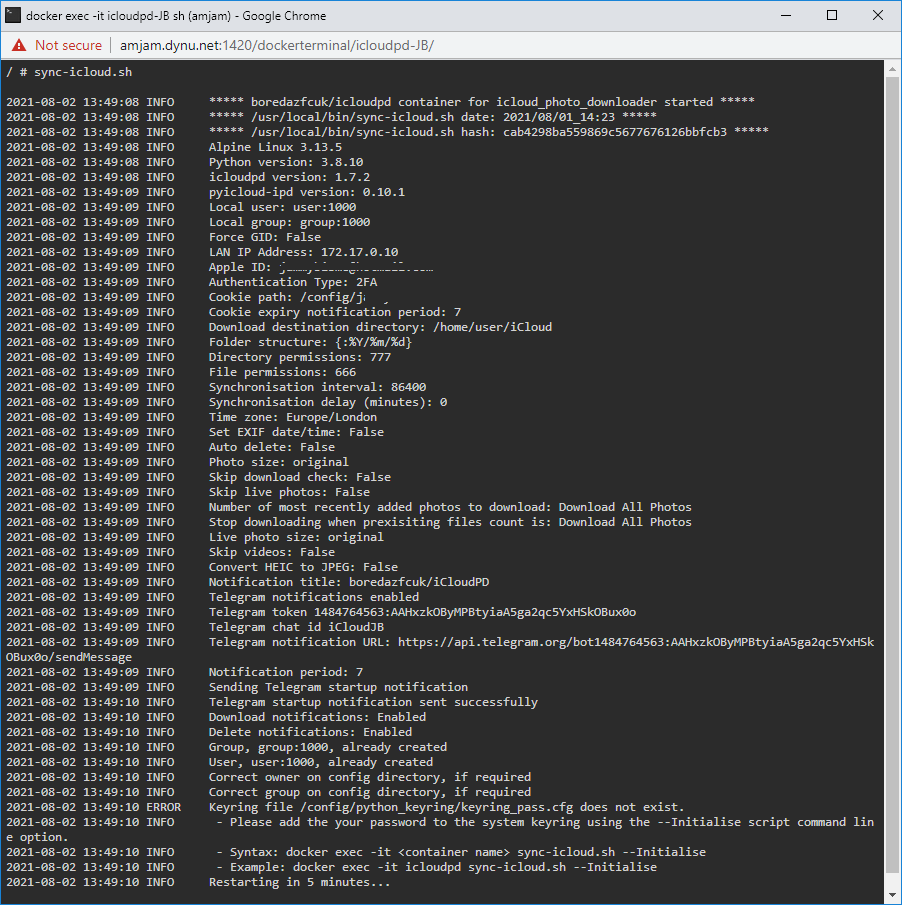

August 2, 20215 yr Author 17 minutes ago, jonathanm said: Since you are already in the container console you don't need the first half. Just type sync-icloud.sh --Initialise got you. that got going. but now this: is it something to do with the container variable for 2FA? it just doesn't want to work
August 2, 20215 yr Looks the same as mine. I shut it down and restarted at that point and it was then syncing Sent from my iPhone using Tapatalk
August 2, 20215 yr Author this is what i get on the log when start it back up [after it stops itself] what am i doing wrong here, i'm lost.

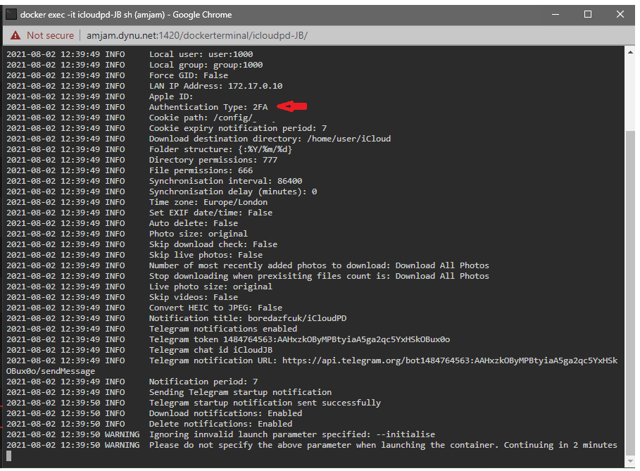

August 2, 20215 yr 20 minutes ago, Jammy B said: what am i doing wrong here, i'm lost. What, exactly, did you type at the console?

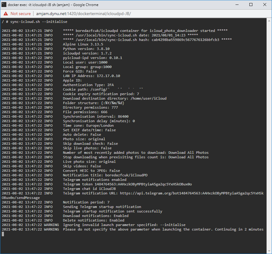

August 2, 20215 yr Author thats with initialise.... one says to not specify the parameter, the other one asks you to put it in??? thats just sync-icloud.sh Edited August 2, 20215 yr by Jammy B
August 2, 20215 yr 45 minutes ago, Jammy B said: thats with initialise.... That's wrong, it's asking for this, EXACTLY. 2 hours ago, jonathanm said: sync-icloud.sh --Initialise
August 2, 20215 yr Author 21 minutes ago, jonathanm said: That's wrong, it's asking for this, EXACTLY. got you. the capital I on Initialise. all working now. thank you very much for your help, support and patience!
