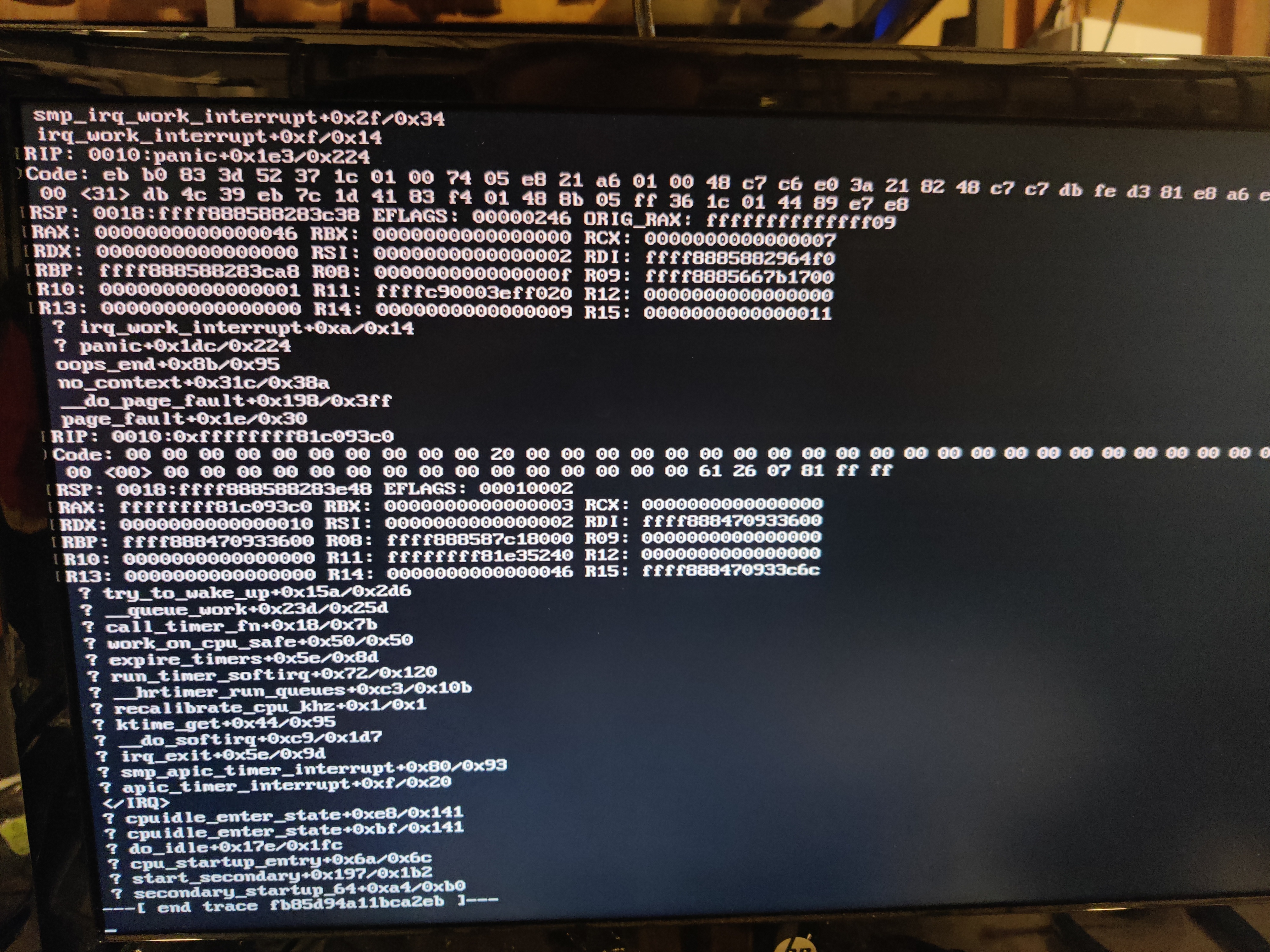

July 30, 20215 yr While I don't know if its actually random I cant find a pattern to this. My server becomes unreachable. Not only cant I see my shares from my desktop I dont see it connected when I look in my router. I also go to check the screen attached to the server and there is no login prompt. I uploaded a picture of that. I also ran a diagnostic. Do I upload that whole folder here? TIA diagnostics-20210730-1254.zip Edited July 30, 20215 yr by Darkon Added logs
July 30, 20215 yr Community Expert You should post the complete diags, in case there are known issues with that hardware, you can also enable syslog mirror to flash then post that log after a crash.

August 11, 20215 yr Community Expert On 8/6/2021 at 6:07 PM, Darkon said: I posted the diagnostics, is anyone able to see whats going wrong from that? Nothing jumps out regarding the hardware used, see if the mirrored syslog catches anything after a crash.
