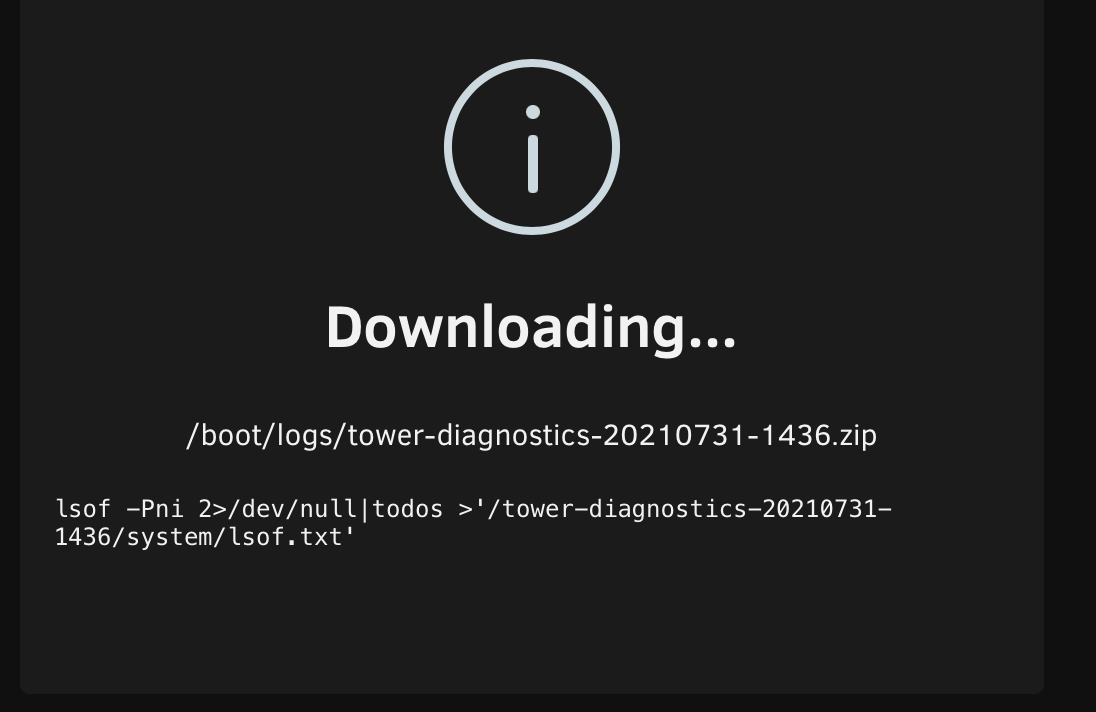

From the webGUI, diagnostics *should* pop up a window that gives the current command that it's running.  What is it?
This is where it gets stuck at.

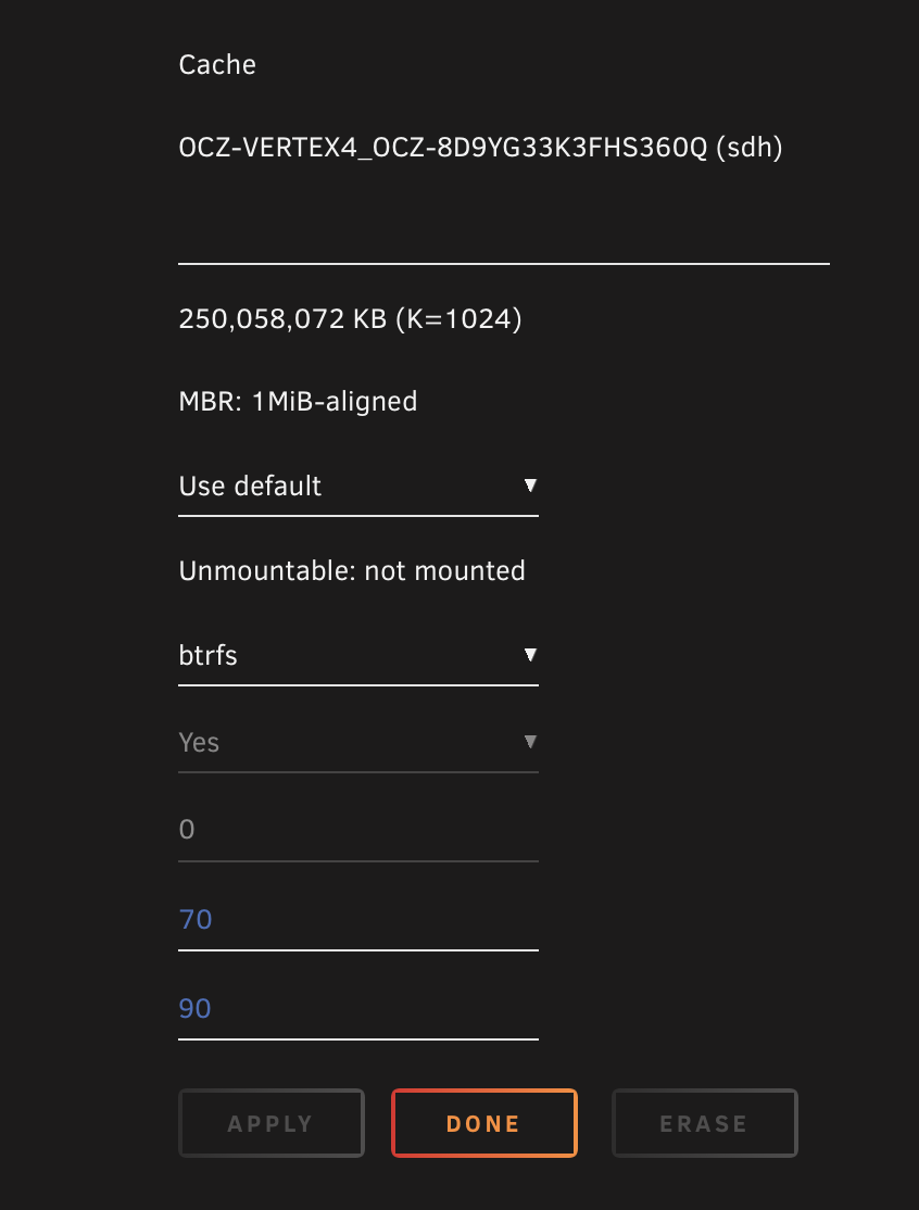

So I rebooted out of Safe Mode back into normal mode and the cache drive is unmountable it says. But it shows the drive is healthy.
