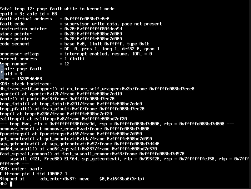

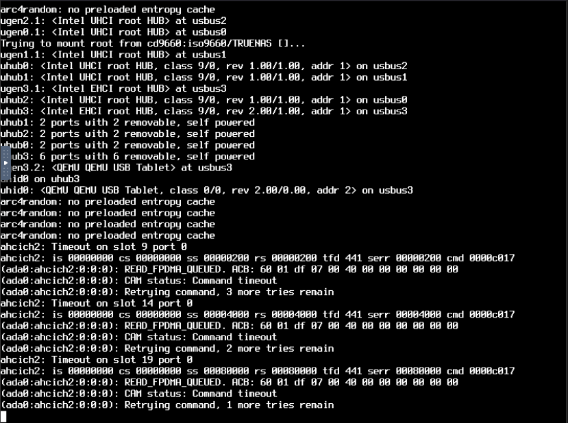

October 6, 20215 yr Love your videos SpaceInvaderOne. I want to pass the disks directly to the VM. But I am unable to get TrueNas to install. I followed your steps, but keep getting the below error. It keeps going to these retries and eventually fails saying there was a page fault. Edited October 6, 20215 yr by GumGum
October 15, 20215 yr I am running in to the same issue GumGum. Bummer, as this is exactly what I ant, unRAID host with TrueNAS running in it for the read/write benefits of TrueNAS but the flexibility of unRAID for everything else
