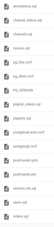

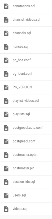

For Invidious: Can anyone share screenshots of a fully working setup of their invidious and inv_sig_helper containers? Preferably without Portainer, since I don't have that.
I followed the initial Invidious setup guide from Joshndroid, and postgres and Invidious seemed to work at that point (except, of course, I couldn't play videos in the Invidious GUI due to that recent* Google block), But once I tried to add in inv_sig_helper and modify Invidious, I kept getting constant errors. I kept track of all the different ways I've tried to get them to work so far, and it adds up to 24 attempts in total, so I'm at a loss. I'm sure it's something simple, but I can't crack it.
Edited by lining7333
@lining7333 What is the error log on Invidious and inv-sig-helper?
Hey right before you replied, I finally got it working with the help of Docker compose. (I didn't even check the error logs because I'm not a smart person!) I'll update this post in a bit with screenshots of my compose file.
EDIT:
Here's my working compose file. I was also going to include a screenshot of my postgres config, but I realized it's essentially the same as the default 12.5 template in Community Applications, along with Joshndroid's exact instructions for setting the container/database up correctly.

in the db folder are the files of this image
appdata/invidious/postgesql14
