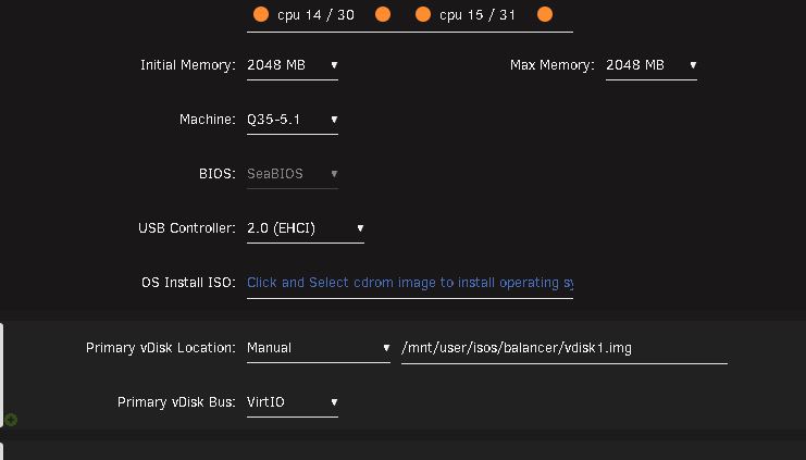

October 24, 20223 yr I'm still not clear on how to utilize the *.img file within a virtual server? Did you create a Linux VM? Slackware? All VM options are requiring an *.iso file which i do not have prior to mounting the *.img file. Thank you. Edited October 24, 20223 yr by dss
October 26, 20223 yr On 10/24/2022 at 5:10 PM, dss said: I'm still not clear on how to utilize the *.img file within a virtual server? Did you create a Linux VM? Slackware? All VM options are requiring an *.iso file which i do not have prior to mounting the *.img file. Thank you. Linux VM. You don't actually install the OS in a typical way. IIRC, the *.img file is a working OS, so you put that as your primary vdisk. There's no *.iso to mount. I've put in a snippet of my config so you can see what I mean. HTH
