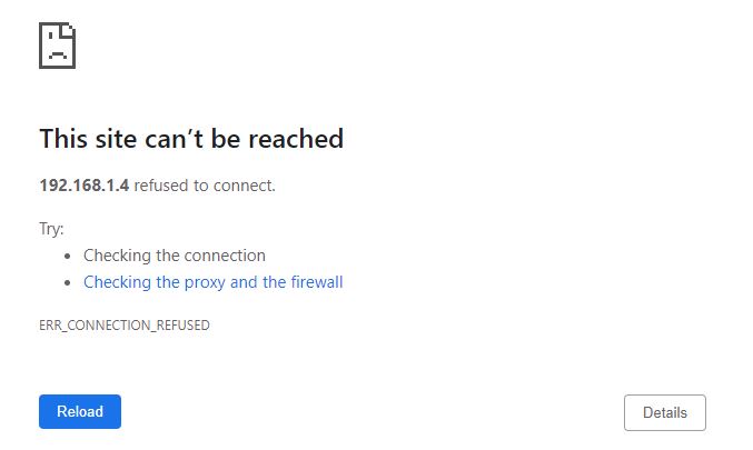

After deleting the old containers, I installed jellyfin, and then when I go to the docker tab, click the icon, and go to WebUI, I get "this site can't be reached" page everytime:
Ive tried in brave, firefox and chrome, and from multiple PCs with no difference.
Happens with ALL containers now (tried plex, and a few others - no webui will work)

what happens when you type http://192.168.1.4:8096 in your web browser as address ?
For some reason it is working now. I have no idea why it wasnt working before, but for some reason I can now go to the WebUI page.
Im completely stumped.
But to answer your question - it would previously give me the same error - the site cant be reached.  I tried many different combinations, with/without "/web/index.html#!/wizardstart.html" to the end, but nothing worked.
But like I said - for NO REASON AT ALL - its working now.
