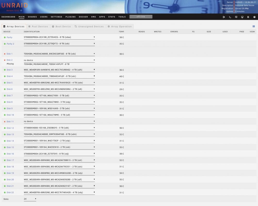

August 6, 20215 yr Hi, I'm having a serious problem and really need help! My array lost a disk couple of days ago (the disk was disabled), but since I have 2 parity disks, I didn't replace it immediately but kept using for some more days. Today, my new disk arrived, I was trying to replace the bad one, but a good disk dropped on the ground by accident, then when I put all disks back into array (the disabled was replaced with a new disk), I was surprised to find that 2 disks were missing (one is the old disabled disk which is expected, another is the dropped one), 1 was disabled. I was confused about the disabled one 'cos it was working fine before last shutdown. I tried to mount it manually and seemed everything's ok, SMART quick test also done without error, so I think it's just fine but it's still disabled. Now I'm in a situation that 2 disks are missing, 1 is disabled. Can some one enlighten me the correct way to handle this? Diagnostic data attached. Thank you. George. unraid-diagnostics-20210807-0025.zip
August 6, 20215 yr Community Expert Just to clarify, it looks like you have 2 missing disks, and you have 2 disabled disks, but these are not both the same disks. One of the missing disks is disabled, and another disk which isn't missing is also disabled. And another disk which is missing isn't disabled. Since you have too many missing and/or disabled you can't start the array. Is that all correct? Post a screenshot of Main
August 6, 20215 yr Author Just to clarify, it looks like you have 2 missing disks, and you have 2 disabled disks, but these are not both the same disks. One of the missing disks is disabled, and another disk which isn't missing is also disabled. And another disk which is missing isn't disabled. Since you have too many missing and/or disabled you can't start the array. Is that all correct? Post a screenshot of MainNope, there’re 2 missing disks, and 1 disabled as shown in the attached screenshot. I didn’t try to start the array as I was scared to make it worse.Sent from my iPhone using Tapatalk
August 7, 20215 yr Community Expert Maybe my clarification could have been a little clearer. Disk1 is disabled. Disk2 is missing. Disk11 is both missing and disabled. If you had disk2, since you have dual parity you could rebuild both disk1 and disk11. Those are the disks Unraid wants to rebuild. But you can't without disk2. What evidence do you have that the original disk11 was really bad and not just disabled due to bad connection? Bad connections are much more common that bad disks. Do you still have that original disk11?

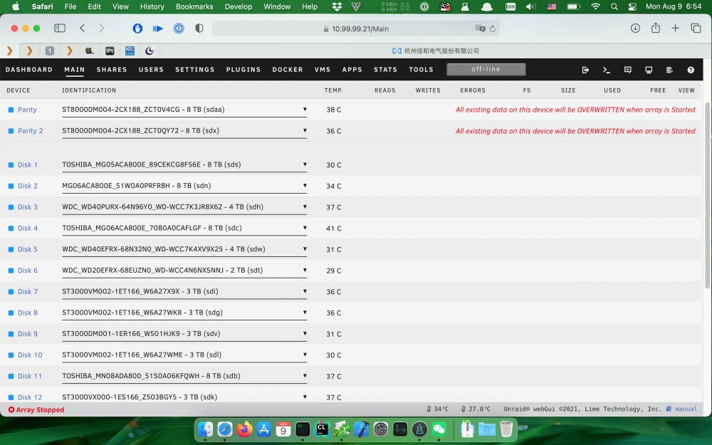

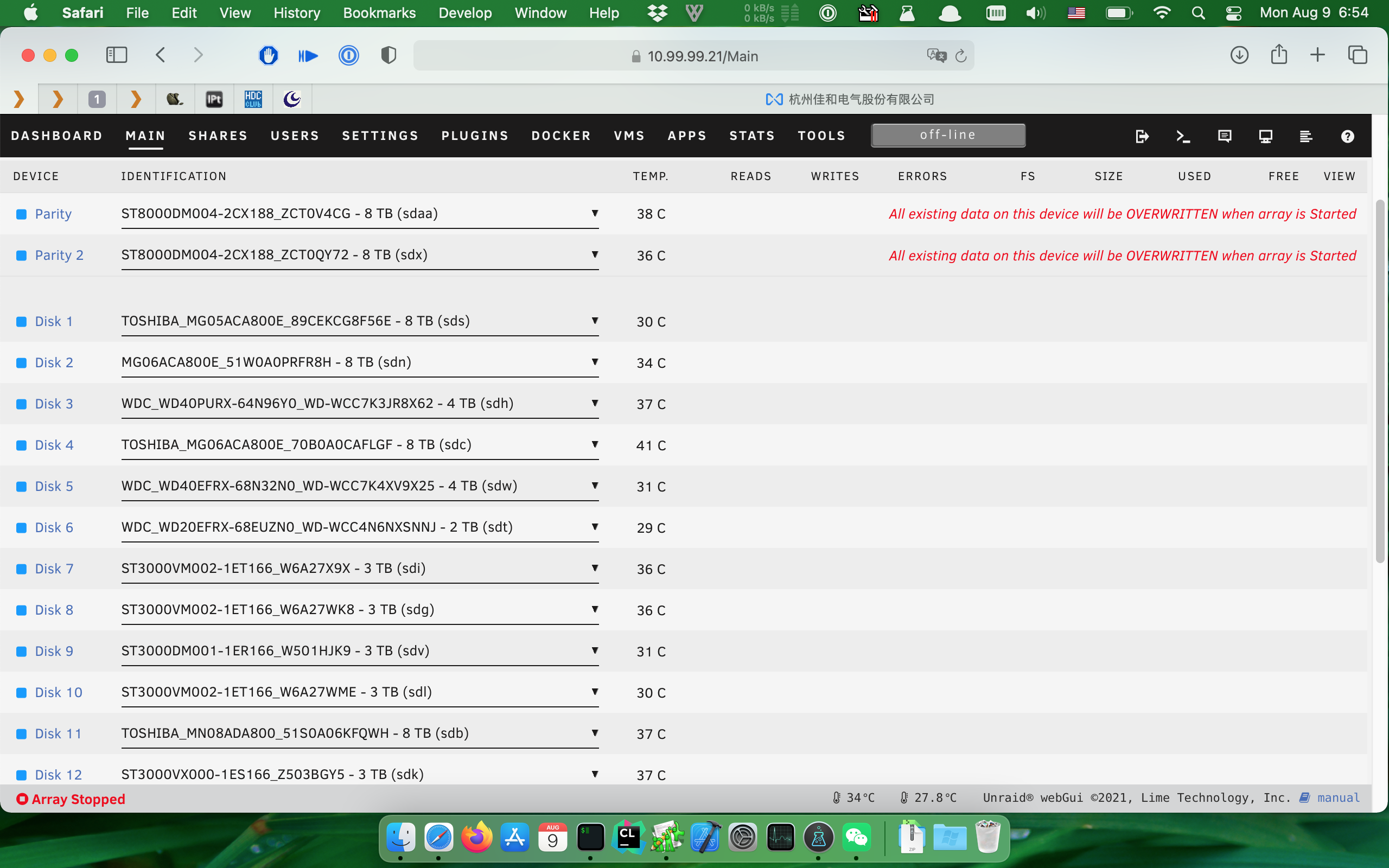

August 8, 20215 yr Community Expert Solution You don't need to have any missing disks. Just go ahead and assign the replacements to those slots and the exact disks as before to all other slots. Then, when you check parity valid box (so it won't rebuild parity) and check Maintenance Mode (so no disks are mounted), then start the array, disk assignments will be recorded, but nothing will be read or written to any disks (because no data disks are mounted and parity is valid). At that point, no disks will be disabled, which gets us disk1 back so it can be used with your dual parity plus all other disks to rebuild the 2 replacements. Then, you stop the array, unassign the replacement disks, start the array in normal mode, and see if the emulated missing disks mount. It should show you on Main how much space they have if they mount. You can even take a look at the files on the emulated disks, even though the replacement disks are not assigned and even though those replacement disks don't actually contain any of the data. Their data is emulated by calculating it from parity plus all other disks. This is what parity is all about. If that all looks good, stop the array, reassign the replacement disks, and start the array to begin rebuilding the emulated data to those disks. Ask if you have any questions or if something doesn't seem to work as explained, and please don't deviate at all from what I have described.
August 8, 20215 yr Author You don't need to have any missing disks. Just go ahead and assign the replacements to those slots and the exact disks as before to all other slots. Then, when you check parity valid box (so it won't rebuild parity) and check Maintenance Mode (so no disks are mounted), then start the array, disk assignments will be recorded, but nothing will be read or written to any disks (because no data disks are mounted and parity is valid). At that point, no disks will be disabled, which gets us disk1 back so it can be used with your dual parity plus all other disks to rebuild the 2 replacements. Then, you stop the array, unassign the replacement disks, start the array in normal mode, and see if the emulated missing disks mount. It should show you on Main how much space they have if they mount. You can even take a look at the files on the emulated disks, even though the replacement disks are not assigned and even though those replacement disks don't actually contain any of the data. Their data is emulated by calculating it from parity plus all other disks. This is what parity is all about. If that all looks good, stop the array, reassign the replacement disks, and start the array to begin rebuilding the emulated data to those disks. Ask if you have any questions or if something doesn't seem to work as explained, and please don't deviate at all from what I have described.I followed the steps, looks like somethings wrong here, the 2 missing disks were not emulated (screenshot). I still have old config files (disk.cfg and super.dat) so I think I can scroll back to old config but I don’t know why the missing disks were not emulated.Sent from my iPhone using Tapatalk

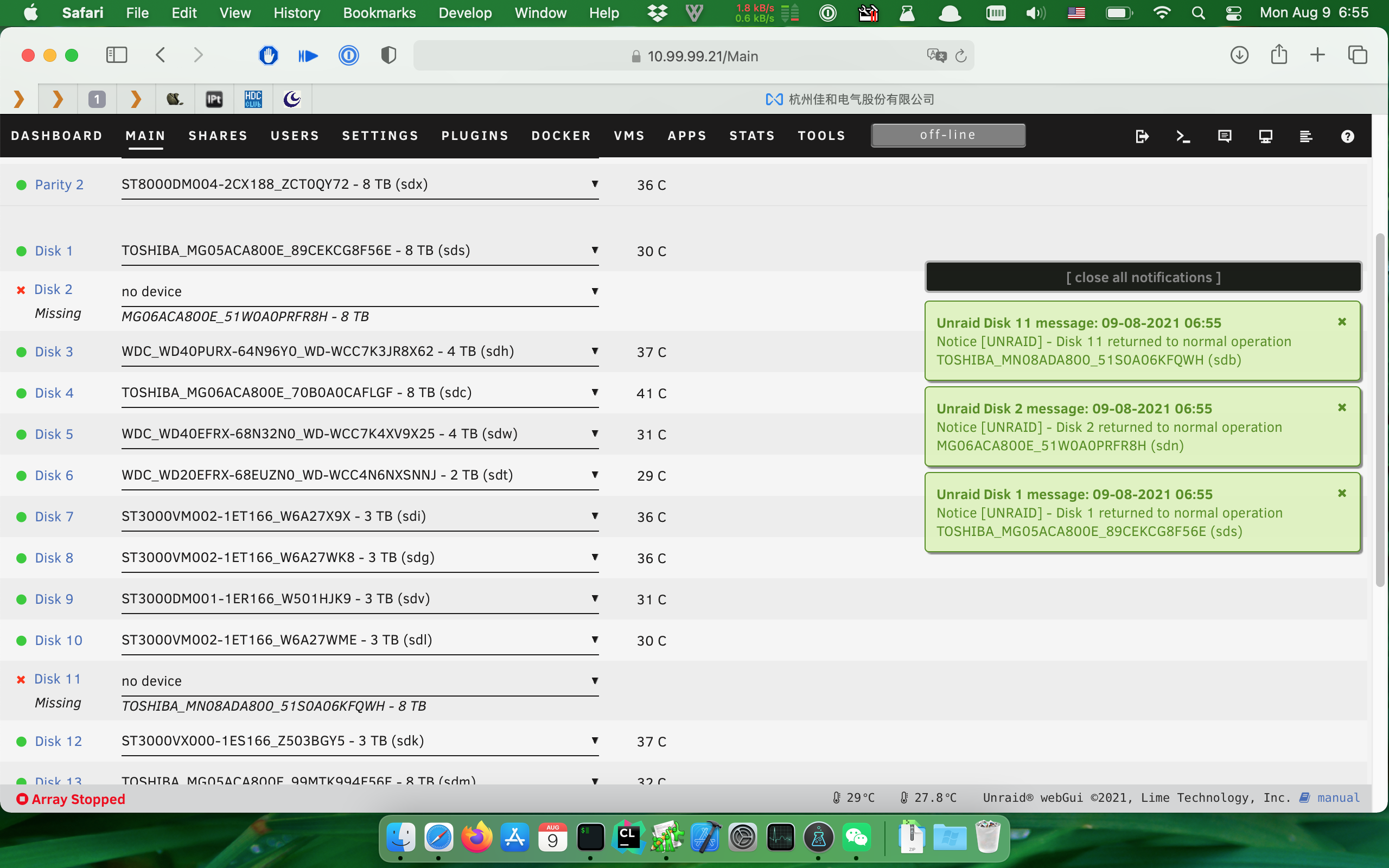

August 8, 20215 yr Community Expert Looks like that screenshot is after this: 32 minutes ago, trurl said: stop the array, unassign the replacement disks, start the array in normal mode, and see if the emulated missing disks mount. Are you sure you did all of this: 7 minutes ago, georgez said: assign the replacements to those slots and the exact disks as before to all other slots. Then, when you check parity valid box (so it won't rebuild parity) and check Maintenance Mode (so no disks are mounted), then start the array before that?
August 8, 20215 yr Community Expert Actually, I can't tell from that screenshot whether or not the emulated disks mount because you have clipped off all the part to the right of the screen that would show 37 minutes ago, trurl said: on Main how much space they have if they mount
August 8, 20215 yr Author Yes I did assign all disks include the replacement ones, I tried it again, here’s the screenshot:Sent from my iPhone using Tapatalk

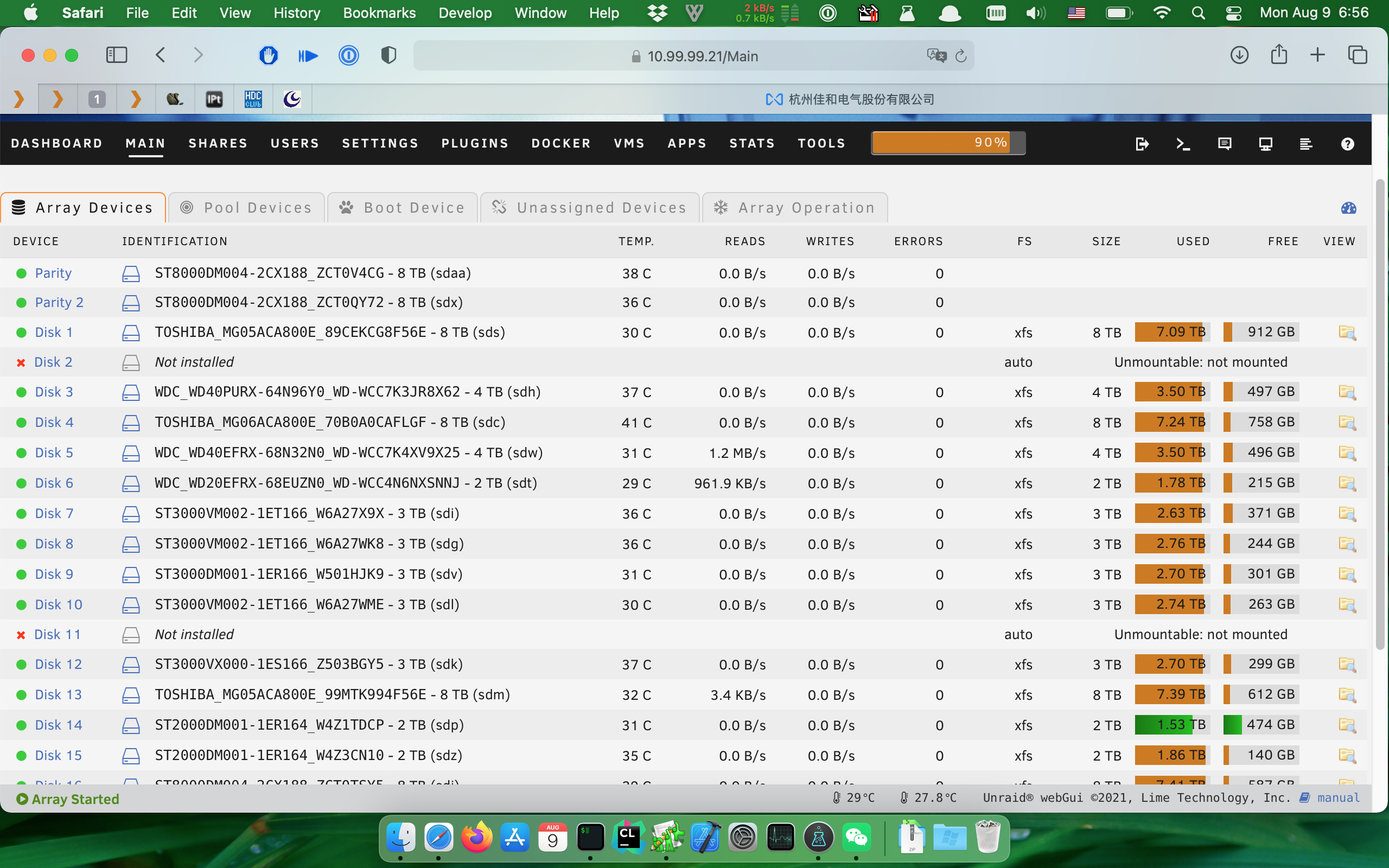

August 8, 20215 yr Author Ah I misunderstood the thing, the emulation is working, I have to move mouse cursor to the cross to show it, can I go ahead and assign back disks to rebuild?Sent from my iPhone using Tapatalk
August 8, 20215 yr Community Expert 2 minutes ago, georgez said: the emulation is working but the emulated disk doesn't mount, and the results of rebuild will be exactly what is emulated. It doesn't even seem to know what filesystem should be on the disks. OK try this 23 minutes ago, georgez said: I still have old config files (disk.cfg and super.dat) so I think I can scroll back to old config but before rebooting, check disk.cfg to make sure it is set to not autostart. Reboot, don't start the array, post new diagnostics and a screenshot of Main.
August 8, 20215 yr Community Expert OK let's try again from that starting point. New Config - Preserve All, Apply. Assign the replacements for disks 2 and 11. Go to Array Operation, check both parity is valid and maintenance mode and start the array. Stop the array, unassign disks 2 and 11, start the array in normal mode (not maintenance mode), and post a screenshot.
August 8, 20215 yr Author Same result, I attached 3 screen shots, 1 before Maintenance start, 1 before normal start, 1 after normal start. What if I format 2 replacement disks before maintenance ?
August 8, 20215 yr Community Expert Maybe those 2 disks really were unmountable before all this started. Stop the array, start it in Maintenance mode, click on disk2 to get to its settings, and post a screenshot of the Check Filesystem Status section.
