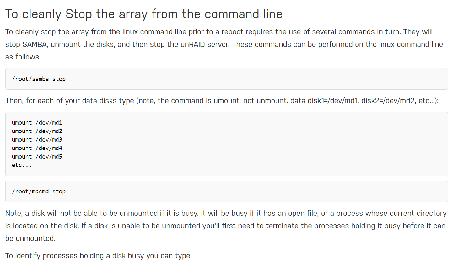

August 7, 20215 yr I have some rclone mounts that need refreshing every day. To do this, I have to manually stop and start the array. How can I do this using userscript and cron? From the wiki, it looks complicated as stopping array requires to run multiple commands. How can I just simulate the same steps done by the webgui button when we hit Stop.
August 7, 20215 yr Community Expert It IS complicated it is not something I have ever seen any user want to do under script control as a lot goes on behind the scenes during array stop/start. Is.there any reason you have to stop/start the whole array rather than just rclone and any associated mounts? That feels much easier to accomplish although even then I have no experience of the exact steps involved
