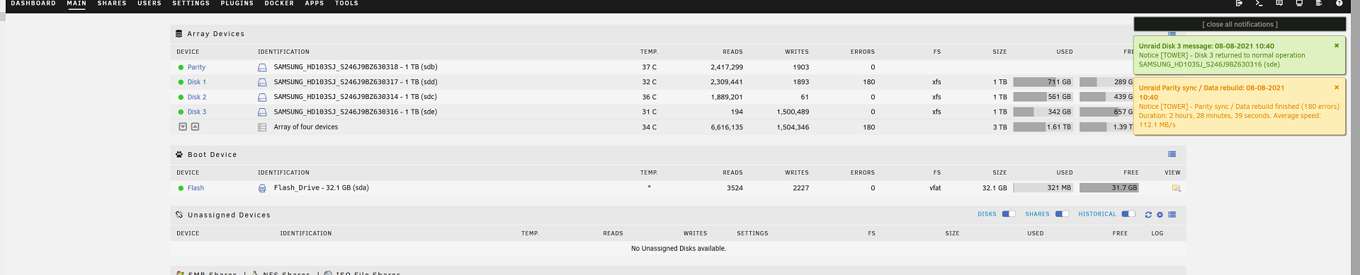

August 7, 20215 yr As a new user of Unraid, I was busy to build my server with all the data... finally it is finished for a couple of days and I am now about to make my first backup: - 1 parity disk (1Tb) - 3 Array HDDs (1Tb each) about 55% of space used by data No Cache drives or any pools Apps : Paperless ng, Calibri But now I have a fundamental problem: 2 of the data disks are suddenly unmountable only one disk remaining plus the parity disk So most of the data not accessible.... I have found some information in the Unraid Docs https://wiki.unraid.net/Manual/Troubleshooting#Unmountable_Disk.28s.29 However what to do, if not only one, but two disks become unmountable (2/3 of all data ) Any advice, what to do to recover the data ? Thank you Diagnostic file attached... tower-diagnostics-20210807-1443.zip

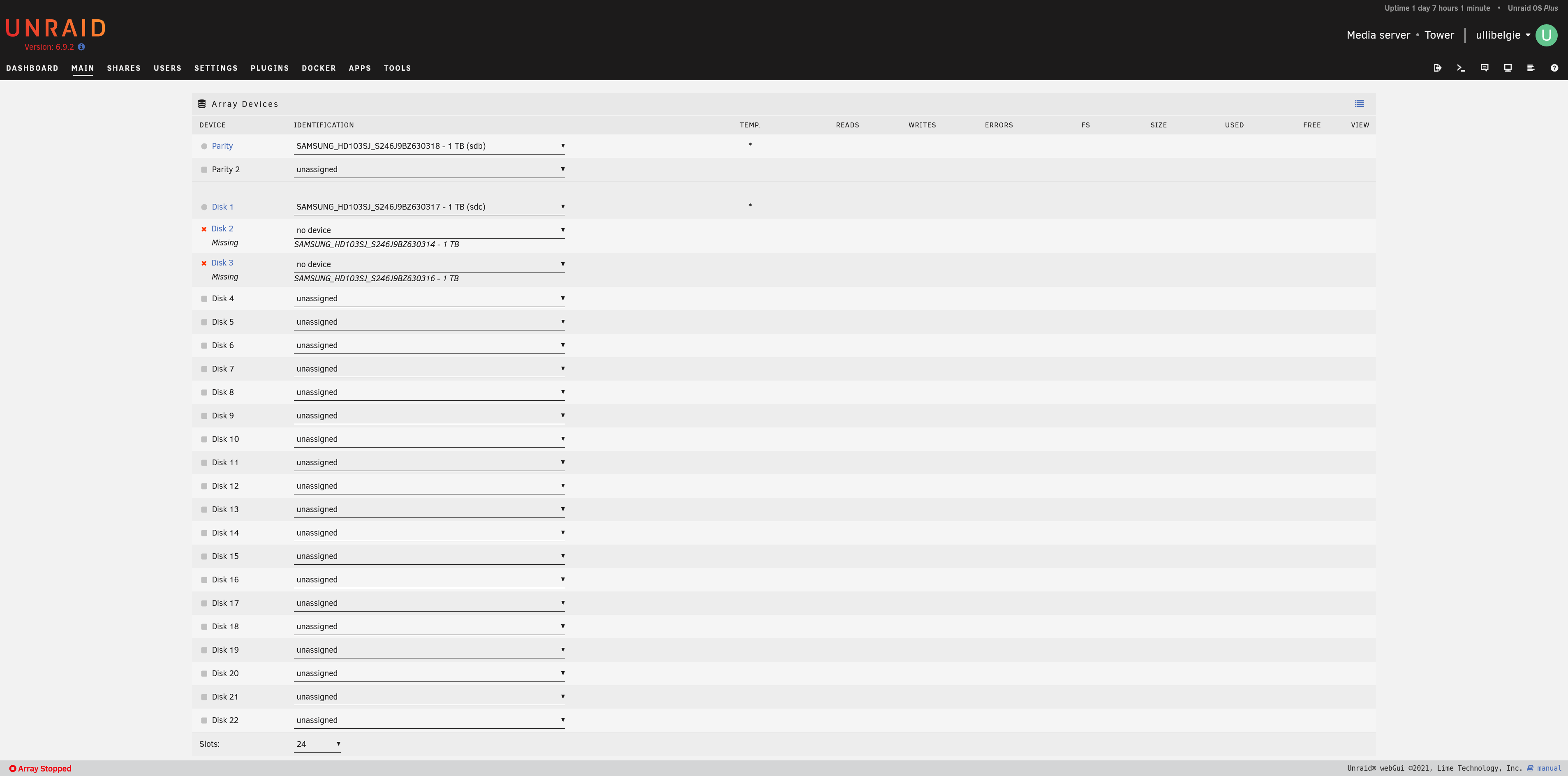

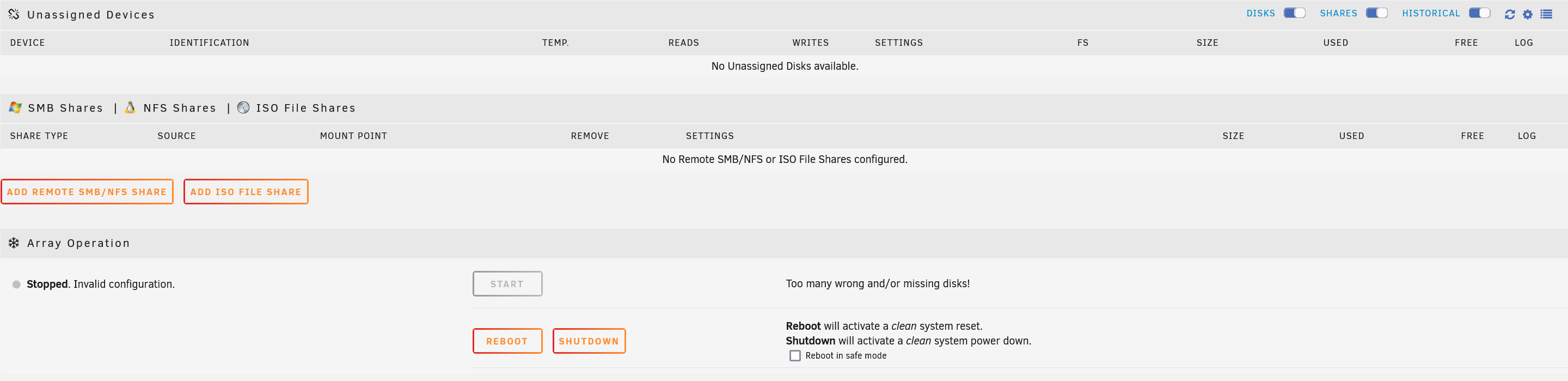

August 7, 20215 yr Author As I have 2 (out of 3) array disks failing, the array configuration is signed invalid and I cannot restart it in maintenance mode. According to the 'lost array configuration' advice in the Unraid wiki https://wiki.unraid.net/Manual/Troubleshooting#Lost_Array_Configuration the data should not be lost. I also have a flash drive back-up from some hours ago, with no re-assignment of disks Also I still have a parity disk, which is not disappeared... So because I still have the parity disk and the recent flash back-up, is there are more easy, but still save way for recover the both disks and rebuild the array configuration, so I can start it up (in maintenance mode to check file systems of the two disks) Screenshots of the array from UD main page attached. Thanks for help

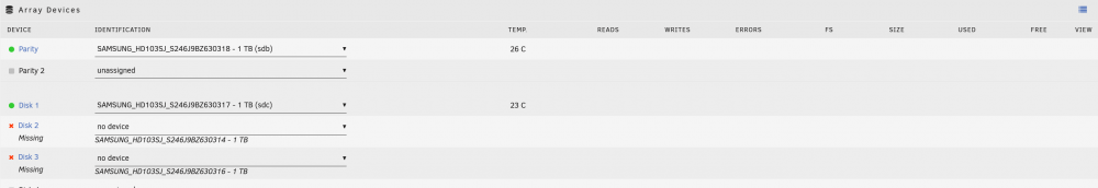

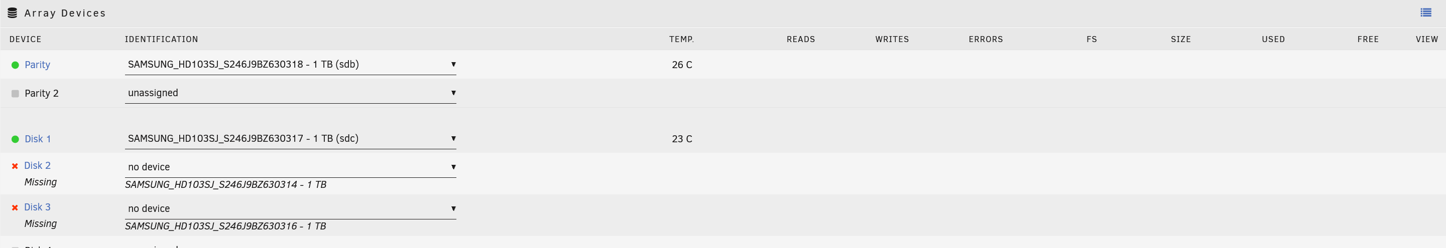

August 7, 20215 yr Author I rebooted the Unraid server - the failed disks do not even appear in Unassigned disks any more: However I can see them as missing in the array: Is there a realistic chance to recover the data on disk2 and disk 3 ? They could not be mounted earlier and now disappeared. What should be the next step ? Some sort of checkdisk outside of Unraid ?!
August 7, 20215 yr Community Expert There will be no chance of recovering 2 drives that have really failed with only a single parity drive. Have you tried power cycling the server to see if they can be seen then? If not there will not be much chance of recovering the contents on any system if the drive cannot even be seen.

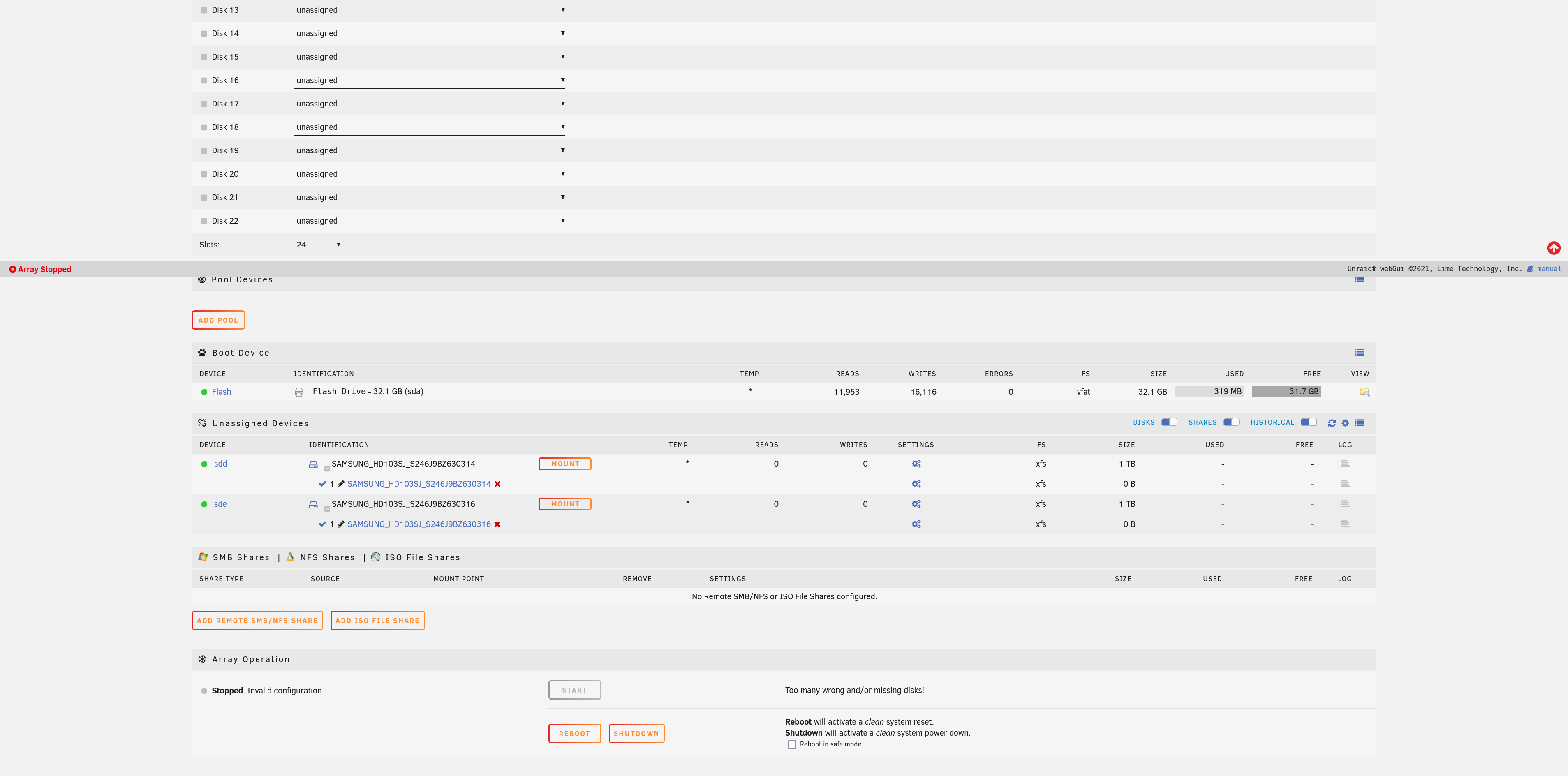

August 8, 20215 yr Author I found indeed for some reason the I/O settings in BIOS was set to AHCI disabled. I don't know, if this was set ealier to enabled or not, when installing Unraid. Additionally I found (with AHCI disabled mode) that when I changed the cables to use different SATA ports on the X7DVL-e Motherboard different HDD got disabled. But as I managed to get 2 (out of 3) data disks enabled plus one parity drive, I was able to repair the XFS file system with the steps explained in the unraid wiki (look in the manual under trouble shooting) After that I could also mount the remaining 3rd data disk Then the rebuild process started... It looks to me, that the rebuild process was successful (look at the screenshot below) However there were 180 errors of a different data disk! Are these new errors ? Or errors which occurred sometimes during the total life time of the HDD - even years ago, when I started to use it in my old windows machine. Total lifetime is now almost 1600h Better to exchange the disk 1 ? As my parity disk is also only 1Tb... better to buy a bigger parity drive also for the future possible expansion... Many thanks for the people who helped me with this problem.
