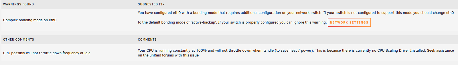

I also have a warning: The server have 2 networks cards (standard) but I guess I need to do some config?
The fans are running high, but I guess theres nothing that can be done. This is a very old Dell T610 PC I bought on Ebay to be used as a server.  I can't see any cpu temperatures on the unRaid dasboard, only disk temps.
I also runned extended test:
The following files exist within the same folder on more than one disk.  This duplicated file means that only the version on the lowest numbered disk will be readable, and the others are only going to confuse unRaid and take up excess space:
/mnt/user/system/docker/docker.img   disk4 disk5
The following files / folders may not be accessible to the users allowed via each Share's SMB settings.  This is often caused by wrong permissions being used on new downloads / copies by CouchPotato, Sonarr, and the like:
/mnt/user/.Trash-99  nobody/users (99/100)  0700
Any easy fix for this?  I am no server expert.
