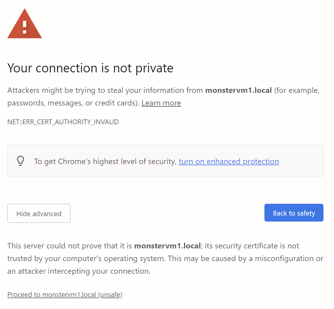

When you first access the site in Chrome you'll see a message like this:

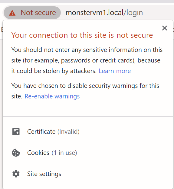

Click "proceed" and then in the URL bar you will see "Not secure". Clicking that shows:
This is all normal and how it is supposed to work.
