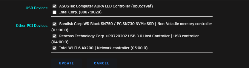

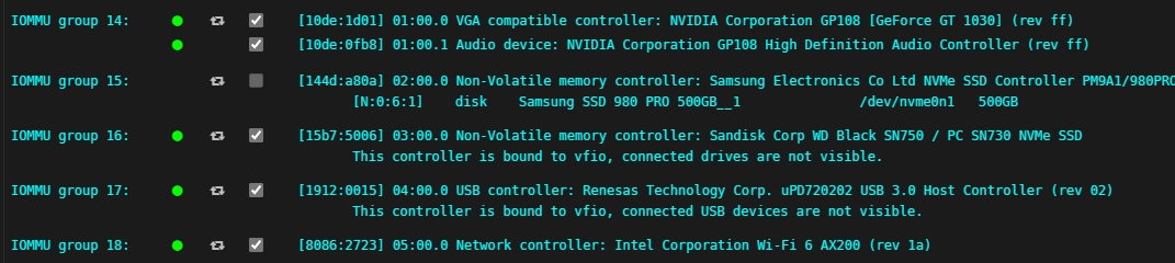

August 10, 20215 yr i have used this VM for a long time headless with only an SSD passthrough this has worked as a charm, recently i added a gpu and a usb controller, but i cant get them to work. it is a very strange issues and i get different results everytime i boot the machine. sometimes i get a very distorted unreadable screen on my connected monitor. sometimes the GPU seems fine but then it appears it can't find the SSD to boot. and i have gotten it to work for about 2 seconds with SSD and GPU but it froze on the login screen of windows. the logs give this error. 2021-08-10T14:21:02.337897Z qemu-system-x86_64: vfio_err_notifier_handler(0000:03:00.0) Unrecoverable error detected. Please collect any data possible and then kill the guest
